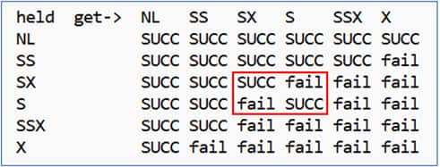

There are various lock-modes that can be acquired on an enqueue: Null, SS, SX, S, SSX, and X. When a session holds “held” (see below), an attempt to get “get” by another session does the following:
Lock compatibility rules
Note the special (symmetric) behavior of the SX and S modes: for both, an enqueue can be held in that mode by multiple sessions at the same time. But once an enqueue is held in SX-mode by any session, then no other session can get that enqueue in S-mode, and vice-versa.
