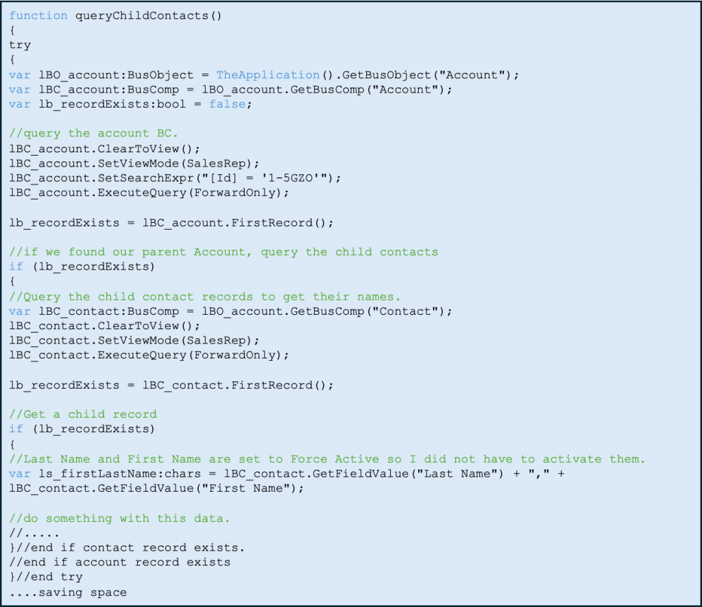

Here’s a simple and commonly encountered script scenario. This script queries the parent Business Component (for example, Account). If it finds a record, it then queries the child Business Component (for example, Contact) to retrieve the child data.
Sample script pattern (what the code does)
• Query the Account by Row Id.
• If a record is found, navigate to the child Contact BC.
• Read the Contact “Last Name, First Name” field and return it (for example, as ContactName).
Script for parent-child queries

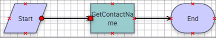

Workflow equivalent (no custom script)

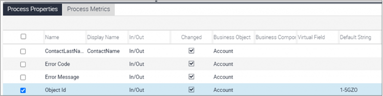

• Input/context: Set Object Id to the Account Row Id so the workflow automatically queries the Account BC on start; the child Contact BC is then in context.

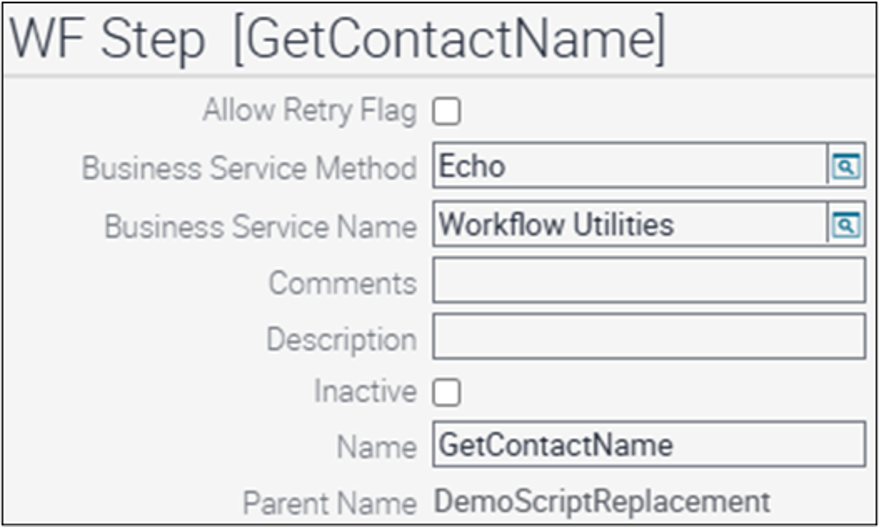

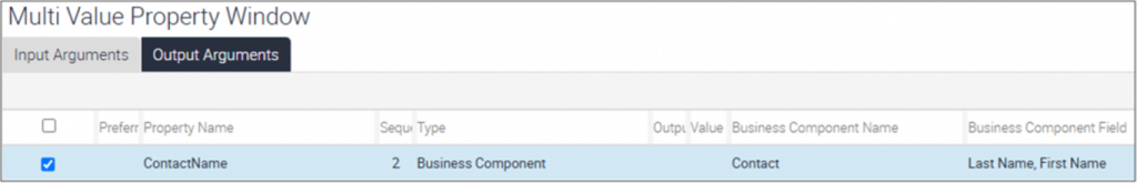

• Retrieval step: Add a step (e.g., GetContactName) that calls Workflow Utilities: Echo and defines an output argument ContactName mapped to the Contact BC field “Last Name, First Name”.
• Result: The workflow returns ContactName for downstream steps or integrations, replacing the scripted pattern with configuration.
Workflow showing account query and Contact field mapping

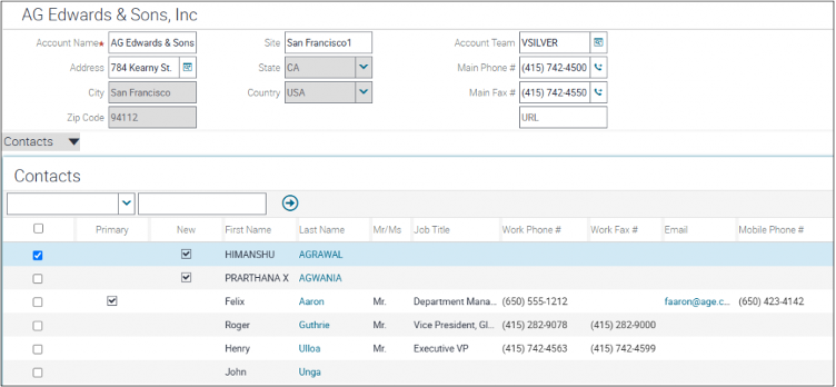

When the workflow queries the Account BC by Row Id, Siebel also brings the child Contact BC into context. This enables direct access to Contact fields in later steps without a separate scripted query.
Set Object Id to the Account Row Id to establish Account context.
Setting the object ID to query the account.
Here’s the account that corresponds to that Row Id and it’s child Contact records.
Child contact records list
Step 2: Retrieve the Contact “Last Name, First Name” via output arguments
Add a step (for example, GetContactName) that calls the Workflow Utilities Business Service using the Echo method. Map an output argument (ContactName) to the Contact BC field “Last Name, First Name” to return the display name of the first Contact in context.
Workflow step - Get contact name
You have to use the Output Arguments to get the data. The value is retrieved from the Last Name, First Name Field of the Contact Business Component.

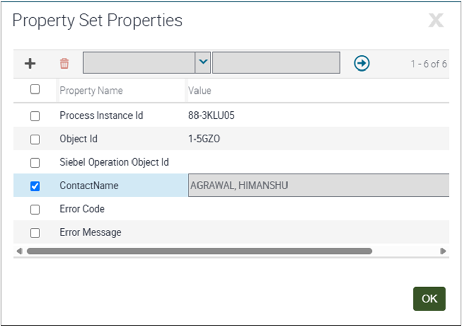

Step 4: Validate the configuration in the Business Service Simulator
Run the process (or the Business Service step) in the Business Service Simulator with a known Account Row Id. Confirm the ContactName output matches the first Contact for that Account, verifying the child BC context and field mapping are correct.
Property set properties for the contact
