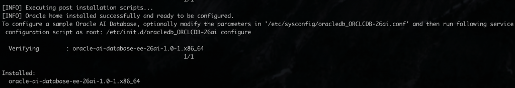

- The installation of this RPM will complete by showing some INFO messages relevant for the following Oracle Database creation:
