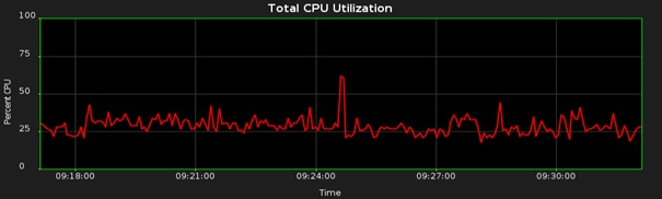

Consider the following trace of CPU consumption over time:
It shows my CPU utilization while the automatic statistics gathering job is running and there’s not much else happening on the system. Notice that about 75% of the CPU is not utilized. This fact is easy to understand once you know that the environment has a 4-core CPU with one thread per core. By default, statistics gathering uses a single process (with a single worker-thread) and this will utilize the processing power of a single CPU core. In my case, this equates to a utilization of 25% (one quarter of the 4-core chip). For systems with a higher core count, the single process will utilize an even smaller proportion of the available CPU.

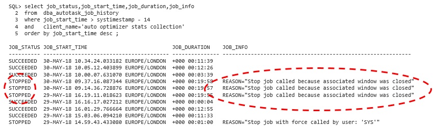

Fortunately, this situation is easy to see. If you view the statistics advisor report available in Oracle Database 12c Release 2, then it will tell you. The data dictionary stored this information too. In the example below, my batch window is 20 minutes long and the auto stats job has sometimes failed to complete (status STOPPED). The JOB_INFO column reveals the reason: auto statistics collection is occasionally taking longer than 20 minutes and terminates when the batch window closes.
How can we fix this? We could (a) make the batch window longer and/or (b) speed up statistics gathering. I am going to consider option b (because option a is less interesting).

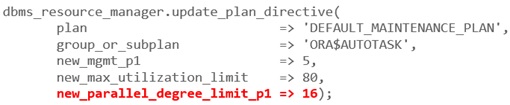

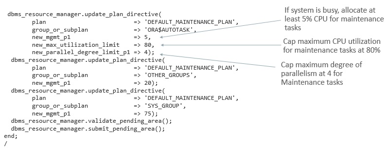

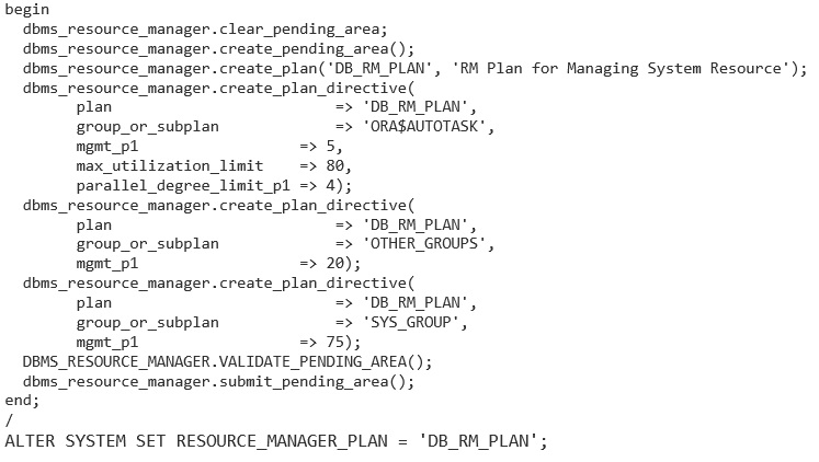

With parallel execution in play, statistics gathering has the potential to consume lots of system resource, so you need to consider how to control this. When the auto stats gathering job executes it (by default) uses the resource management plan DEFAULT_MAINTENANCE_PLAN and a consumer group called ORA$AUTOTASK. This makes it very easy to make some adjustments and control just how much resource you want to dedicate to gathering statistics.
You first need to decide what priority to attribute to auto stats gathering depending on what other processes are likely to be running at the same time. In the following example, the auto stats job has a minimum of 5% CPU if other tasks running in the database are competing for CPU. However, if the system is not busy, we will allow the job to consume up to 80% of the CPU (this will protect processes that must run outside the control of the database). The maximum degree of parallelism an individual session can use is four in this case. It is useful to control the maximum DOP because you will want to make sure that you do not reach the maximum number of parallel server processes allowed for the system (this will become more relevant later in this post).
For completeness, the example above includes all plan directives for the DEFAULT_MAINTENANCE_PLAN, but it is only necessary to specify the plan directives you want to modify. By default, when the maintenance windows opens, it will activate the DEFAULT_MAINTENANCE_PLAN. If you prefer, you can create your own resource management plan and associate it with any maintenance windows of your choosing. If you also set the resource_management_plan initialization parameter, then you can use the same resource management plan when the batch windows are both open and closed. Here’s an example:

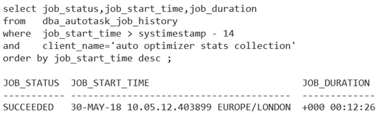

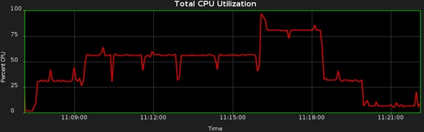

When AUTO_DEGREE is used the resource utilization can look very different . In this example, the tables are all identical so there’s a very regular pattern:
We are now using much more CPU, and consequently the job completes in only 12 minutes and 26 seconds (where, previously, it failed to complete within the 20-minute window):

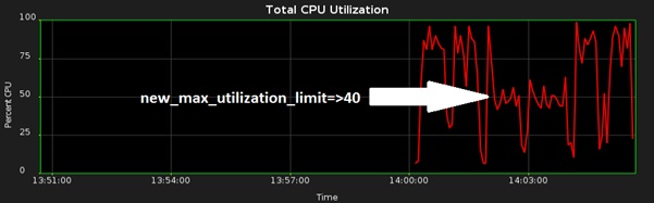

Remember that database resource management (DBRM) is in force during the batch window, so it is very easy to adjust CPU utilization even while the job is running. For example – consider what happens when I adjust the utilization limit down from 80% to 40% and then back again:

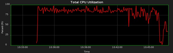

Let’s look at a more realistic AUTO_DEGREE scenario. In the following example we have a schema containing tables that have a wide variation in size. The CPU profile is now less consistent:
The DOP is changing in response to the size of each individual table. The job runs serially at first (about 25% CPU), then DOP 2 for a while, then DOP 3 and then back to serial. We could micro-manage DOP on a table-by-table basis, but it is much better to avoid approaches like this because we should always aim to avoid too much manual intervention. The global AUTO_DEGREE solution will be good enough in many cases, so there will be no need for any further manual intervention.

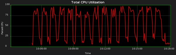

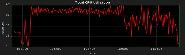

The database will now gather statistics using multiple scheduler jobs. In my case, auto stats initiated 16 job processes and the CPU profile looked like this:
I am using max_utilization_limit set to 80%, and the job completes in 11 minutes and 39 seconds:

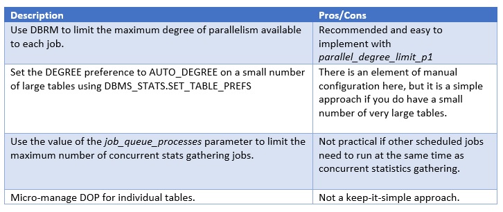

You can mitigate the risk of initiating too many parallel execution servers as follows:
There is currently no way to cap the number of job queue processes allocated to concurrent stats gathering, so ‘turning down’ the job_queue_processes setting is the only way to do this. I have created an enhancement request with respect to this limitation.

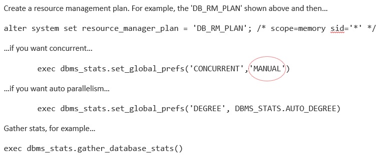

Manual Statistics Gathering
If you want to initiate stats gathering manually, and still make full use of parallel and concurrent settings, then you can use the following approach:

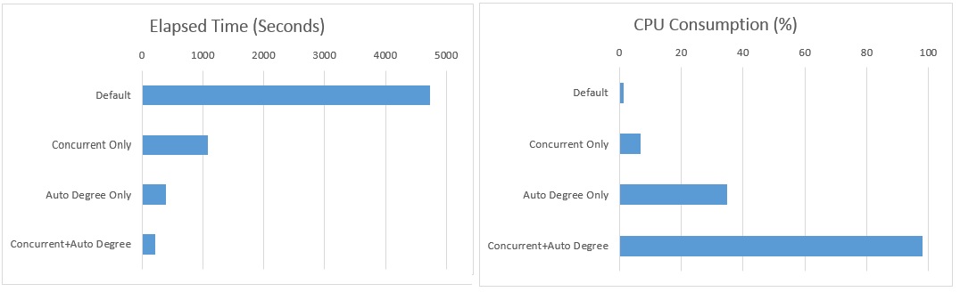

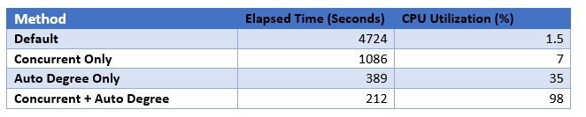

A small test system was used for the examples above, so it will be useful to see what an enterprise-class system looks like (let’s say 72 cores with HT). The Oracle Real World Performance Group ran some tests to check out the different techniques.
The relative performance of the stats gathering methods will be different on every system you try, so treat this as entertainment rather than science. For example, the test tables were all large and all the same size, so this will work in favor of AUTO_DEGREE (used without CONCURRENT) because a high degree of parallism was used for every table.
A large number of CPU cores will make the default method look exceptionally underpowered. In this case the CPU is only 1.5% utilized; a single core in an enterprise-class system:
Here are the results plotted:

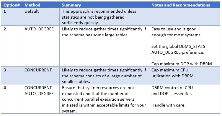

Summary
Remember that you will need spare machine capacity to gain benefit from the techniques outlined in this blog post.
Generally speaking, option #2 is most likely to give you a quick and easy win if there are a number of very large tables. Option #3 is great if you have plenty of spare machine resource and a large number of smaller tables.
Option #4 requires more care to avoid initiating too many parallel execution servers.
Options #3 and #4 are particularly useful if you need to get a one-off stats gathering task done very quickly: perhaps when you are commissioning a new deployment or gathering statistics after an upgrade.
Here’s a high-level summary:
