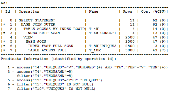

Consider query A, which has an outer-joined view V. The view cannot be merged, as it contains two tables, and the join between these two tables must be performed before the join between the view and the outer table T4.
A:
SELECT T4.unique1, V.unique3
FROM T_4K T4,
(SELECT T10.unique3, T10.hundred, T10.ten
FROM T_5K T5, T_10K T10
WHERE T5.unique3 = T10.unique3) V
WHERE T4.unique3 = V.hundred(+)
AND T4.ten = V.ten(+)
AND T4.thousand = 5;
The following shows the non-default plan for query A generated by disabling join predicate pushdown.

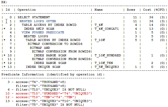

When query A undergoes join predicate pushdown, it yields query B. Note that query B is expressed in a non-standard SQL and shows an internal representation of the query.
B:
FROM T_4K T4,
ANDT4.unique3 = V.hundred(+)
AND T4.ten = V.ten(+)) V
WHERE T4.thousand = 5;
The execution plan for query B is shown below.
In the execution plan BX, note the keyword ‘VIEW PUSHED PREDICATE’ indicates that the view has undergone the join predicate pushdown transformation. The join predicates (shown here in red) have been moved into the view V; these join predicates open up index access paths thereby enabling index-based nested-loop join of the view. With join predicate pushdown, the cost of query A has come down from 62 to 32.
As mentioned earlier, the join predicate pushdown transformation is cost-based, and a join predicate pushed-down plan is selected only when it reduces the overall cost.

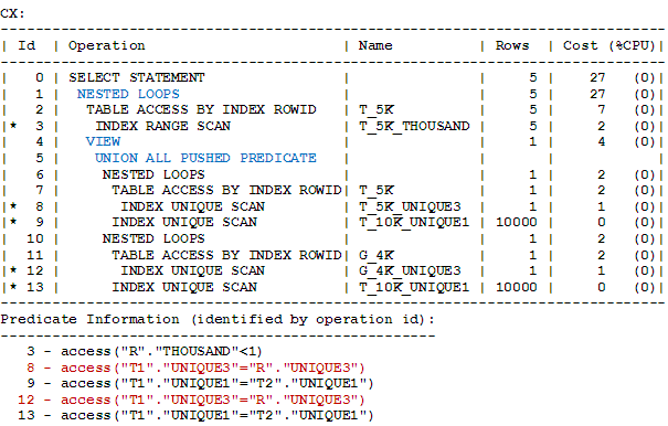

Consider another example of a query C, which contains a view with the UNION ALL set operator.
C:
SELECT R.unique1, V.unique3
FROM T_5K R,
(SELECT T1.unique3, T2.unique1+T1.unique1
FROM T_5K T1, T_10K T2
WHERE T1.unique1 = T2.unique1
UNION ALL
SELECT T1.unique3, T2.unique2
FROM G_4K T1, T_10K T2
WHERE T1.unique1 = T2.unique1) V
WHERE R.unique3 = V.unique3 and R.thousand < 1;
The execution plan of query C is shown below.
In the above, ‘VIEW UNION ALL PUSHED PREDICATE’ indicates that the UNION ALL view has undergone the join predicate pushdown transformation. As can be seen, here the join predicate has been replicated and pushed inside every branch of the UNION ALL view. The join predicates (shown here in red) open up index access paths thereby enabling index-based nested loop join of the view.

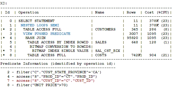

Consider query D as an example of join predicate pushdown into a distinct view. We have the following cardinalities of the tables involved in query D: Sales (1,016,271), Customers (50,000), and Costs (787,766).
D:
SELECT C.cust_last_name, C.cust_city
FROM customers C,
(SELECT DISTINCT S.cust_id
FROM sales S, costs CT
WHERE S.prod_id = CT.prod_id and CT.unit_price > 70) V
WHERE C.cust_state_province = ‘CA’ and C.cust_id = V.cust_id;
The execution plan of query D is shown below.
As shown in XD, when query D undergoes join predicate pushdown transformation, the expensive DISTINCT operator is removed and the join is converted into a semi-join; this is possible, since all the SELECT list items of the view participate in an equi-join with the outer tables. Under similar conditions, when a group-by view undergoes join predicate pushdown transformation, the expensive group-by operator can also be removed.
With the join predicate pushdown transformation, the elapsed time of query D came down from 63 seconds to 5 seconds.
