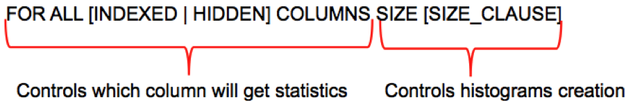

The METHOD_OPT parameter syntax is made up of multiple parts. The first two parts are mandatory and are broken down in the diagram below.
The leading part of the METHOD_OPT syntax controls which columns will have base column statistics (min, max, NDV, number of nulls, etc) gathered on them. The default, FOR ALL COLUMNS, will collects base column statistics for all of the columns (including hidden columns) in the table.  The alternative values limit the collection of base column statistics as follows;
FOR ALL INDEXED COLUMNS limits base column gathering to only those columns that are included in an index. This value is not recommended as it is highly unlikely that only index columns will be used in the select list, where clause predicates, and group by clause of all of the SQL statement executed in the environment.
FOR ALL HIDDEN COLUMNS limits base column statistics gathering to only the virtual columns that have been created on a table. This means none of the actual columns in the table will have any column statistics gathered on them. Again this value is not recommended for general statistics gathering purposes. It should only be used when statistics on the base table columns are accurate and a new virtual column(s) has been created (e.g. a new column group is created). Then gathering statistics in this mode will gather statistics on the new virtual columns without re-gathering statistics on the base columns.
Note that if a column is not included in the list to have statistics gathered on it, then only its average column length is gathered. The average column length is used to correctly compute average row length and discarded (i.e., not saved to disk) after use.

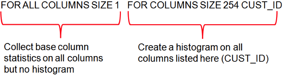

In an earlier blog post we showed an example of how to prevent Oracle from creating a histogram on a specific column, so let’s look at option 2, creating a histogram only on specific columns.  Let’s assume we only wanted to create a histogram on the CUST_ID of the SALES table. Remember, the METHOD_OPT parameter controls which columns get basic statistics as well as which columns get histograms, so we need to think about setting the METHOD_OPT parameter in two parts.
The first part will specify which columns will have base statistics gathered on them. In this case we wanted all of the columns in the table to have base statistics so we should use FOR ALL COLUMNS.  But what about the SIZE part of the parameter? We only want a histogram on one column, so for this leading edge of the parameter setting we need to specify SIZE 1 to prevent a histogram from being created on any column.
The second part of the parameter setting needs to specify that a histogram is needed on the CUST_ID column. This is achieved using an additional part of the METHOD_OPT syntax that we haven’t mentioned yet, called FOR COLUMNS. The FOR COLUMNS syntax allows us to provide explicit instructions for specific columns listed in this part of the parameter setting. In this case we would use, FOR COLUMNS SIZE 254 CUST_ID to specify we need a histogram on the CUST_ID column. So the final METHOD_OPT parameter setting will be;

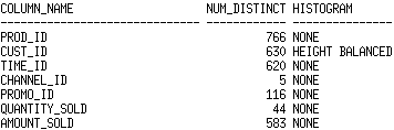

Below is the DBMS_STATS.GATHER_TABLE_STATS command in action. The only column that has a histogram created on it is the CUST_ID, even though several of the columns in the SALES table were used in the where clause of queries executed on the system.
BEGIN dbms_stats.Gather_table_stats('SH', 'SALES', - method_opt => 'FOR ALL COLUMNS SIZE 1 FOR COLUMNS SIZE 254 CUST_ID');
END;
PL/SQL procedure successfully completed.
SELECT column_name, num_distinct, histogram
FROM user_tab_col_statistics
WHERE table_name = 'SALES';

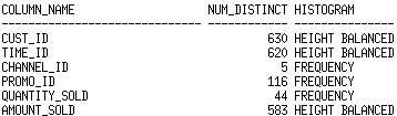

There are several other cases where you may need to provide a more complex setting for the METHOD_OPT parameter. Take for example a scenario where you don’t want any form of statistics on a column. There is no way to tell Oracle don’t gather statistics on a particular column, so you need to do the reverse and explicitly list the column you want to have statistics gathered on using the FOR COLUMNS syntax. Let’s assume we don’t want statistics of any kind on the PROD_ID column of the SALES TABLE. Then the DBMS_STATS.GATHER_TABLE_STATS command would be as follows;
BEGIN
dbms_stats.delete_column_stats('SH', 'SALES
', 'PROD_ID');
END;
PL/SQL procedure completed successfully.
BEGIN
dbms_stats.Gather_table_stats('SH', 'SALES',-
method_opt => 'FOR COLUMNS SIZE 254 CUST_ID TIME_ID CHANNEL_ID PROMO_ID
QUANTITY_SOLD AMOUNT_SOLD');
END;
— The average row length still got recorded accurately even though we did not gather statistics on the PROD_ID column.
SELECT num_rows, avg_row_len
FROM user_tables

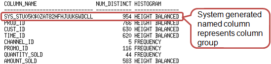

Finally, at the start of this post I mentioned that the METHOD_OPT parameter can also be used to create extended statistics. Extended statistics encompasses two additional types of column statistics; column groups and expression statistics. In the example below, a column group will be automatically created on the PROD_ID and CUST_ID column in the SALES table. It will be given a system-generated name and will have all of the base column statistics gathered on it.
BEGIN
method_opt => 'FOR ALL COLUMNS SIZE 254 FOR COLUMNS SIZE 254(PROD_ID, CUST_ID)');
END;
