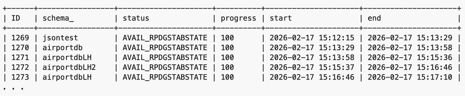

To see if your tables are loaded in HeatWave’s in-memory storage, you can query the performance_schema.rpd_table_id table (or related views). I like to use the following SQL command:
SELECT r.ID, i.SCHEMA_NAME as schema_, r.LOAD_STATUS as status, r.LOAD_PROGRESS as progress,
CAST(r.LOAD_START_TIMESTAMP AS DATETIME(0)) as start,
CAST(r.LOAD_END_TIMESTAMP AS DATETIME(0)) as end
FROM performance_schema.rpd_tables r
JOIN rpd_table_id i ON i.ID = r.ID
ORDER BY r.LOAD_PROGRESS DESC, r.LOAD_START_TIMESTAMP ASC;
Here is a sample of the output format:
Note: I only used CAST in the above query to remove the microseconds. This is optional.
This query will return details about each table associated with HeatWave:
- id: The database schema id
- schema: The database schema
- status: the status of the load (see below)
- progress: Loading percentage
- start: When the load began
- end: When the load ended
