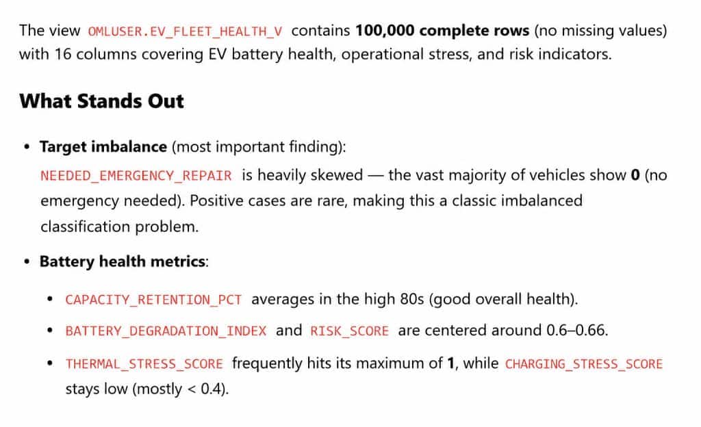

Discover and profile the data
We begin by asking the agent what fleet data is available. It identifies the view, examines the columns, and profiles completeness and distributions.
What fleet battery health data is available? Summarize the data. What stands out?
The agent profiles the view and flags that emergency repairs are rare in the dataset. A follow-up, “How common are emergency repairs?”, confirms that positive cases make up roughly 6% of records, which makes this an imbalanced classification problem. Identifying the class imbalance early allows us to account for it when building and evaluating the model.

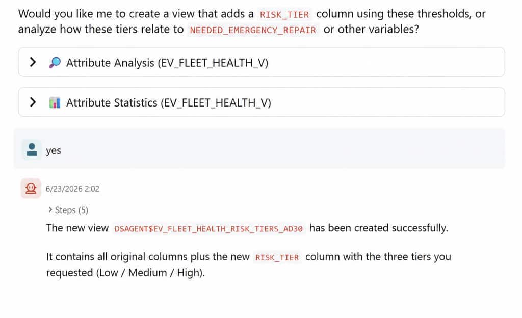

Engineer features in natural language

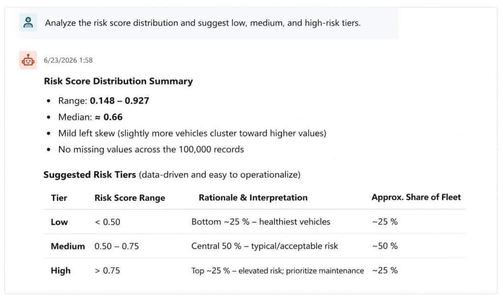

Raw sensor data does not match how fleet managers think about risk. They think in terms of low, medium, and high, not a continuous score between 0.148 and 0.927. We ask the agent to translate:
Analyze the risk score distribution and suggest low, medium, and high-risk tiers.
The agent analyzes the distribution of RISK_SCORE, proposes cutoffs at 0.50 and 0.75 that align with the quartiles, and explains the rationale. In this synthetic walkthrough, RISK_SCORE is treated as an upstream fleet signal available at scoring time; it should not be derived from the emergency-repair outcome or use future information. After confirmation, the agent creates a new view with a RISK_TIER column. RISK_TIER is an interpretable business segmentation, created to make the continuous risk score easier to interpret and compare across groups. It is not included as a feature in the predictive model built later in the walkthrough.

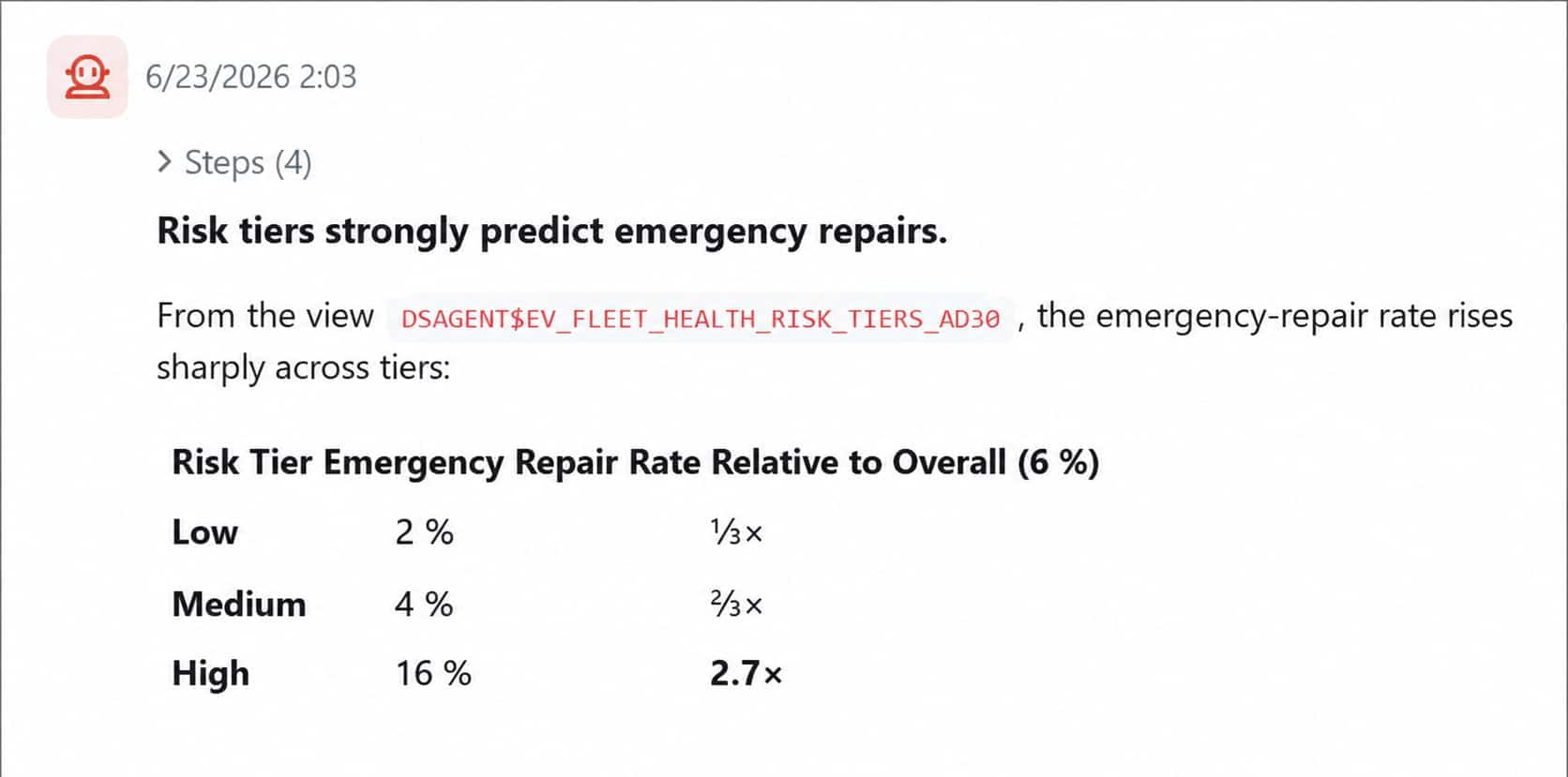

Before building a model, we check whether the engineered feature is meaningful:
Check how the tiers separate repair outcomes.
The emergency-repair rate increases from 2% in the Low tier to 16% in High, indicating a strong association between the score-based tiers and repair outcomes. That separation indicates that the risk tiers meaningfully distinguish vehicles with different repair needs, suggesting that the tiers can help distinguish groups with different emergency-repair rates even before a predictive model is built.

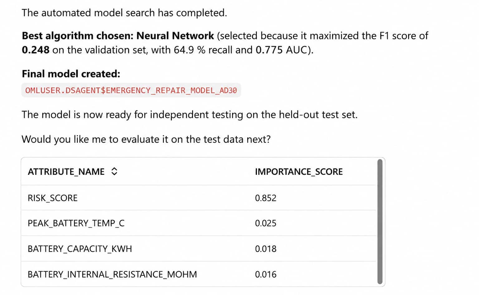

To predict emergency repairs at the individual vehicle level, we ask the agent to compare candidate algorithms and identify the best-performing model for our evaluation objective.
Find a good model that predicts emergency repairs.
The agent recommends Automated Model Search, which ranks features by importance, then tests multiple in-database classification algorithms on validation data and keeps the model selected by the configured evaluation metric.
The search selects a Neural Network and reports its validation metrics along with a feature-importance table, which shows RISK_SCORE as the main predictor, followed by battery temperature and capacity signals.
Because RISK_SCORE is already a strong upstream signal, its dominance in the feature-importance results warrants comparison against a RISK_SCORE-only baseline before attributing incremental predictive value to the Neural Network. A numeric RISK_SCORE-only AUC was not available from the existing evaluation objects, so this walkthrough does not claim that the Neural Network provides incremental predictive value over RISK_SCORE alone.
Automated Model Search selects the candidate using the configured evaluation metric, in this case F1, and then the workflow examines recall and AUC to understand its suitability for the maintenance objective.
for the configured evaluation metric, and it reports validation metrics and feature importance.

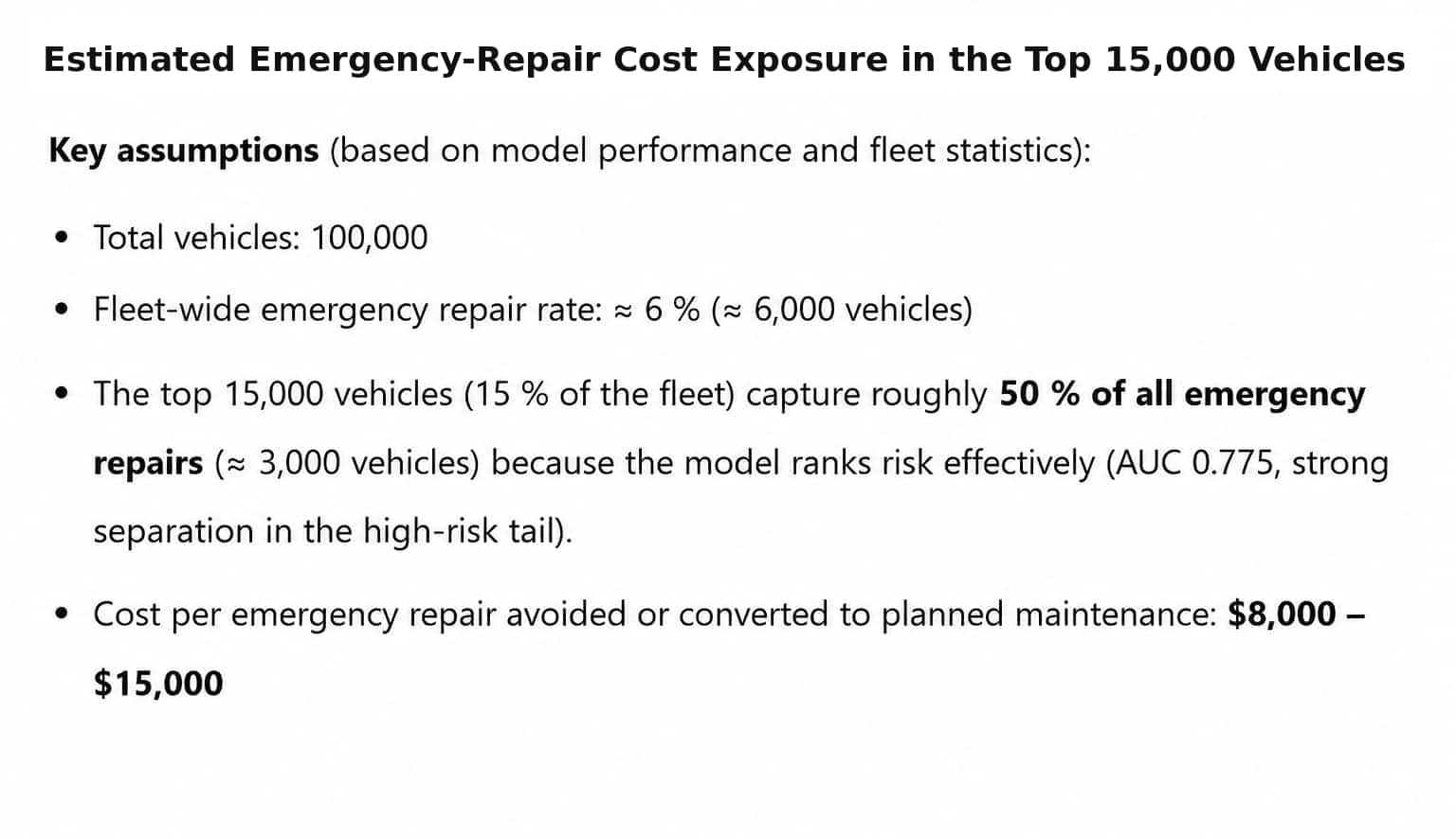

Illustrate potential cost exposure

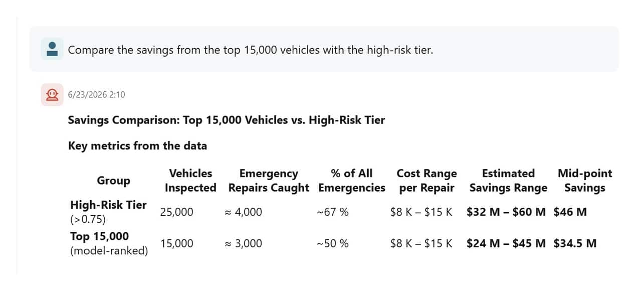

Quantifying the ranked list’s potential savings makes it more useful for budget planning. Because the agent retains the context of the session, you can ask business questions about the work already completed:
Assume each emergency repair costs $8,000-$15,000. What gross emergency-repair cost exposure is represented by the top 15,000 ranked vehicles?
For illustration, assume the top-ranked 15,000 vehicles capture approximately 3,000 of the fleet’s expected emergency repairs. At an assumed emergency-repair cost of $8,000-$15,000, those cases represent $24-$45 million in illustrative gross cost exposure. Actual net savings would depend on inspection costs, planned-maintenance costs, and the percentage of emergencies prevented or mitigated. The analysis does not estimate the percentage of emergency repairs that inspection would prevent or mitigate and therefore does not estimate actual savings. The dataset is synthetic, so this figure illustrates the method rather than benchmarking it.
Using the same illustrative assumptions, a follow-up comparison against inspecting the entire high-risk tier shows the trade-off: the model-ranked top 15,000 represents about 75% of the estimated cost exposure of the full high-risk tier while requiring inspection of 10,000 fewer vehicles – 40% fewer vehicles in this illustrative comparison. This illustrates how a ranked list could help a maintenance team allocate limited inspection capacity.

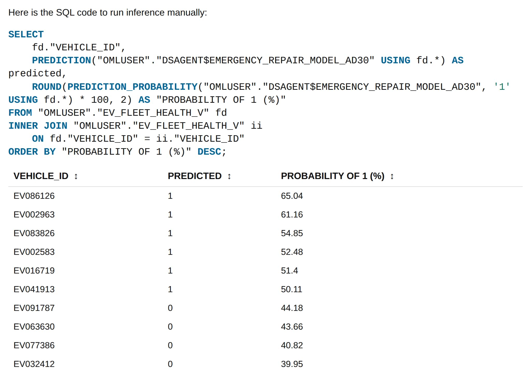

After evaluating the selected model on the test data and reviewing the ranking trade-offs with the maintenance team, we ask the agent for SQL that applies it:
Generate the SQL query to rank the entire vehicle fleet by predicted repair probability.
The agent returns in-database SQL code for scoring, using PREDICTION_PROBABILITY against the trained model. The query can now run on new data and be scheduled to run with DBMS_SCHEDULER or an Oracle Machine Learning notebook job.

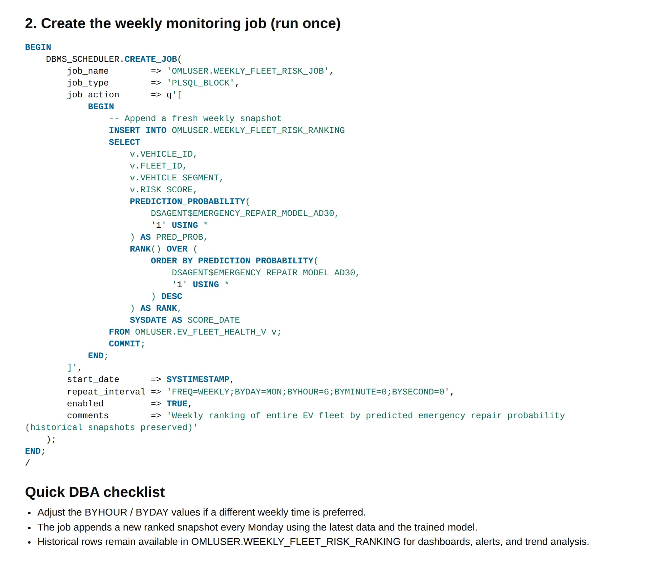

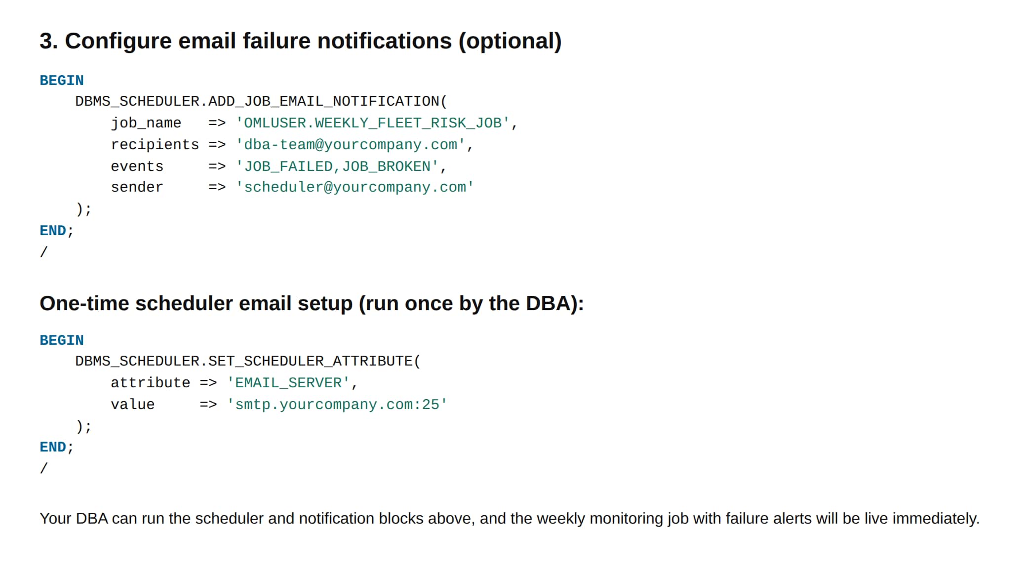

Once the model is producing useful rankings, there are a few ways to put it into production: a DBMS_SCHEDULER job that runs the query on a schedule, a scheduled Oracle Machine Learning (OML) Notebook job, or on-demand scoring through OML Services. We ask the agent to help set up the first of these:
How can my DBA use this query to set up a weekly fleet risk monitoring job?
The agent generates a persistent results table and code for a DBMS_SCHEDULER job that re-ranks the entire fleet weekly using the latest data. It also includes an optional failure notification, which a DBA can implement and review with DBMS_SCHEDULER.ADD_JOB_EMAIL_NOTIFICATION, and a short checklist for enabling the job. A developer or DBA should review and test the generated SQL before deploying it, then can integrate the results table into a custom dashboard or alerting system.
The scheduled job produces a ranked list rather than a finished service plan, so a maintenance planner should review the top-ranked vehicles before work orders go out. As new repair outcomes accumulate, teams can monitor model performance and retrain when enough new labeled data or evidence of model degradation warrants it.
