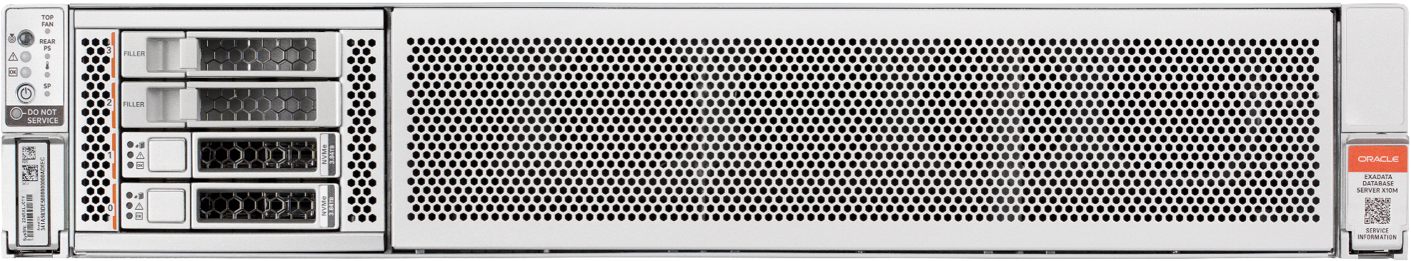

X10M_compute_node
A compute node consists of various components :
  •     Two or optionally four NVME Flash drives containing the operating system or Hypervisor and VMs, the Oracle binaries, etc.
  •     up to 3TB of RAM
  •     2 CPUs
  •     Host Channel Adapter which provides connectivity to the RDMA network fabric.
We will go through these highlighted components one by one to show you how Exadata makes a difference.
