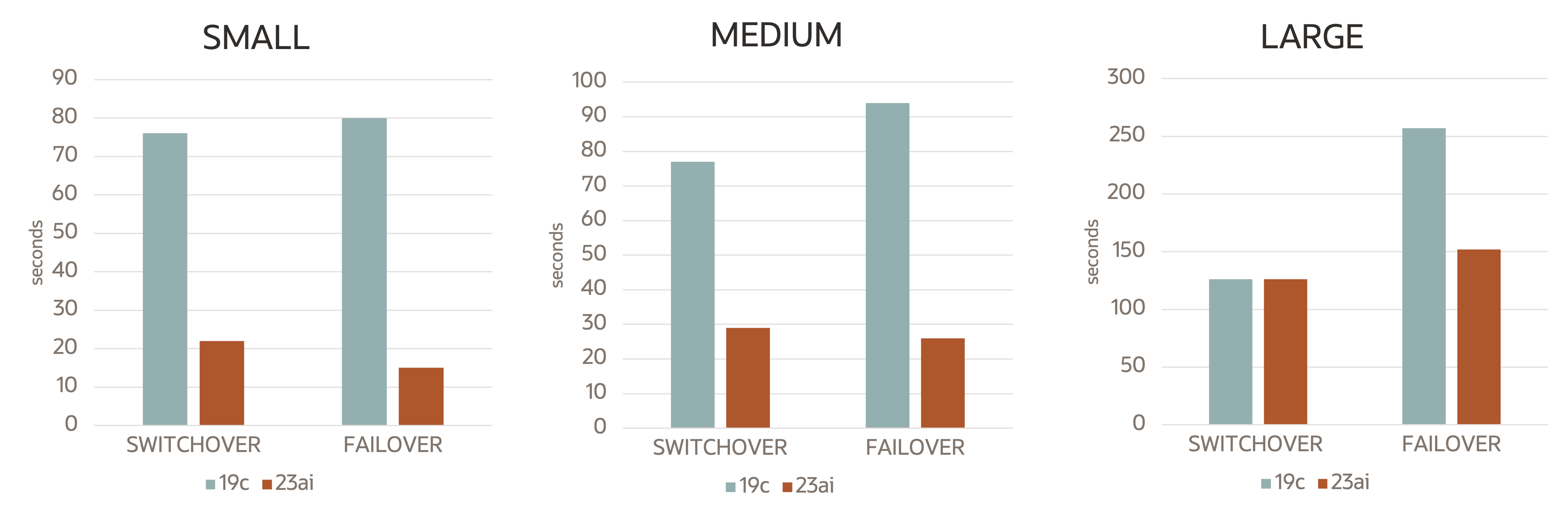

The following charts show how fast Oracle Data Guard 23ai role transitions are (23.8 was used) compared to Oracle Data Guard 19c (either 19.18 or 19.22 were used), according to our measurements (more details later in this article). We did that for different configurations using an increasing number of PDBs, data files, services, and RAC instances.
Three bar charts for three configurations: Small, Medium, and Large, show two data series with elapsed time for Failover and switchover, for 19c and 23ai.
That can range anywhere from similar timing to more than 4X faster.

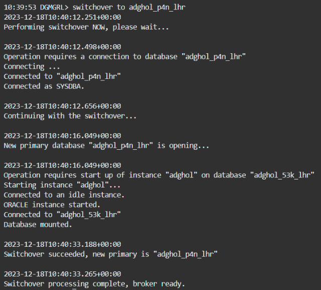

Switchover in 21 seconds in Oracle Database 23.3:
Output of a SWITCHOVER command run in DGMGRL with Oracle Database 23.3

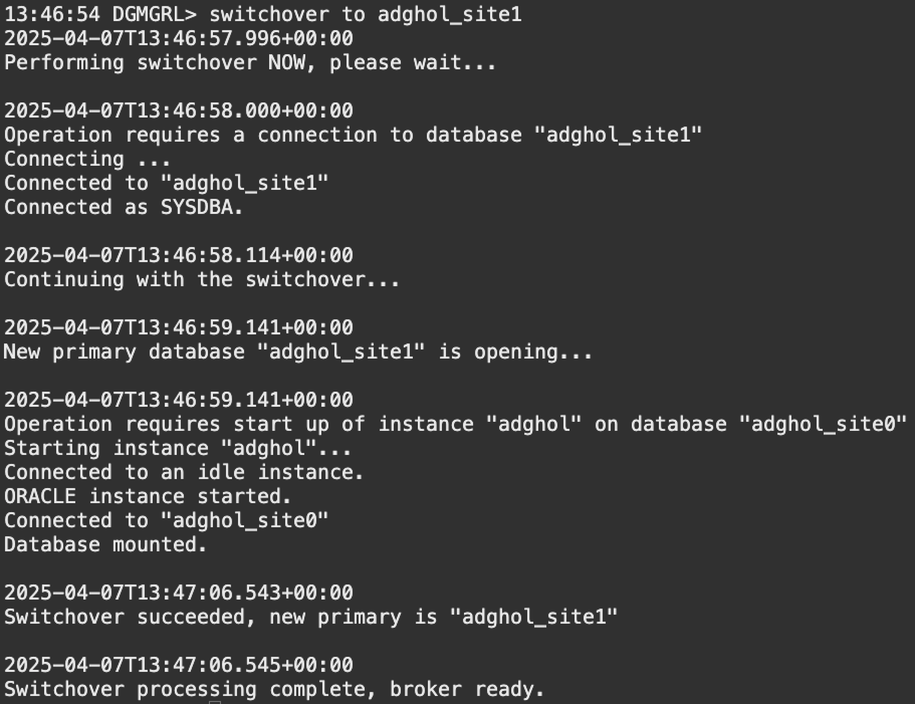

Switchover in less than 9 seconds in Oracle Database 23.7!
Output of a SWITCHOVER command run in DGMGRL with Oracle Database 23.7
