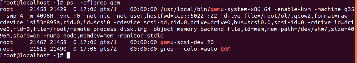

The result of running multi-process qemu with one remote process:
There are two processes listed here, one is the main qemu and the second is the qemu-scsi-dev remote process.
