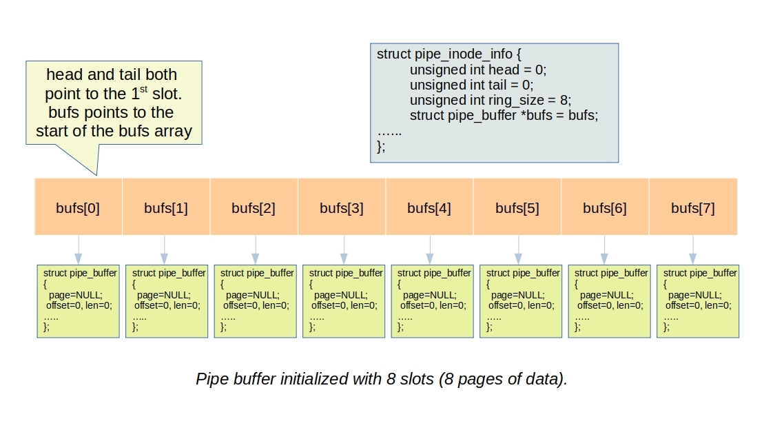

Now, let’s delve into the pipe_inode_info strucuture that describes a pipe. It includes the head and tail pointers, indicating the current positions within the pipe_buffer structure mentioned earlier. Additionally, it maintains an array of allocated pipe_buffer instances:
struct pipe_inode_info {
    unsigned int head;
    unsigned int tail;
    unsigned int ring_size;
    struct pipe_buffer *bufs;
pipe_initialize

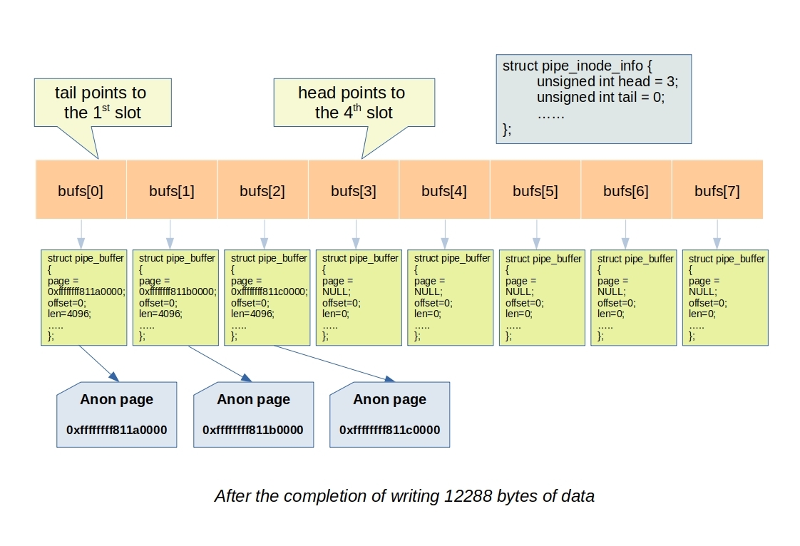

Pipe write
When a user writes to a pipe using the write system call, the Linux kernel internally invokes the pipe_write function located in fs/pipe.c file. Within the pipe_write function, the appropriate pipe_buffer pointed to by the head is selected. The function then allocates a page to store the data, advances the head pointer, and continues this process until it reaches the tail pointer or fulfills all the requested bytes to be written.
Pipe Write
Initially, it selects the current head pointer of the pipe. It also saves the information if the pipe was empty in a variable was_empty, which is used later when waking up a reader starving for data.
head = pipe->head;
was_empty = pipe_empty(head, pipe->tail);
The pipe_write function first allocates a page and then checks if the pipe is full using the pipe_full function. If the pipe is not full, it proceeds to advance the head pointer.
for (;;) {
    head = pipe->head;
    if (!pipe_full(head, pipe->tail, pipe->max_usage)) {
        unsigned int mask = pipe->ring_size - 1;
        struct pipe_buffer *buf = &pipe->bufs[head & mask];
        struct page *page = NULL;
        int copied;
        if (!page) {
            page = alloc_page(GFP_HIGHUSER | __GFP_ACCOUNT);
            if (unlikely(!page)) {
                ret = ret ? : -ENOMEM;
                break;
        /* Allocate a slot in the ring in advance and attach an
         * empty buffer.  If we fault or otherwise fail to use
         * it, either the reader will consume it or it'll still
         * be there for the next write.
        spin_lock_irq(&pipe->rd_wait.lock);
        head = pipe->head;
        if (pipe_full(head, pipe->tail, pipe->max_usage)) {
            spin_unlock_irq(&pipe->rd_wait.lock);
            continue;
        pipe->head = head + 1;
Afterwards, the allocated page is inserted into the buffer array at the slot determined by the head pointer. Subsequently, the user buffer is copied to the allocated page.
        /* Insert it into the buffer array */
        buf->page = page;
        buf->ops = &anon_pipe_buf_ops;
        buf->offset = 0;
        buf->len = 0;
        if (is_packetized(filp))
            buf->flags = PIPE_BUF_FLAG_PACKET;
        else
            buf->flags = PIPE_BUF_FLAG_CAN_MERGE;
        copied = copy_page_from_iter(page, 0, PAGE_SIZE, from);
        if (unlikely(copied < PAGE_SIZE && iov_iter_count(from))) {
            if (!ret)
                ret = -EFAULT;
            break;
        ret += copied;
        buf->offset = 0;
        buf->len = copied;
        if (!iov_iter_count(from))
            break;
The pipe_write function, using the above code excerpt, continues to write data to the next available slot in the buffer array by allocating a new page and writing to it. This process repeats as long as all the requested bytes have not been written. However, if there are no more free slots available in the buffer array but there is still more data to write, the function waits on an event. Additionally, if the pipe was empty before the write operation, indicating that there were no pending data for readers, the function wakes up a reader.
if (was_empty)
           wake_up_interruptible_sync_poll(&pipe->rd_wait, EPOLLIN | EPOLLRDNORM);
wait_event_interruptible_exclusive(pipe->wr_wait, pipe_writable(pipe));

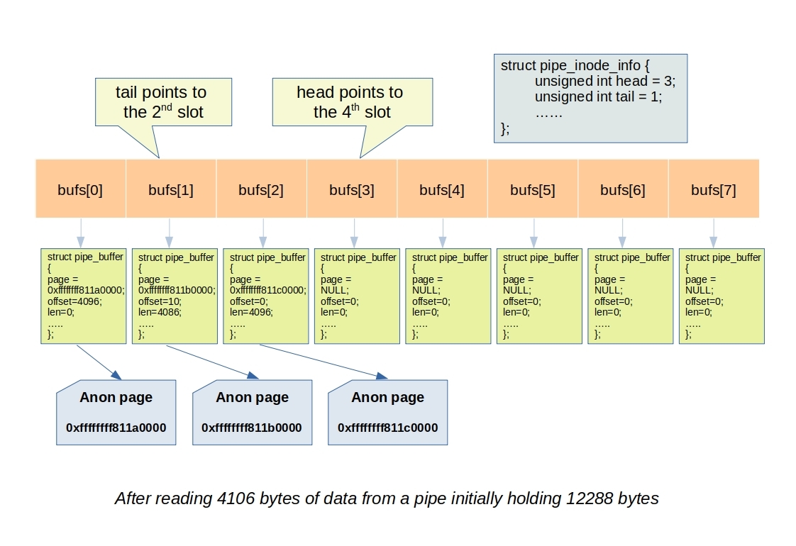

Pipe read
In the following discussion, we will explore the functioning of the read operation on a pipe.
Pipe Read
Reading from a pipe is achived through the read system call. Internally it invokes the pipe_read function.
At first, upon acquiring the pipe lock, the read operation first checks if the pipe is already full. It saves this information in a variable called was_full, which will be used later to wake up any writers waiting for the pipe buffer slot to become empty:
was_full = pipe_full(pipe->head, pipe->tail, pipe->max_usage);
Next, the read operation enters a loop to read the content of the file from the pipe. It continues the loop until either all the requested bytes are read from the pipe or if the pipe becomes empty, in which case it waits on an event to be awakened by a writer.
Inside the loop, the operation processes each pipe buffer pointed to by pipe->tail. It copies the content from the associated page of the pipe buffer to the user buffer and advances the pipe->tail pointer. It also checks if the pipe becomes empty by invoking the pipe_empty function. After the first iteration, one of the following three actions is taken:
  1. The loop continues to the next iteration to read from the next pipe buffer pointed to by pipe->tail.
  2. The loop is exited upon satisfying the requested length of bytes or if there is no writer available to fulfill the requested data.
  3. The read operation waits on the pipe->rd_wait event because the writer thread is expected to write some bytes to the pipe, which will wake up this thread for reading.
Here is the beginning of the loop, where the tail pointer is initialized from the pipe->tail:
for (;;) {
    /* Read ->head with a barrier vs post_one_notification() */
    unsigned int head = smp_load_acquire(&pipe->head);
    unsigned int tail = pipe->tail;
If the current pipe buffer is not empty, there is data to be copied to the user buffer. The buf->len member is reduced by the amount of data copied:
    if (!pipe_empty(head, tail)) {
        struct pipe_buffer *buf = &pipe->bufs[tail & mask];
        size_t chars = buf->len;
        size_t written;
        int error;
        error = pipe_buf_confirm(pipe, buf);
        if (error) {
            if (!ret)
                ret = error;
            break;
        written = copy_page_to_iter(buf->page, buf->offset, chars, to);
        if (unlikely(written < chars)) {
            if (!ret)
                ret = -EFAULT;
            break;
        ret += chars;
        buf->offset += chars;
        buf->len -= chars;
Afterwards, it checks if the current pipe buffer becomes empty (buf->len is zero). If so, it advances the pipe->tail to read from the next pipe buffer:
        if (!buf->len) {
            tail++;
            pipe->tail = tail;
        total_len -= chars;
When all the bytes requested is satisfied then bail out from the loop.
        if (!total_len)
            break;    /* common path: read succeeded */
If the pipe is not empty and all the requested bytes have not been satisfied, the loop continues:
        if (!pipe_empty(head, tail))    /* More to do? */
            continue;
The next few statements perform the following actions:
  1. If there is no writer and all the requested bytes have not been satisfied, it breaks out of the loop. It returns the amount of data that has been read (or 0 if no data has been read) from outside the loop.
  2. If ret contains the number of bytes read, it breaks out of the loop and returns the number of bytes read from outside the loop.
  3. If it is a non-blocking read request from the user and there is a writer thread, but not a single byte has been read, it returns EGAIN.
    if (!pipe->writers)
        break;
    if (ret)
        break;
    if (filp->f_flags & O_NONBLOCK) {
        ret = -EAGAIN;
        break;
The following code snippet is executed after the loop. Firstly, it checks if the pipe is empty, in which case it does not wake up any other readers. It uses the was_full variable, which was set right before the loop, to wake up any writer threads that were waiting for a pipe buffer slot to become empty. It then wakes up any other waiting readers. Lastly, it returns the number of bytes read.
if (pipe_empty(pipe->head, pipe->tail))
    wake_next_reader = false;
__pipe_unlock(pipe);
if (was_full)
    wake_up_interruptible_sync_poll(&pipe->wr_wait, EPOLLOUT | EPOLLWRNORM);
if (wake_next_reader)
kill_fasync(&pipe->fasync_writers, SIGIO, POLL_OUT);
if (ret > 0)
    file_accessed(filp);
return ret;

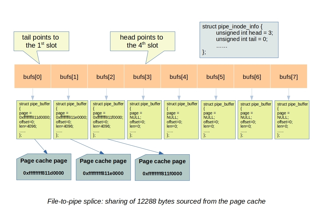

For instance, consider the following splice call, which reads from a file and makes the data available to be read from the pipe. In this example, data is read from the file descriptor fd and transferred to the file descriptor of the pipe referenced by p[1]. This operation is achieved without intermediate data copies, as the pipe buffer directly references the page containing the data from the page cache.
splice(fd, &offset, p[1], NULL, 1, 0);
Now, we are going to explore the internal mechanism of the splice system call. splice works in three modes –
  1. splice from pipe to pipe.
  2. splice from file to pipe.
  3. splice from pipe to file.
The splice system call operates similarly to pipe read or pipe write functions internally. It can either read from a pipe or write to a pipe, depending on the input data source and destination. When the input data source is a file or another pipe, and the destination is a pipe, it functions as a write operation to the pipe. In this mode, it advances the head pointer of the destination pipe to place the data buffer into a pipe buffer slot. However, instead of copying the data, it establishes a reference to the buffer from the source file or another pipe.
On the other hand, if the input data source for splice is a pipe and the destination is either a file or another pipe, it behaves like a read operation from the pipe. In this scenario, the tail pointer of the pipe is advanced, and rather than copying the data, the other pipe references the page from the current pipe buffer slot. This way, splice enables efficient data transfer between different data sources and destinations without unnecessary data duplication.

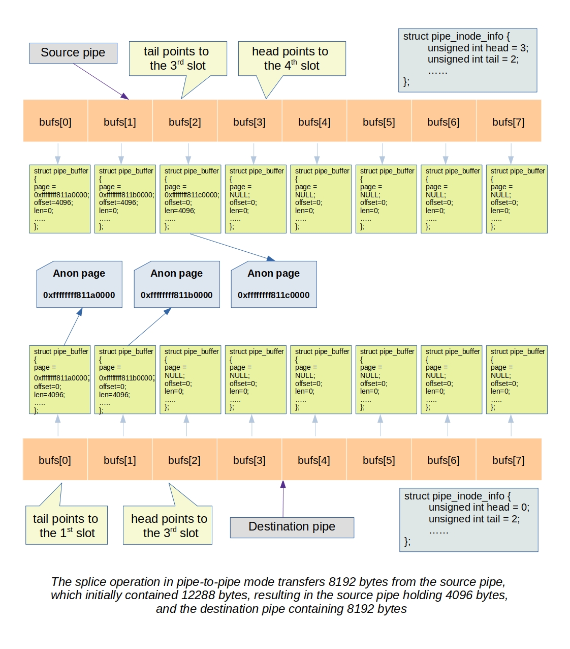

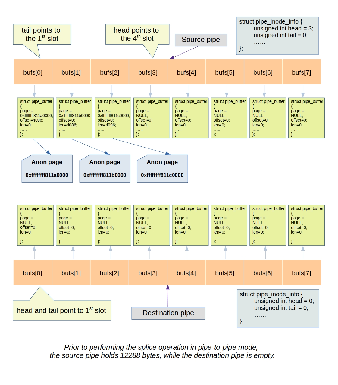

Splice from pipe to pipe
Splicing from one pipe to another is the simplest form of splice operation that efficiently moves data between two pipes without the need for data copying.
Below is a depiction of two images. The initial image represents the state before the splice operation, while the subsequent one portrays the state after the splice operation.
Slice Pipe-to-Pipe Before
Slice Pipe-to-Pipe After
To demonstrate this process, consider the following example where we create two pipes, p_in and p_out. We write data into p_in and then use the splice system call to transfer the data from p_in to p_out:
int p_in[2], p_out[2];
pipe(p_in);
pipe(p_out);
write(p_in[1], data, 8192);
splice(p_in[0], NULL, p_out[1], NULL, 8192, 0);
Let’s explore the process of the splice call responsible for moving data from one pipe to another. In this operation, the pointer to the page containing data from the input pipe’s buffer is directly transferred to the output pipe’s buffer. As a result, it advances the head pointer of the output pipe and the tail pointer of the input pipe, where the head pointer selects the pipe buffer slot for writing, and the tail pointer selects the pipe buffer slot for reading.

The data movement process between the pipes is as follows:
If the number of requested bytes to read is greater than the number of bytes the current input pipe buffer contains, a full page containing the data is moved from the input pipe buffer to the output pipe buffer. After the transfer, the tail pointer of the input pipe is advanced, indicating that the slot has been consumed and is now freed for the writers on this pipe to use.
On the other hand, if we are reading only a partial amount from an input pipe buffer (i.e., the requested number of bytes is less than the content length present in the buffer), the page containing the data is shared between the input and output pipe buffers. This sharing is achieved by calling the pipe_buf_get function. In this case, the input buffer pipe’s offset is increased, and its length is decreased by the number of bytes read. However, the tail pointer of the input pipe is not advanced in this situation, as the partial read does not completely consume the data in the buffer.
        if (len >= ibuf->len) {
             * Simply move the whole buffer from ipipe to opipe
            *obuf = *ibuf;
            ibuf->ops = NULL;
            i_tail++;
            ipipe->tail = i_tail;
            input_wakeup = true;
            o_len = obuf->len;
            o_head++;
            opipe->head = o_head;
        } else {
             * Get a reference to this pipe buffer,
             * so we can copy the contents over.
            if (!pipe_buf_get(ipipe, ibuf)) {
                if (ret == 0)
                    ret = -EFAULT;
                break;
            *obuf = *ibuf;
             * Don't inherit the gift and merge flags, we need to
             * prevent multiple steals of this page.
            obuf->flags &= ~PIPE_BUF_FLAG_GIFT;
            obuf->flags &= ~PIPE_BUF_FLAG_CAN_MERGE;
            obuf->len = len;
            ibuf->offset += len;
            ibuf->len -= len;
            o_len = len;
            o_head++;
Inside the loop, the number of read/write bytes is increased as data is successfully moved from the input pipe buffer to the output pipe buffer. Simultaneously, the length of the data in the respective pipe buffers is decreased accordingly.
        ret += o_len;

Splice from file to pipe
Splicing from a file to a pipe allows sharing the page cache data buffer with the pipe, avoiding data copying when reading from a pipe fed by a file. Unlike the typical scenario where we use the write system call on the pipe to feed data, in this case, data is sourced from a file.
Splice File to Pipe
The process of sharing the page cache starts from the splice_file_to_pipe function (fs/splice.c) and involves various filesystem and memory management functions to achieve page cache sharing. Initially, this function ensures that there is at least one slot available in the pipe buffer ring, allowing pipe buffer(s) to be allocated. After this preparation, it calls do_splice_to.
The do_splice_to function calculates the maximum number of bytes it can write from the requested length and calls the file pointer’s splice_read function.
return in->f_op->splice_read(in, ppos, pipe, len, flags);
For the ext4 filesystem, the splice_read function pointer points to the generic_file_splice_read function (fs/splice.c).
const struct file_operations ext4_file_operations = {

The function copy_page_to_iter_pipe is specifically used when transferring data between file data backed by the page cache and a pipe. It initially checks if the pipe is full; if so, there’s insufficient space to place the page cache page into the pipe, resulting in a simple return of 0.
However, if the pipe has an available slot, the function references the page and assigns buf->page (i.e. pipe buffer data page pointer) to the page cache page. In this case, the pipe buffer slot shares the data buffer with the page cache page, eliminating the need to allocate a new buffer and copy the entire content from the page cache. Finally, it advances the pipe’s head pointer.
struct pipe_inode_info *pipe = i->pipe;
struct pipe_buffer *buf;
unsigned int p_tail = pipe->tail;
unsigned int p_mask = pipe->ring_size - 1;
unsigned int i_head = i->head;
buf = &pipe->bufs[i_head & p_mask];
if (pipe_full(i_head, p_tail, pipe->max_usage))
    return 0;
buf->ops = &page_cache_pipe_buf_ops;
buf->flags = 0;
get_page(page);
buf->page = page;
buf->offset = offset;
buf->len = bytes;
pipe->head = i_head + 1;
i->iov_offset = offset + bytes;
i->head = i_head;
i->count -= bytes;
return bytes;
