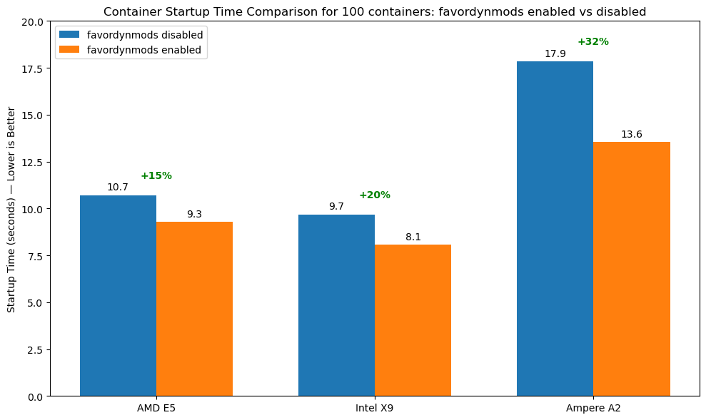

Impact of favordynmods
The following figure shows the comparison for the startup time of 100 containers with ‘favordynmods’ disabled and enabled. The graph clearly shows that enabling ‘favordynmods’ improves performance across all tested systems, i.e., 15% for AMD, 20% for Intel and 32% for Ampere instances.
