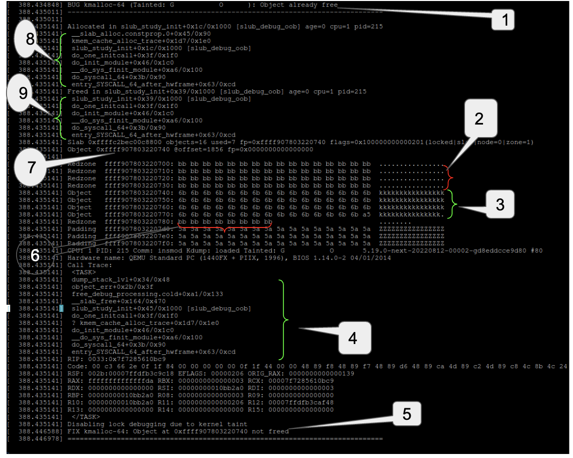

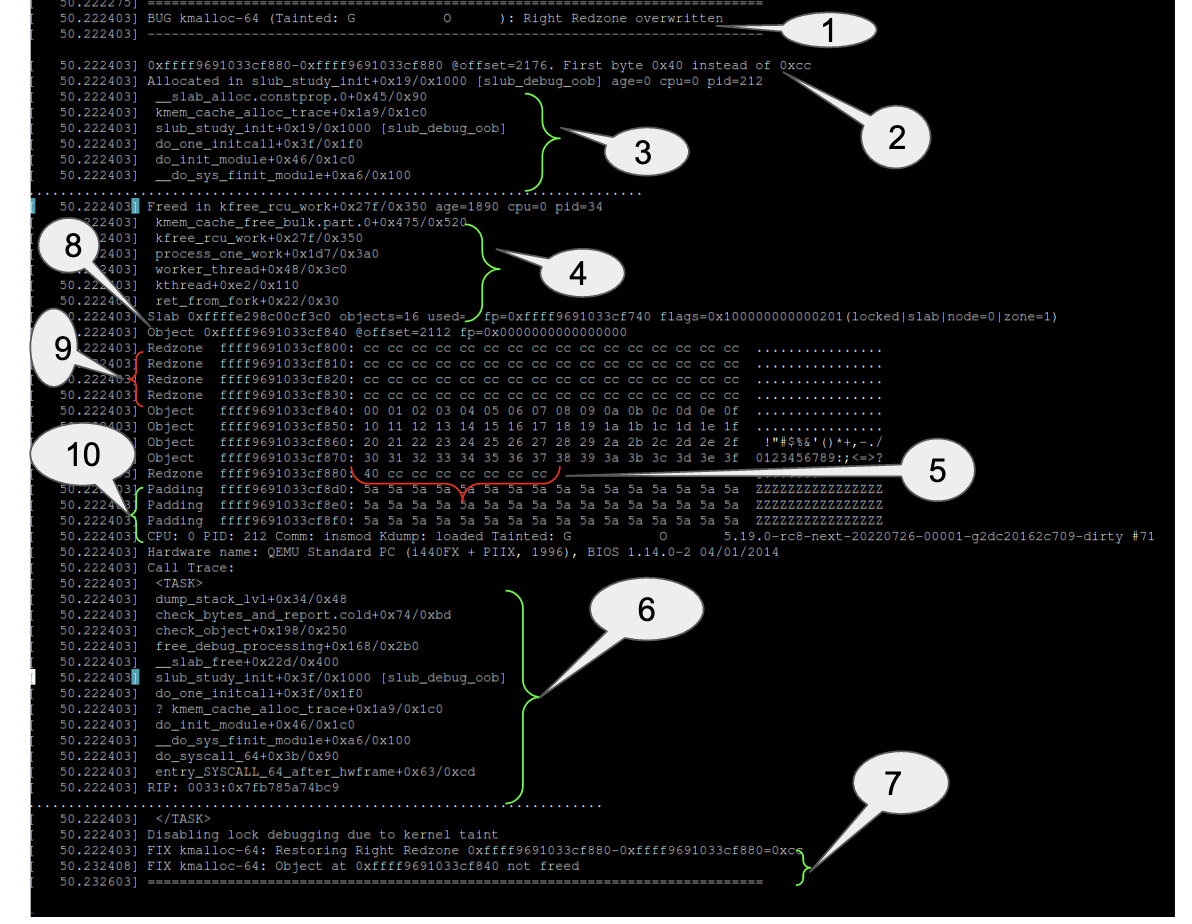

OOB Access
The slub debugger can detect out-of-bound (OOB) access at the time of freeing the object. At the time of freeing the object the RED zone bytes are checked. Ideally these bytes should have SLUB_RED_ACTIVE (0xcc) but if one or more of these bytes have some other value, it indicates an OOB access.
It must be noted that this OOB access is not reported at the time of occurrence but later on at the time of freeing the object. If the object is not freed then the error is not reported.
For example the following snippet shows a 1 byte OOB access for a kmalloc-64 object and this was detected at the time of freeing the object:
Fig 1: OOB access reported by slub debugger
  1. Redzone after the object was overwritten
  2. Slub debugger expected 0xcc (SLUB_RED_ACTIVE) but found 0x40 (overwritten value)
  3. Call stack for current allocation
  4. Call stack for current free
  5. Redzone (first byte) overwritten
  6. Slub debugger found OOB error at the time of freeing the object
  7. Corrective action taken by slub debugging subsystem
  8. Object for which OOB write happened
  9. Left Redzone of an active (not yet free) object
  10. Padding of an active object
At the end of this report we see that as a corrective action the Redzone was restored and the object was not freed at this point of time.

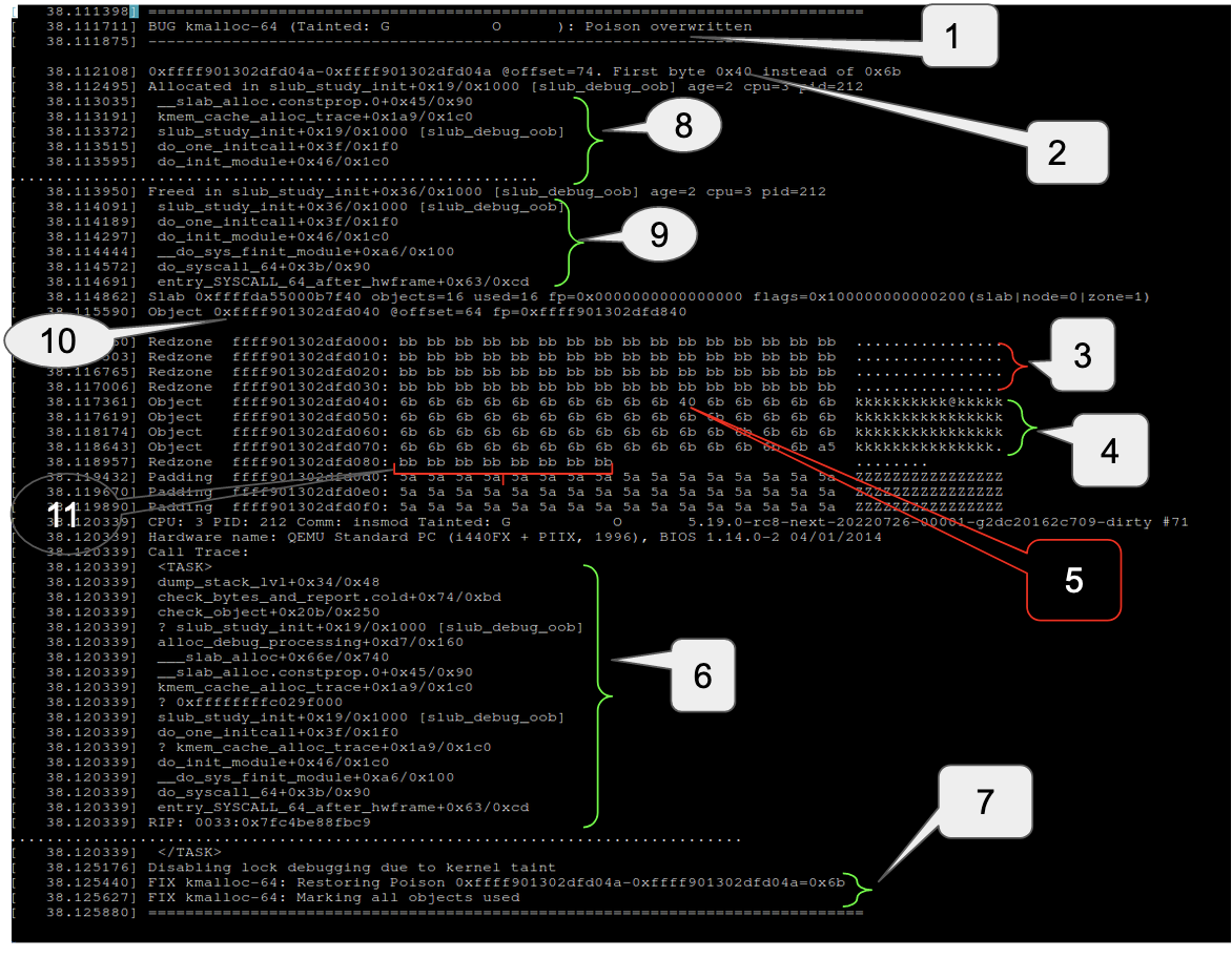

UAF Access
Slub debugger detects a use-after-free (UAF) error at the time of reallocation of the object. Just after being freed the object’s content area (except the last byte) is filled with POISON_FREE (0x6b) and the last byte of the object’s content area is filled with POISON_END (0xa5). If at the time of reallocation of the object, slub debugger sees that one or more bytes in the object’s payload area have some other value, it indicates a UAF error. In this case as well UAF is not detected right at the time of occurrence but later on at the time of reallocation of the object.
The following example shows that a kmalloc-64 object was used after being freed and 0x40 was written into it at offset 10.
Fig 2: UAF error reported by slub debugger
  1. Poison pattern in the object payload area was overwritten (UAF error)
  2. Slub debugger expected 0x6b or POISON_FREE (because the object had been freed) at this address but got 0x40
  3. Left redzone. 0xbb (SLUB_RED_INACTIVE) indicates a free object
  4. Object payload area. 0x6b (POISON_FREE) indicates a free object
  5. Object payload area. 0x6b (POISON_FREE) indicates a free object but at offset 10, 0x6b has been overwritten with 0x40 due to UAF error
  6. Slub debugger found UAF at the time of (re)allocating the object
  7. To avoid problems in future mark all objects of this slab as used. This will avoid touching any object
  8. Allocator call stack
  9. Freeing call stack
  10. Address of object
  11. Right redzone
