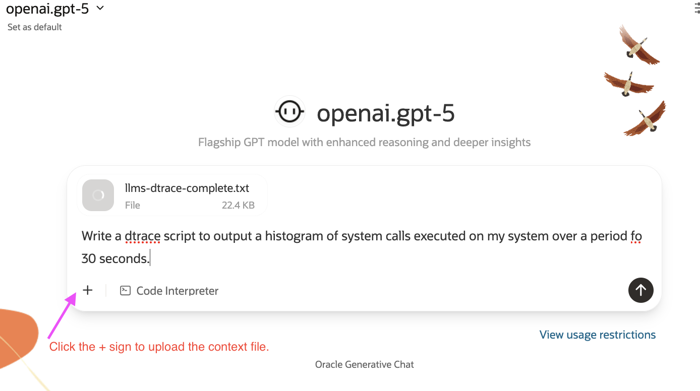

  1. Install dtrace. dnf install dtrace
  2. Download the dtrace llm file from github: https://github.com/oracle/dtrace-utils/blob/devel/llm/llms-dtrace-complete.txt

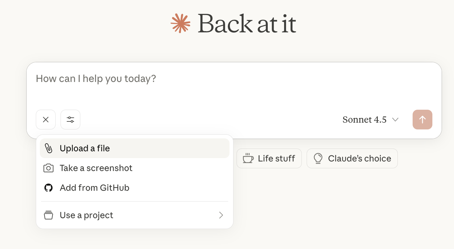

  3. Add it to your chat with the ‘+’ button.
That’s it, from there you can ask the language model to suggest dtrace scripts for simple and complicated test cases!
I’m using Oracle’s chat tool with gpt-4.1 for this but you can do it just as easily in Claude, OpenAI, or your favorite LLM-assisted coding interface.

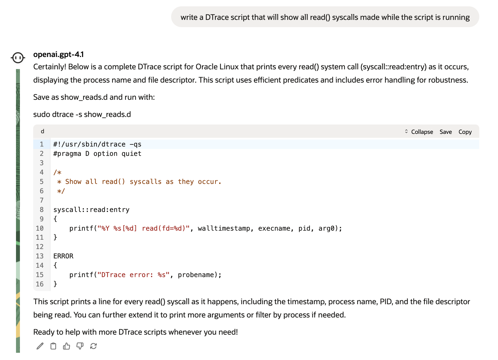

    Write a DTrace script that will show all read() syscalls made while the script is running

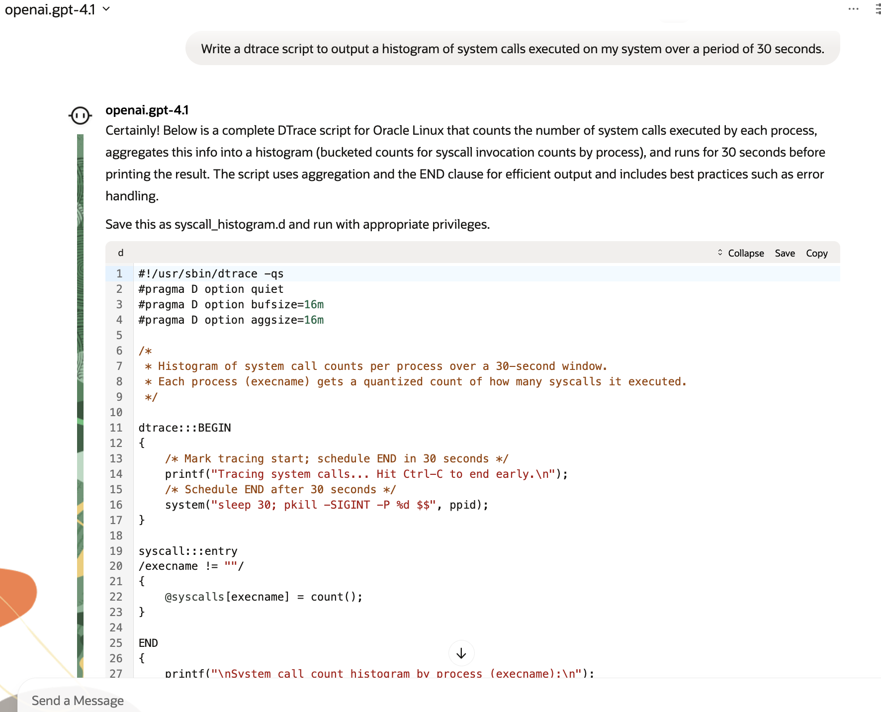

This is a great way to get started with DTrace without having to learn the D language, but it doesn’t replace understanding what DTrace is doing behind the scenes. While we’ve had great success with simple DTrace scripts, as the complexity rises there are cases where the models won’t return valid DTrace scripts. But if you’ve gotten to that level of complexity, consider taking advantage of the free DTrace training resources on github and youtube!
For example, even in the histogram example that’s screenshotted above, the first time I ran it I got the error, “dtrace: could not enable tracing: Destructive actions not allowed”. This speaks to the above comment about how DTrace is an intentionally nondestructive tracing language, and excels for this kind of “machine generation” as it will try hard not to do bad things to your system. In my case, I had two options: either enable destructive tracing (with the -w flag), or go back to the robot and tell it my error. I chose the second option, and the robot provided me two options to avoid the potentially destructive system() directives.
