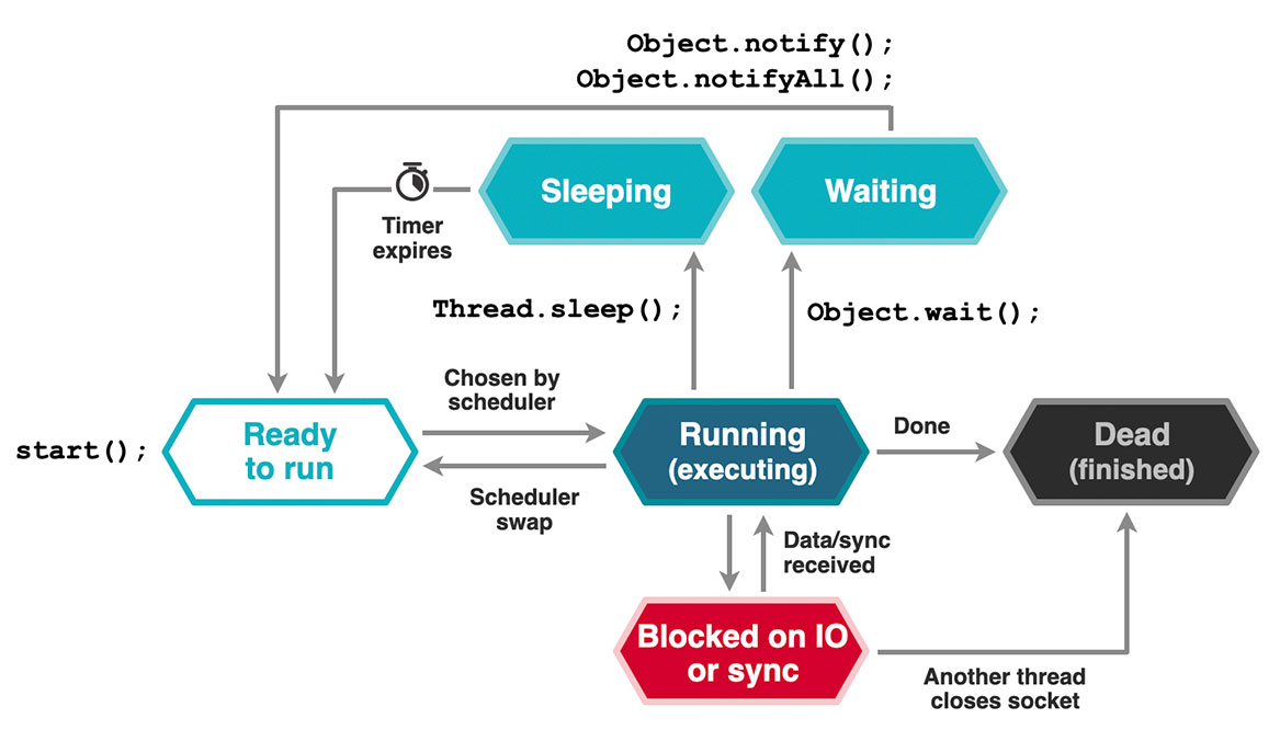

Removing the thread bottleneck is a great achievement, but at this point, you may still be wondering how virtual threads connect with I/O handling and the initial discussion in this article.
Look at the state model for a platform thread in Figure 1. In this model, the OS scheduler moves platform threads on and off the core (that is, it performs the context switches).
Platform thread states example
Figure 1. Platform thread states
There are several ways in which a platform thread can leave the core.
  • The thread can exit—but this case is not very interesting.
  • The thread can pause voluntarily and temporarily (yield) and give up its remaining currently allocated time. It can do so either for a fixed amount of time, via Thread.sleep(), or until a condition is met, via Object.wait().
  • The thread can run without encountering any blocking calls to the standard library or any sleep or wait instructions. In this case, at the end of the thread’s allocated time (sometimes called a time quantum), the scheduler moves the thread to the back of the run queue to wait until it reaches the front of the queue and is eligible to run again. (The time quantum is usually 10 milliseconds—or 100 milliseconds in older operating systems.) However, apart from compute-bound tasks, this case is not seen that often in practice.
  • The thread can encounter a blocking call, for example, an I/O operation. That is how I/O connects with virtual threads.

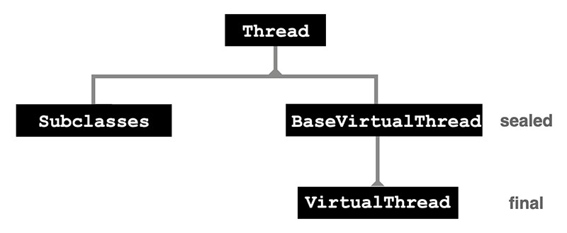

The inheritance hierarchy of Thread has been enhanced by the arrival of virtual threads, as you can see in Figure 2.
The thread hierarchy diagram
Figure 2. The thread hierarchy
Note that the class VirtualThread is explicitly declared as final and cannot be subclassed. Therefore, any existing class that extends Thread directly will be a platform thread. This is part of the principle that the arrival of virtual threads must not change the semantics of any existing Java code.
