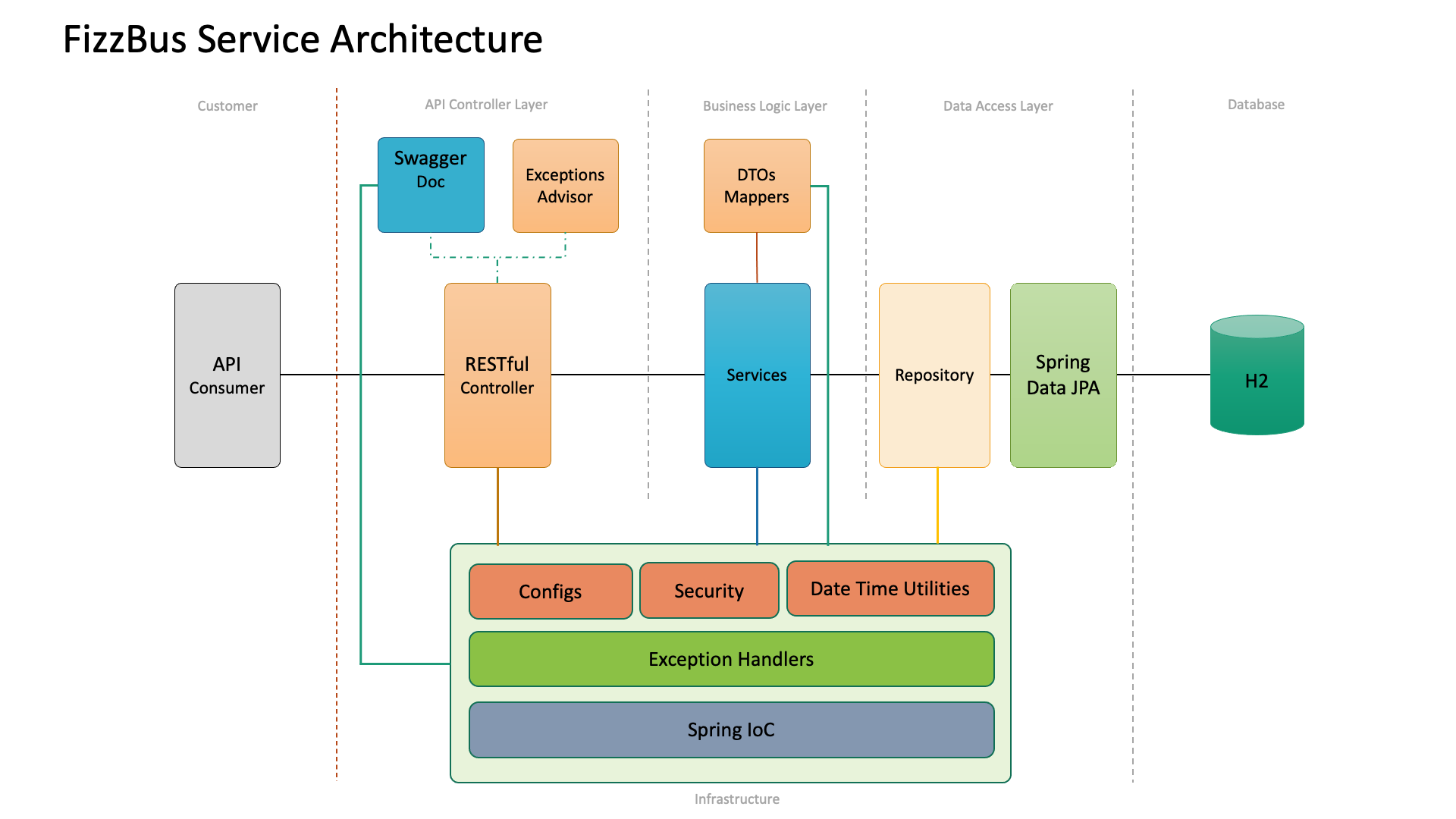

First, let me explain what the FizzBus service is. It’s a simple example of a fleet management system developed as a Spring Boot–based project with RESTful-based APIs for customers.
The FizzBus service uses RESTful-based controllers to connect to business logic that resides in the services layer. The business service layer connects to a database through the repository layer to show how to implement zoned date and time operations in distributed systems correctly—that is, by considering different users’ time zones with Daylight Saving Time (DST) when saving, updating, and searching for data in the database using the architecture shown in Figure 1.
A screenshot of FizzBus service architecture
Figure 1. FizzBus service architecture
Because this is a Spring Boot–based application, the persistence layer is implemented with Spring Data, and I use the H2 Database Engine for persistence. The repository layer consumes this data layer to provide core Create, Read, Update, and Delete (CRUD) functionality to the business logic implemented on the service layer. The controller defines the REST endpoints with the appropriate HTTP methods and is documented using Swagger APIs.
The controller uses the Data Transfer Object (DTO) pattern to map the entity attributes into the required API payload attributes. This decouples domain entities from the API request/response payload data. Data transfer objects are implemented as Java records. I use the MapStruct model mapper library to convert Java records into JPA domain model entities and vice versa in the service layer to avoid manual function mapping. It supports deep object mapping as well.
Exception handling is managed with a control advisor to keep the API controllers much cleaner. It is implemented as a shared-component application bean managed by the Spring Inversion of Control (IoC) container. Furthermore, the exception advisor will handle all the application-specific errors; usually, you don’t need to throw language default exceptions to other layers to maintain application layers more independently.

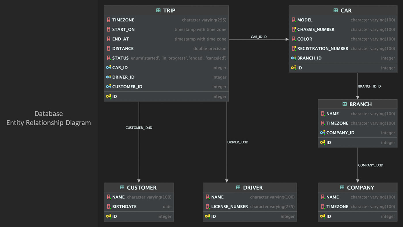

Let’s start with the database where the data will reside; remember, I am using H2. Figure 2 is the entity relationship diagram (ERD) for the FizzBus application.
A screenshot of FizzBus entity relationship diagram
Figure 2. FizzBus entity relationship diagram
The heart of the application is the TRIP table. As you can see in the ERD, the TRIP table has the columns shown in Table 1.

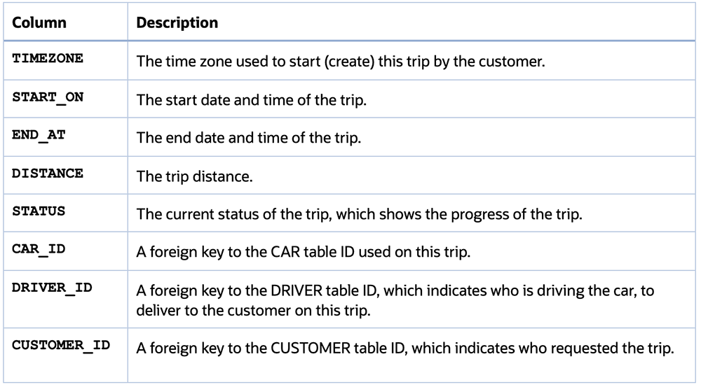

Table 1. Columns in the TRIP table
The START_ON and END_AT columns are of type timestamp (called TIMESTAMP in H2), which holds all the date and time information plus time zone information. (In this application, the time zone will be UTC.) And if you need to save only the date part, for example, your customer’s birthday, the column should be of date type. By the way, when you design your database, please don’t define everything as a timestamp, because that adds complexity and wastes storage. Use timestamp only where it’s needed.
When the application is launched, all the tables will be prepopulated with data except for the trip data. You’ll use REST APIs to create trips and then search for and retrieve the trips.
You can check all the data from the database by visiting the database console at http://localhost:8090/api/v1/fizz-bus/db-console and filling in the following attributes:

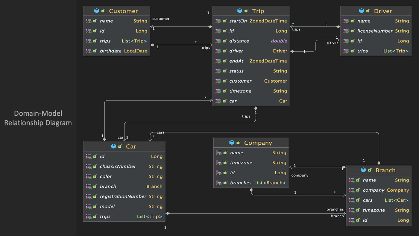

The domain-model relationship diagram for FizzBus, shown in Figure 3, is connected to data tables in the form of JPA entities. It is like the ERD, except it shows the mapping of relevant attributes in Java. The most vital part to consider is that any database field of type timestamp is mapped to one of the following java.time package classes (ZonedDateTime, OffsetDateTime, and Instant). For example, the date type is mapped to java.time.LocalDate.
A screenshot of FizzBus domain-model diagram
Figure 3. FizzBus domain-model relationship diagram
As you can see in Figure 3, the Trip entity fields named startOn and endAt are of type ZonedDateTime, and the Customer entity field named birthdate is of type LocalDate.

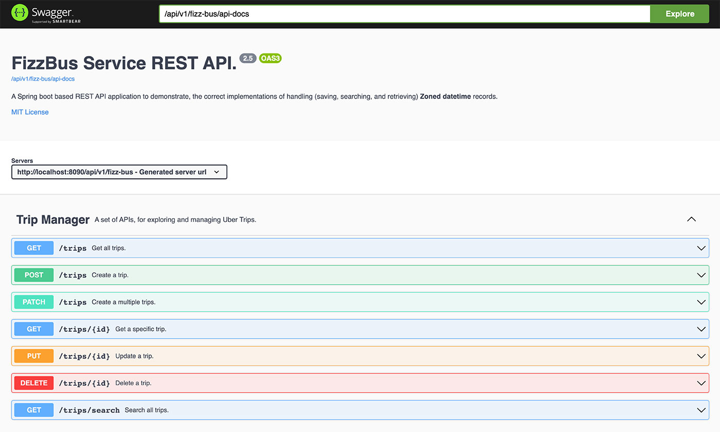

Figure 4 shows the exposed REST APIs for this application.
A screenshot of FizzBus Service Swagger API
Figure 4. FizzBus Service Swagger API
Those REST endpoints (which can be accessed from http://localhost:8090/api/v1/fizz-bus/doc/index.html) manage the trip CRUD operations; you’ll use them to save and retrieve trip details in multiple time zones. All endpoints are exposed using the Swagger user interface tool.

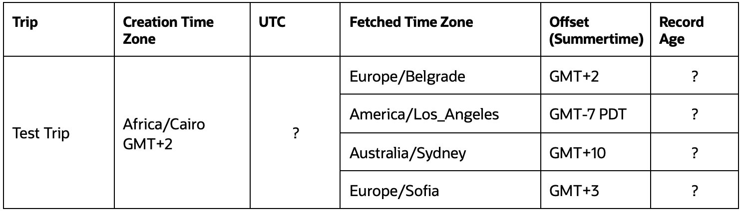

Now it’s time to run a test execution plan that will reveal how the system saves data in one time zone and fetches the same record in different time zones. Table 2 shows the plan to be executed against the FizzBus service.
Table 2. Test execution plan
Test execution plan
Here are the steps of the plan.
  1. First, a request is sent to start a trip in the Africa/Cairo time zone.
  2. The application will convert the time to UTC format because the Spring configuration is set for that. You’ll see what a UTC recorded time in the database looks like.
  3. Finally, the same record will be retrieved in the four different “fetched” time zones shown in Table 2 and the start and end dates will be checked. You’ll see what the record age is, and this record age should not have been changed, showing that the conversion is accurate.
For reference, you can examine a time zone map.

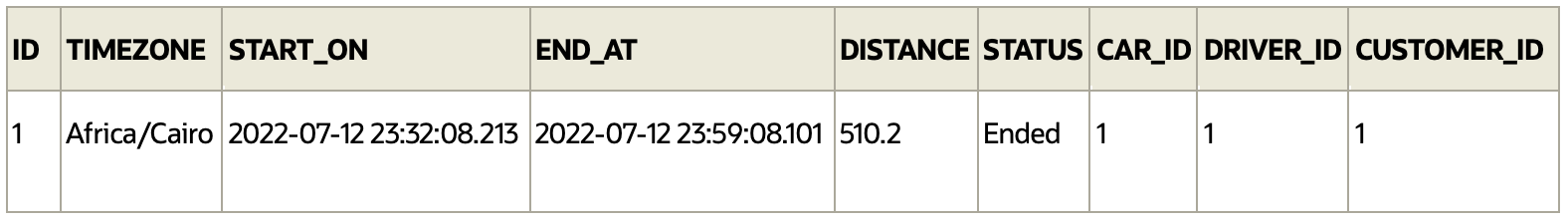

Table 3 shows a snapshot from the database record just saved.
Table 3. Snapshot of the saved database record
Snapshot to the saved database record

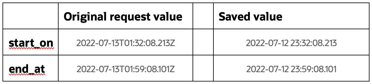

As expected, the times for the start_on and end_at fields were converted to UTC times by default (see Table 4). Notice the difference, which is 2 hours behind the original request’s date and time values. The day is changed as well to be 12.07.2022.
Table 4. Converted UTC values
Now, you can fetch the same record in the same time zone to see whether the time is appearing accurately. Using the Swagger API, you can use either the get all trips or get trip by id endpoint. The time zone is Africa/Cairo. The result is correctly retrieved, and the date and time are accurately presented to indicate the original request, as follows:

public static String toString(ZonedDateTime zonedDateTime, String timezone) {
        return zonedDateTime.toInstant()
                .atZone(ZoneId.of(timezone))
                .format(DateTimeFormatter.ofPattern(DATE_TIME_PATTERN));
Finally, after the correct mapping, the final response is returned to the customer successfully.
