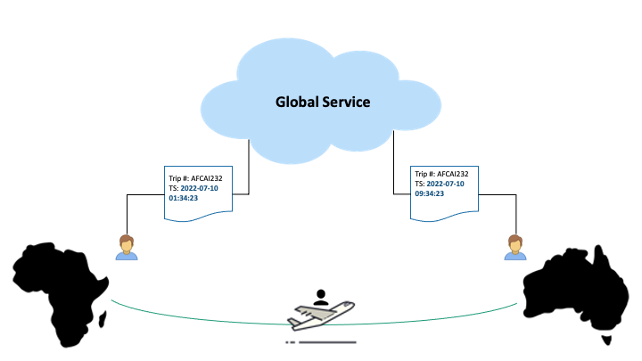

Imagine there’s a customer who will create data while in Egypt today but tomorrow will travel to Morocco and access the data. Meanwhile, that same data will be accessed by a colleague in Australia.

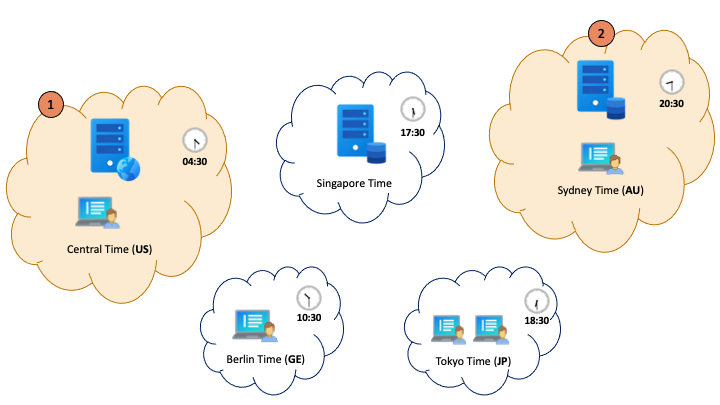

You can see that your infrastructure should spread across multiple time zones; otherwise, your users may gain access to the system from different time zones. This issue is not straightforward, as you can see in Figure 2. In this figure, one user and a server are in the US time zone called Central Time (“1” in the figure). Similarly, a user in Sydney is in the same time zone as a server there (“2” in the figure).
Figure 2. Some users and servers in the same time zone

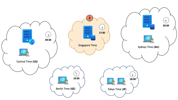

What if a server doesn’t have users in the same time zone? That’s the situation shown in “3” of Figure 3.
Figure 3. A server in a time zone that doesn’t have users

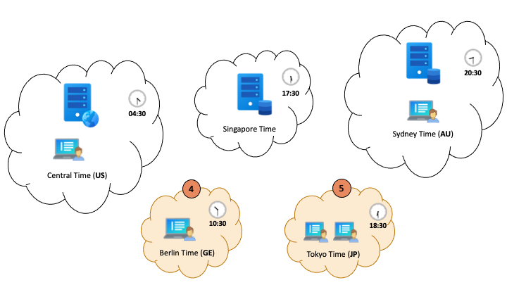

Meanwhile, users in some time zones might need to access servers in different time zones, as shown in “4” and “5” of Figure 4.
Figure 4. Customers accessing a server from a different time zone

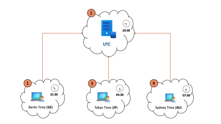

In such a situation, the general approach is to capture the date and time, in database files and in logs, in a standard time format, which is usually Coordinated Universal Time (UTC), also known as Greenwich Mean Time (GMT). Therefore, when a customer is accessing date-related attributes from a different time zone, you need to identify the user’s local time zone and convert the UTC time zone data attribute into the user’s local time zone on the fly.
Figure 5 shows that a customer from Berlin (“1” in the figure) created a data record, and his local time was 21:30. (I’m using 24-hour time to keep things simple.) The record will be saved on the server as 20:30 after converting it to UTC (“2” in the figure). The customers from Tokyo (“3” in the figure) and Sydney (“4” in the figure) will access the same record and read the record creation time as 05:30 and 07:30 local time, respectively, of the following day.
Figure 5. Distributed time zone architecture
