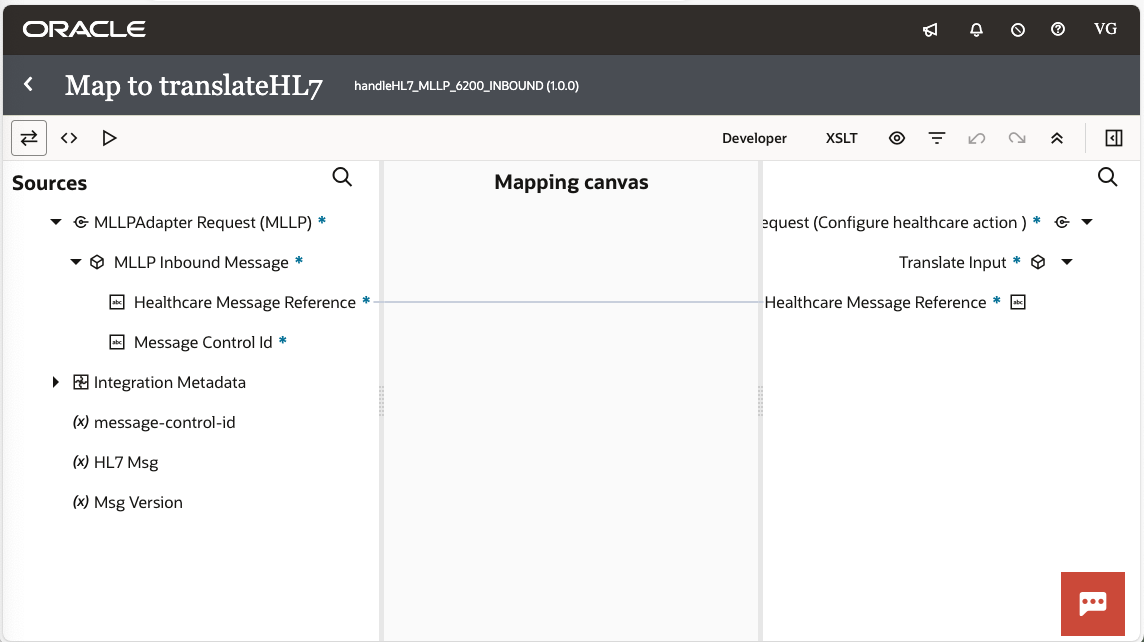

1. Healthcare Message Reference
The packaging of the raw HL7 message received from the MLLP adapter and the way you must handle that message in your integration have both changed.
  • The message that you receive from an MLLP adapter trigger connection is now a Healthare Message Reference. You can take this reference and pass it directly into the Healthcare Action. You no longer need to decode using decodeBase64.
  • Likewise, when you send an HL7 message outbound from OIC, the Healthcare Action will produce a Healthcare Message Reference for you to pass directly into the MLLP adapter invoke connection. There is no need to encode to base64 first.
HC message map

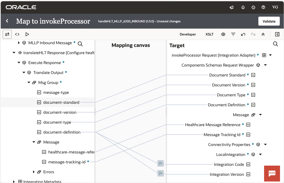

This payload provides metadata about the message and the capability to support batch messages as well. You can map this data using the data returned from the Healthcare Action when you call the operation Match and translate inbound message. An example of this mapping is shown below.
Processor integration mapping
