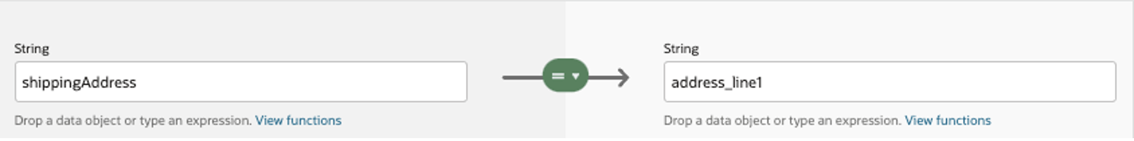

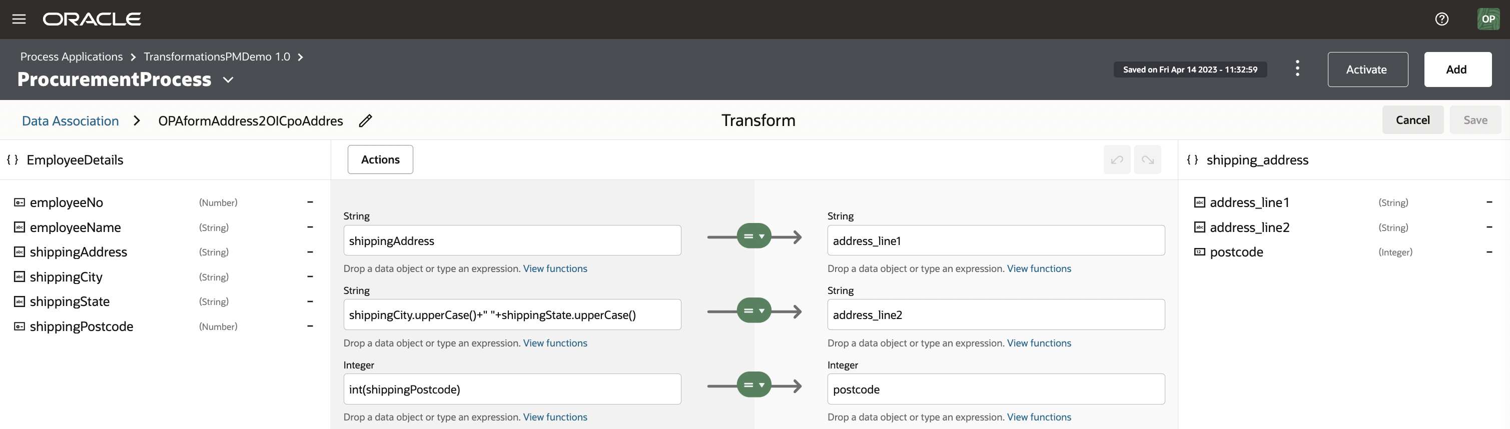

Scenario 1: Map objects with a different structure
OPA transformation - scenario 1
Let’s start off with a simple scenario, where we want to map two objects with different types. To depict this use case, I am using a transformation between a source and a target object which both capture address information. As you can see these data objects are very different and I need to do some data manipulation to ensure that the data is correctly transformed to the format that the target (in this case an API) requires. So why use a transformation here, after all I can implement the same mapping in a Data Association. The main reason for doing so is re-usability, but more on that later.

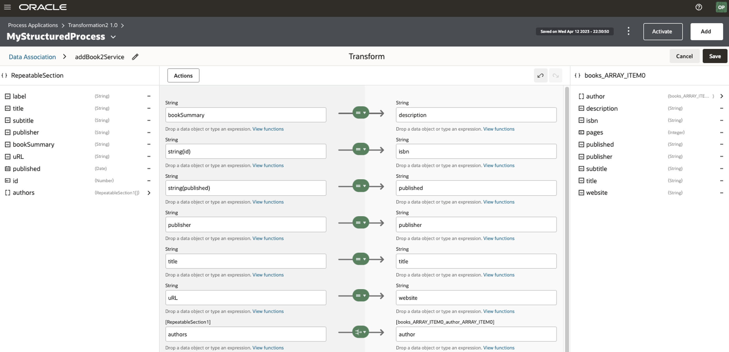

Scenario 2: Map array objects with a different structure:
OPA Transformation - Scenario 2

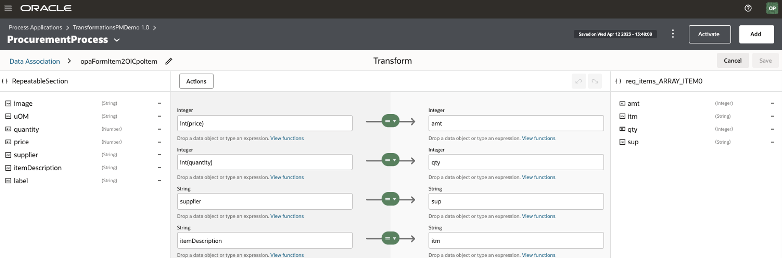

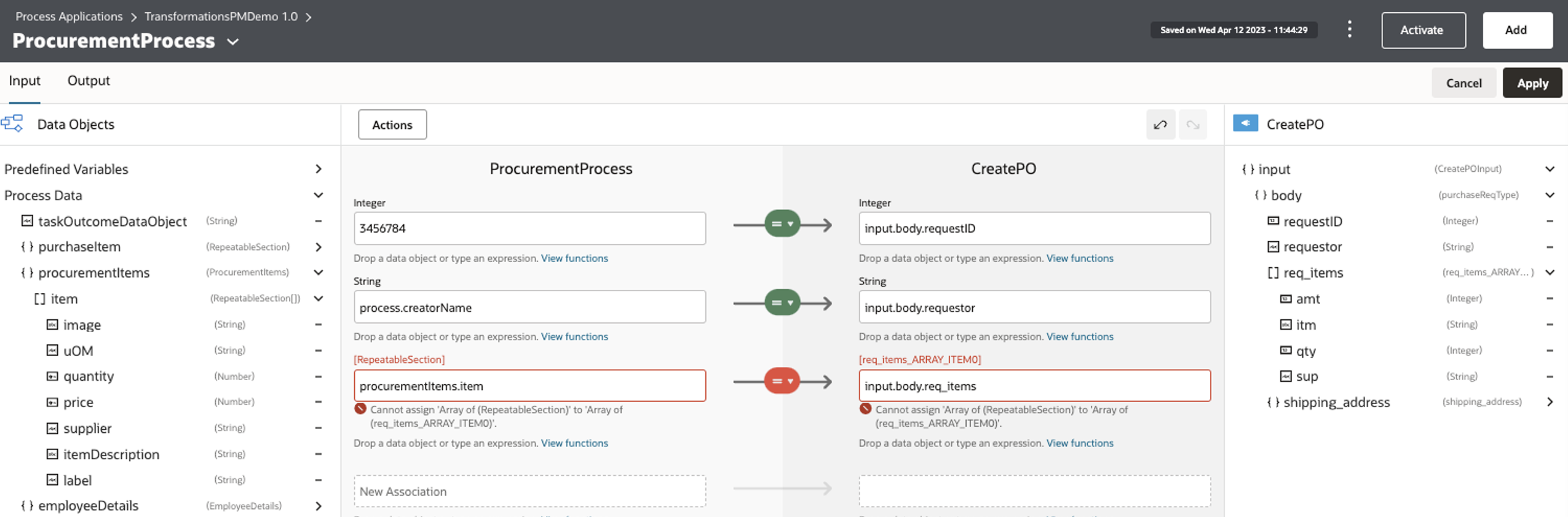

In this scenario imagine that we have an array of objects in a source and target systems, both representing the items ordered through a procurement process. As is often the case, the data objects of the two systems vary and different field names and types are used. To be able to map data between these systems we need to use an OCIPA transformation. In this scenario, I have created the below transformation which will apply the following mapping to each item in the array.
OPA Transformations - Scenario 2

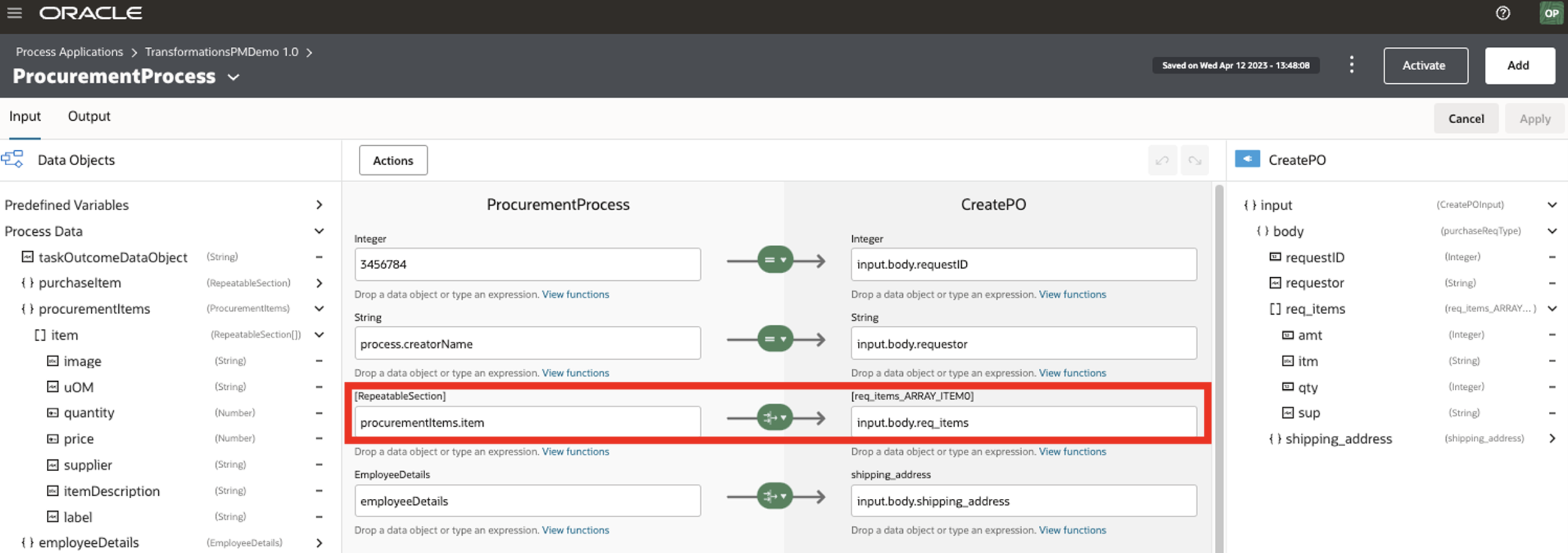

So now the overall mapping would look like this:

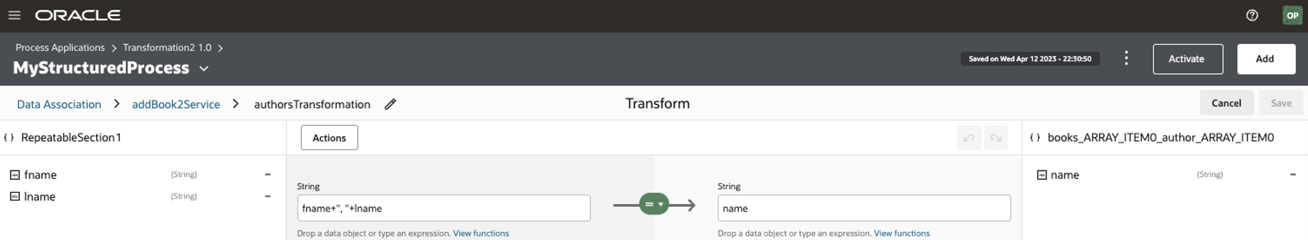

Scenario 3: Map nested array objects

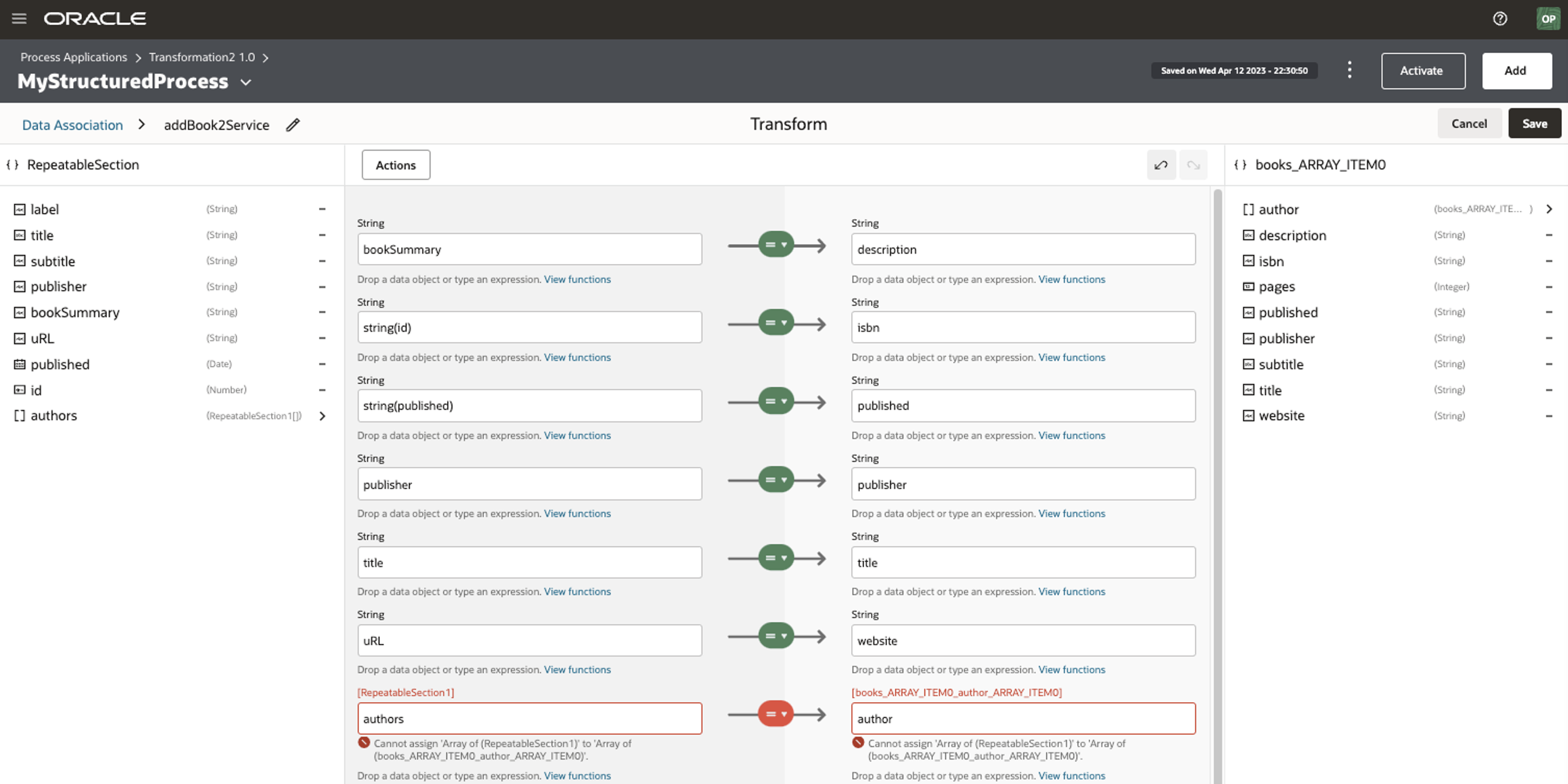

In the previous scenario we showed how you can create a transformation between two different arrays in a source and target data object. But what if that array also contains a child array. This is where nested transformations come in to play.
To cater for this scenario, start by creating a transformation for the parent level array:
OPA Transformations - Scenario 3
Then drag the two child arrays you want to map and create another nested transformation between the child arrays:
The net result of the parent transformation will now be:
And that’s it, you can use this approach to apply a mapping for each iteration of an array at any level of a data object.

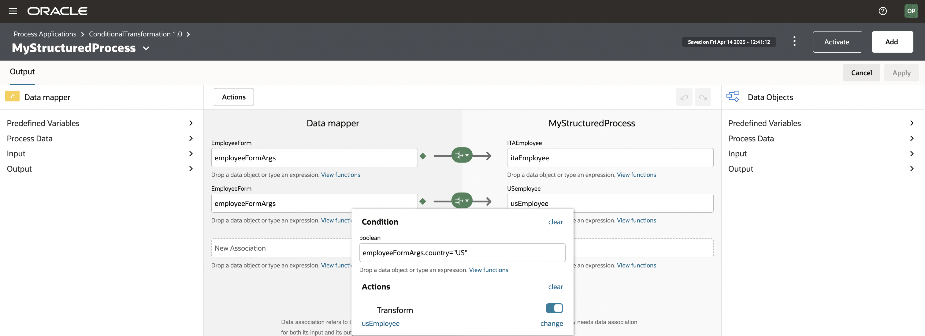

Scenario 4: Conditional transformation

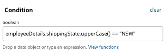

Conditional transformations are very useful when you need to transform data between objects in a different way based on some predicate. Consider the below scenario; here I have a conditional transformation based on the employee’s country. If the country is Italy, I will map the data one way and if the country is equal to US, then the data will be mapped in another way. To create a conditional transformation, simply associate a condition to the Data Association which your transformation is applied to:
OPA transformations - Scenario 4

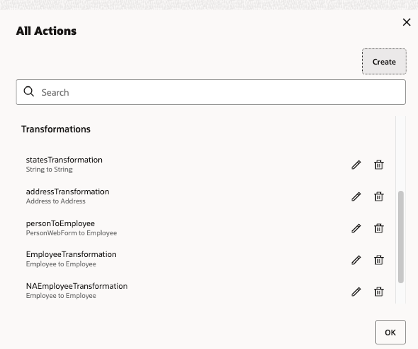

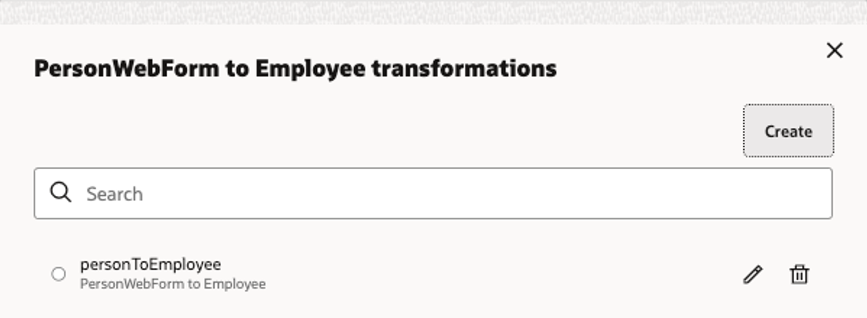

Scenario 5: Re-use a transformation
If you ever need to map the same data objects again, our engine will automatically recommend the transformation that can be re-used. To do this simply drag the same source and target data object in the data mapper and select the option to apply a transformation. A pop-up will then appear that shows you the re-usable transformation that applies to those specific objects:
OPA Transformations Catalogue

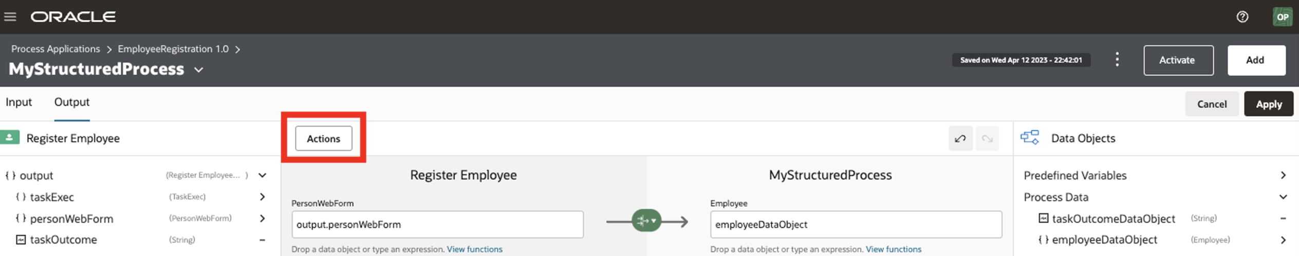

OCIPA also allows you to browse through the catalogue of transformations by selecting the Actions menu in any data mapper. Transformations can be re-used by all activities that carry a data mapper within an application. This means you can reuse transformations in activities that are part of the same or even different processes if you are within the scope of the same application container:
OPA Transformations - Actions Menu
OPA Reusable Transformations
