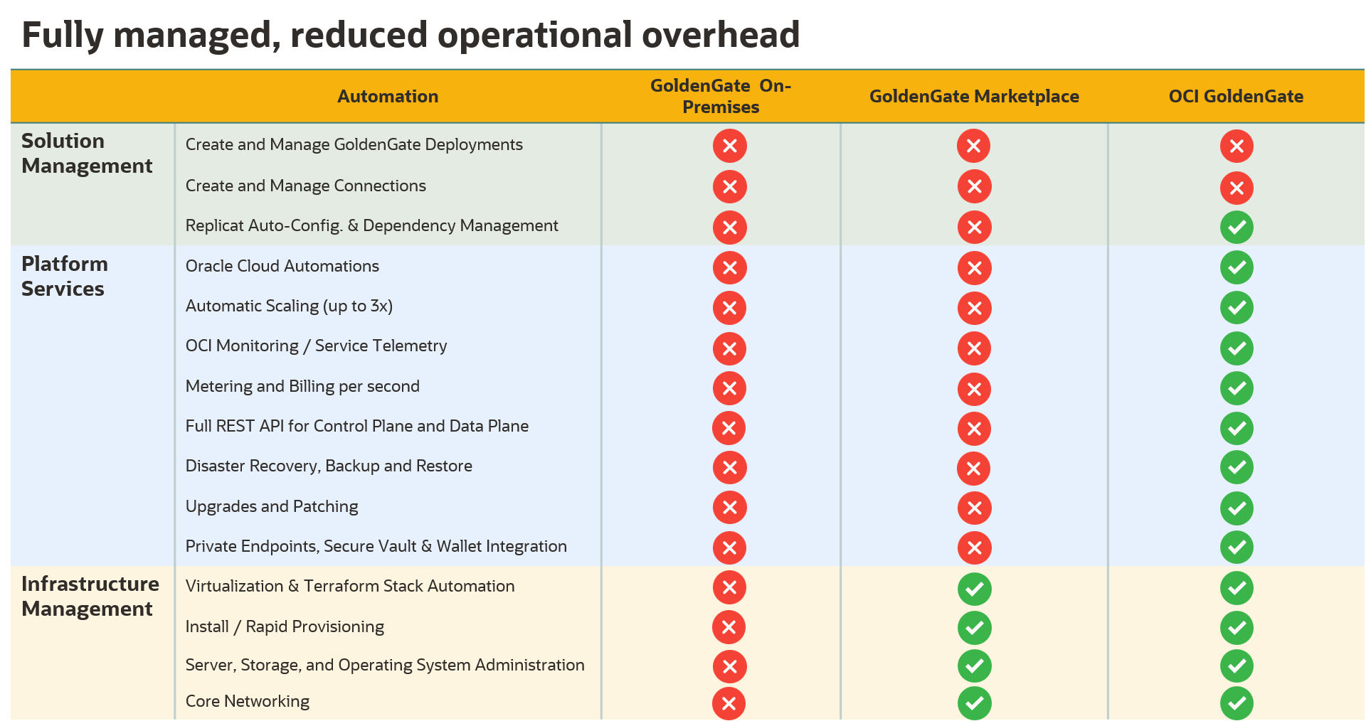

Columns to describe GoldenGate solution

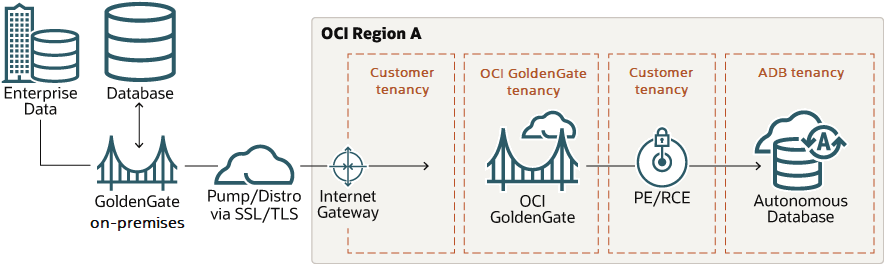

Solution diagram
