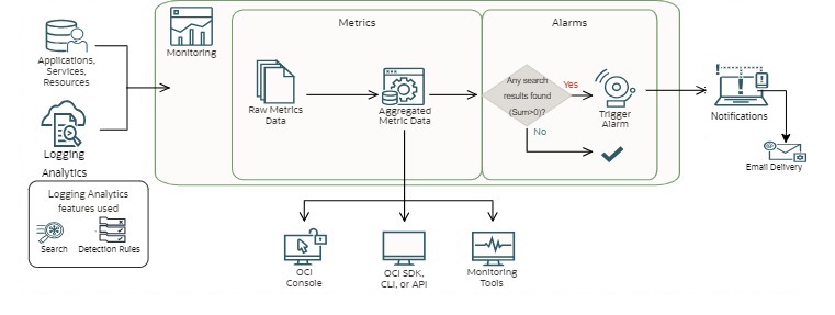

Oracle Cloud Infrastructure (OCI) Observability & Management capabilities can provide a solution to create alerts from the collected logs, by leveraging the Logging Analytics search query customization to filter relevant log entries from a large chunk of log data. There is even the option to extract specific content from log entries to be flagged in alert emails. With minimal configuration, you can convert the log query output into the metrics sent to the monitoring service and create OCI alarms to trigger emails whenever Logging Analytics finds the logs with your required alert use case.
Solution diagram

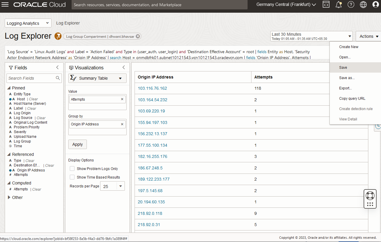

1) Configure Search Query to extract required information from audit logs:
  • Navigate to Logging Analytics from Main Menu => Observability & Management => Logging Analytics => Log Explorer.
  • Ensure that the right compartment is selected.
  • Create your search query by typing a query in the search bar or selecting from fields & visualization sections in Logging Analytics UI.
  • Set the duration to the last 10 minutes to search recent logs ingested in the last 10 minutes.
Sample query: ‘Log Source’ = ‘Linux Audit Logs’ and Label = ‘Action Failed’ and Type in (user_auth, user_login) and ‘Destination Effective Account’ = root | fields Entity as Host, ‘Security Actor Endpoint Network Address’ as ‘Origin IP Address’ | search Host = <HOST NAME> | fields ‘Origin IP Address’, Attempts | stats count as Attempts by ‘Origin IP Address’ | where Attempts > 0
  • Save the query by clicking “Save” from the “Action” menu from the top right area in Log Explorer UI. Provide the appropriate Search Name and description in the Save Search page.
Log explorer img
Save search

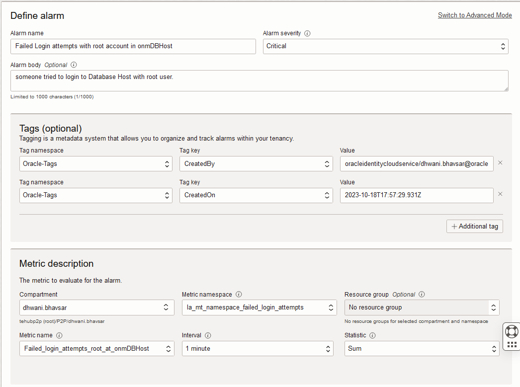

3) Define Alarm and Notification.
  • Provide the Alarm Name, Alarm Body, and compartment. Metric details would be pre-filled in the Define Alarm form as it captures the same from the Detection Rule details.
  • Select Alarm Severity with regards to the affected system. (i.e. Critical, Error, Warning, Info).

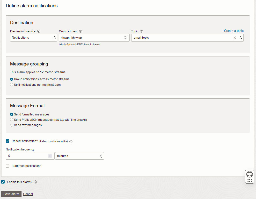

  • Select Notification as Destination and the topic you created to send the emails from the OCI Notification service.
  • Update the metric Interval (data aggregation window)and metric statistic.
  • Select metric dimensions for the alert.
  • Set the Trigger rule as per your requirement, here I have configured an alarm to trigger even if I receive one matching log entry.
  • Select Notification Destination Service and the topic you created to receive the emails from OCI. I have selected “Notification” as the destination and “email-topic” as the Topic (which I already created earlier).
  • Enable Repeat Notification to handle alarm in firing state and set the “Notification Frequency” to resend notification at the specific interval. This is required when the alarm triggers for a longer duration.

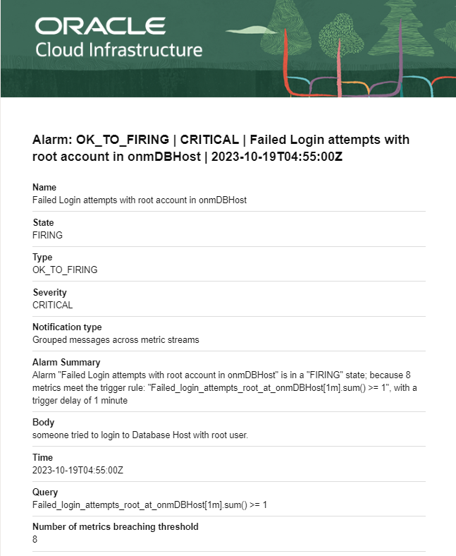

4) Sample Email notification.
The Alarm goes from OK to Firing state once it is triggered and sends an email to the destination email address specified in OCI Topic.

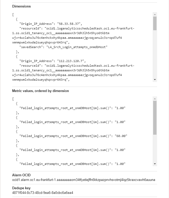

You will receive the email with the alarm summary, severity, timestamp, and number of metrics breaching the threshold with additional information from the search query and alarm configuration.
Alarm
Dimensions
After the alarm stops triggering, you will receive one more email with the Body Alarm: FIRING_TO_OK which indicates that the alarm is not triggering now and will trigger again once it matches the trigger condition in the future.
