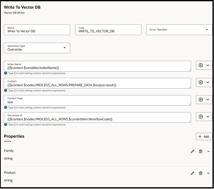

Vector DB Writer Node
Store high-value knowledge as embeddings for future semantic retrieval
The Writer converts content into vector embeddings and stores them in Oracle’s 23ai vector database within the customer tenant. Each entry is uniquely identified by a Document ID and enriched with custom metadata properties that enable precise downstream filtering.
Configuration Details
FieldType / ValueWhat It MeansHow It Should Be Used
NamestringDesign-time name for the nodeUse descriptive names like WriteResolutionSummaryToVectorDB so the workflow is easy to understand.
CodestringProgrammatic identifier in the workflow schemaAuto-filled or user-defined. Use lowercase and underscores (e.g., write_resolution_vector).
OperationINSERT, OVERWRITE, UPSERT, DELETEDefines how the document is writtenUse Insert for new entries only. Overwrite to replace existing content. Upsert to safely update-or-create. Delete to remove outdated entries.
Index Namestring (required)Name of the vector index to write intoChoose an existing index or specify a new one (e.g., support_ticket_summaries, product_docs_index).
Contentstring (required)The textual data to embedShould be summarized, clean, and structured. Avoid raw logs; use LLM-generated summaries, extracted facts, or curated knowledge.
Content Typestring (required)Type of content being indexed/embeddedjson, text
Document IDstring (required for DELETE)Unique identifier for this recordUse stable IDs like ticket_1123, customer_450_profile. Prevents duplicates and enables safe retries.
Propertiesarray of {name, type, value}Additional optional metadata key-value pairsE.g., {objectId:”a12333″, region:”NA”, severity:”High”}. Used as filters during read operations.
⚠️  Normalize Before Writing – Always use a Code node upstream to clean and standardize data. Summarize large documents, enrich with key metadata, deduplicate overlapping information, and remove irrelevant details. Produce small, clean semantic capsules and extract key fields.
