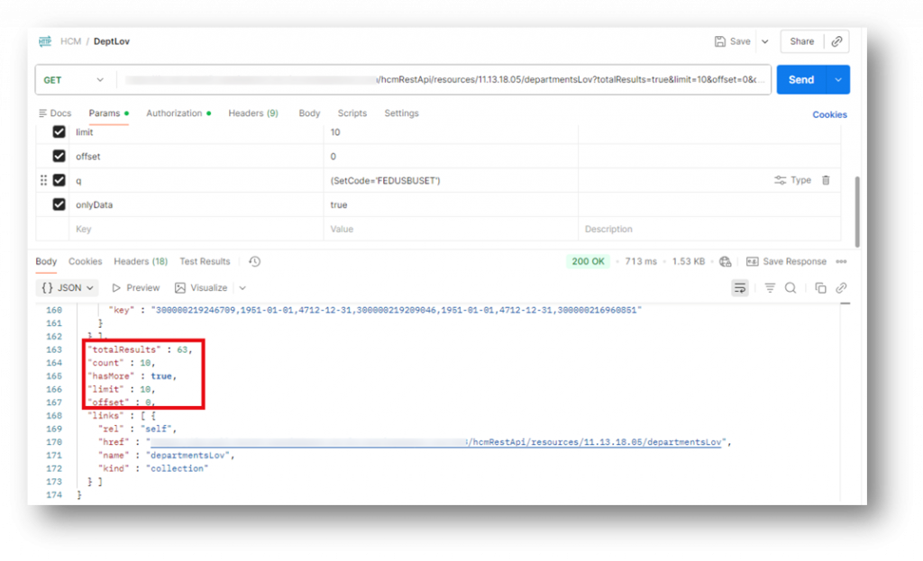

For this blog, we will use DepartmentsLov as an example. Here are the key pagination signals you’ll notice when using this API:
  • totalResults – the complete count of records in the dataset
  • hasMore – a boolean flag indicating whether there are more pages
  • limit – how many records were returned in this response
  • offset -the starting position of this page (0, 10, 20, …)
A typical API response looks like this:
This tells us: there are 63 records total, we got the first 10, and there are more pages to fetch.

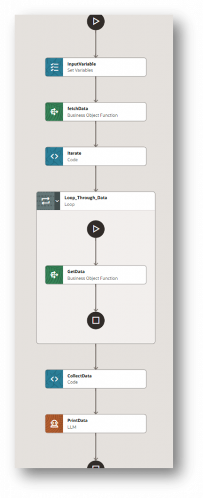

The Complete Agent Flow
Here’s the full node sequence for the workflow agent, in order:
  1. Set Variables (InputVariable) -Initialize fetchSize = 10
  2. Business Object Function (fetchData) -Call API with limit=1, offset=0 to get totalResults
  3. Code Node (Iterate) -Generate offset array based on totalResults and fetchSize
  4. Loop Node (Loop Through Data) – Iterate sequentially through offset array
  5. Business Object Function inside loop (GetData) -Fetch each page using dynamic limit + offset
  6. Code Node (CollectData) -Aggregate all page results into one flat array
  7. LLM Node (PrintData) -Render final HTML table output with all results
Key Design Insight:  The initial fetchData call (limit=1) is used only to retrieve the totalResults value. This allows the agent to calculate how many API calls are required upfront. The actual data itself is not used from this call -all real data retrieval happens inside the loop through the GetData node.
Putting all of this together, the agent follows a structured sequence -starting with determining the total number of records, generating the required offsets, looping through each page, and finally aggregating the results.
The diagram below shows how these nodes are connected in Oracle AI Agent Studio and how the data flows through the agent from start to finish.

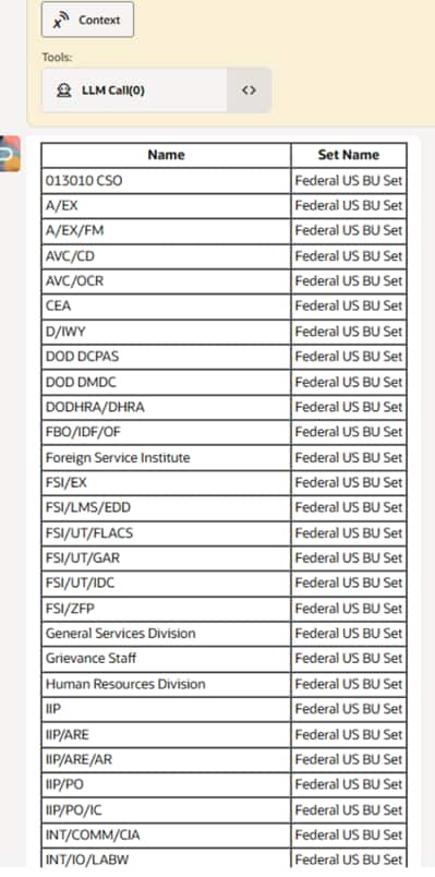

The Output: A Clean, Consolidated Table
After collecting all pages, the final Code node combines everything into one array. This is passed to the LLM node for rendering. The instructions below represent the exact prompt provided to the LLM node:
Generate only HTML, no extra text or formatting.
Use an input JSON array to create a table with two columns: Name and Set Name
Output must start with <div> and end with </div>.
This tight prompting ensures the LLM doesn’t add commentary or markdown -just clean, renderable HTML that displays all 63 department records in one scrollable table, regardless of how many API pages were needed to collect them.
Here’s an example of the final output generated by the agent after aggregating all paginated results:
Agent Results
