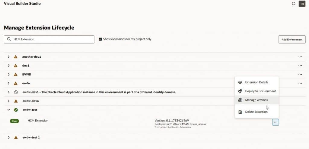

If you want to undeploy the most recently deployed extension from an environment, you have several options.
For example, if you used Manage Extension Lifecycle to copy a deployment to the wrong environment, you may want to retain the changes but remove the deployed extension and its personalizations.

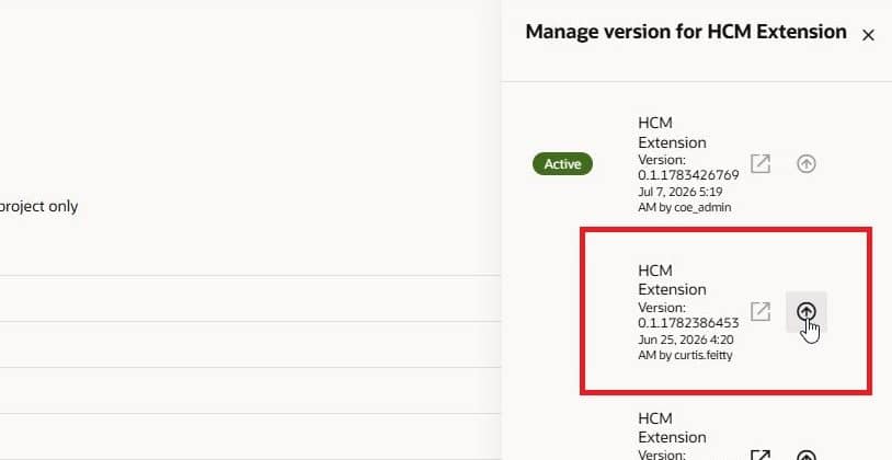

Previously, you could remove only the deployed extension. Starting with VBS release 26.07 (see here), you can also roll back the current extension to a previously deployed version.
Alternatively, you can delete the deployed extension and deploy the correct version from another environment, or redeploy an updated extension from a different or corrected Git branch.
