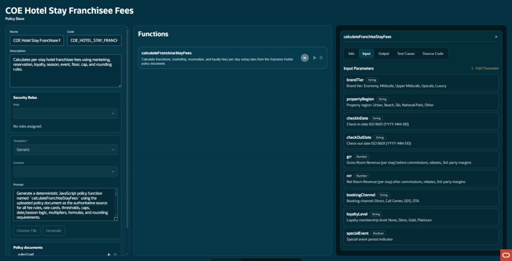

Design time: Generate the policy function
Start with the business policy – typically an unstructured or semi-structured document such as Markdown, Word, Excel, or PDF. In the Policy builder, provide the document and instructions for generation. AI Agent Studio uses an LLM to extract the business logic and generate JavaScript that implements the rules.
The result is no longer an LLM interpretation at runtime. It is generated source code that applies the rule set in a fixed, deterministic way. The Policy builder shows the generated function, its input parameters, output schema, test cases, and source code. This source view gives teams the traceability to inspect what was generated, even when policy owners do not intend to edit the code directly.
Policy Function Definition

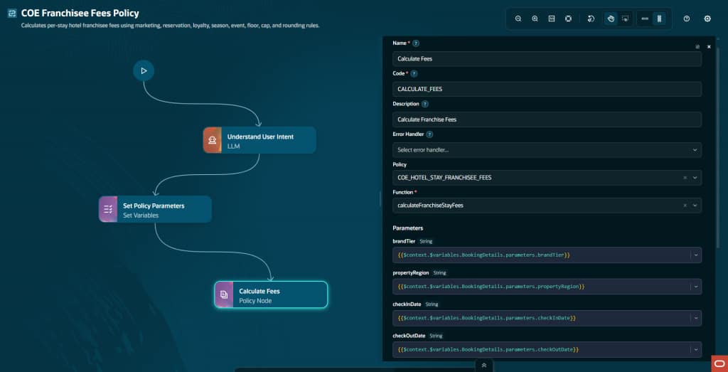

Runtime: Invoke the function from a Workflow Agent
After the policy is tested and published, a Workflow Agent’s Policy node selects the policy and a function within it. The workflow maps values from variables or upstream node outputs to every required input parameter. The Policy node executes the function and makes the structured output available to downstream nodes, just like any other node output.
This keeps the boundary clear: an upstream LLM can extract the facts expressed in natural language, while the policy function applies the business logic to those facts.
Policy Node in Workflow Agent

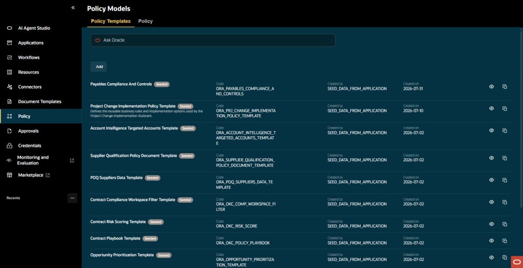

Policy Templates vs. Standalone Policies
The Policy area has two related concepts: Policy Templates and Policies.
A useful mental model is a Java interface and an implementation:
ConceptRole
Policy TemplateDefines the reusable shape or contract: function signatures, input/output parameters, and shared generation guidance.
PolicyThe concrete, executable implementation of a particular ruleset.
You do not need a template to create a policy. A standalone policy is often the quickest route for a single ruleset. Templates become valuable when you have a class of related policies that must use the same function contract.

Use the Generic template when you have one policy document and want to generate a self-contained policy. This is the simplest approach and the one used in the hotel-fee lab.
With Generic, you can provide a policy-specific prompt to guide generation. The prompt is optional, but it is particularly useful when the policy document is complex. It can instruct the model to create one function, use a defined name, follow exact input/output fields, validate dates, preserve calculation precision, and apply caps and rounding in the prescribed order.
For example, the hotel policy prompt asks the generator to create a single deterministic function named calculateFranchiseStayFees. That matters: without a clear contract, a complex document could lead the generator to create multiple helper decisions where the workflow expects one callable function.
Choose a Policy Template when
Use a Policy Template when multiple policies share the same decision shape but differ in regional, organizational, or policy-specific details. For example, an opportunity-prioritization policy may share the same inputs and outputs across regions while using different scoring rules for the Americas, EMEA, and Asia Pacific.
Templates provide two important benefits:
  1. A stable function contract. The template can define the functions and their input and output schemas in advance, so every policy created from it follows the required shape rather than deriving it independently from each rules document.
  2. Layered generation guidance. A template can have an overall prompt for the entire policy family, while each defined function can have its own focused prompt. These instructions work together when the LLM generates the code.
For a single function, a Generic policy prompt and a template-level function prompt can serve a similar purpose. The real advantage of a template appears when you need repeatable interfaces, multiple prescribed functions, or consistent generation across many policy instances.
**Design guidance:** Treat a Policy Template as an API contract. Define its function signatures and schemas carefully before creating dependent policies. A later template change should be assessed and tested deliberately; previously generated policy code does not become a new implementation until it is regenerated.
