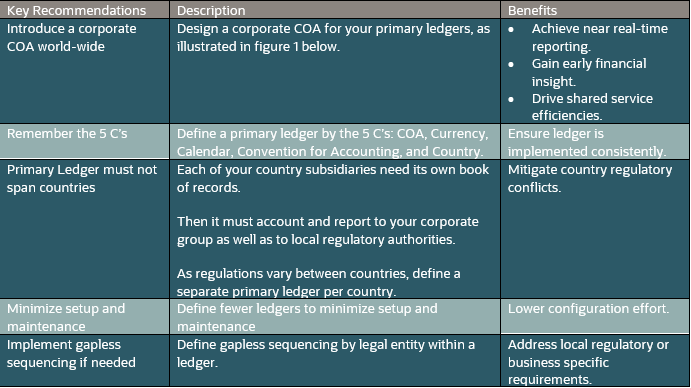

Primary Ledger
You configure a primary ledger to secure, manage, and close General  Ledger financial balances of the principal bookkeeping entity.
Recommendations for primary ledger

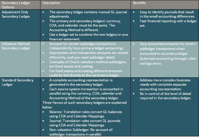

Secondary Ledgers
You configure ledgers and subledger accounting rules to populate secondary ledgers through one of the three options below. Select one of three options based on the best fit to your business needs.
Secondary ledger options

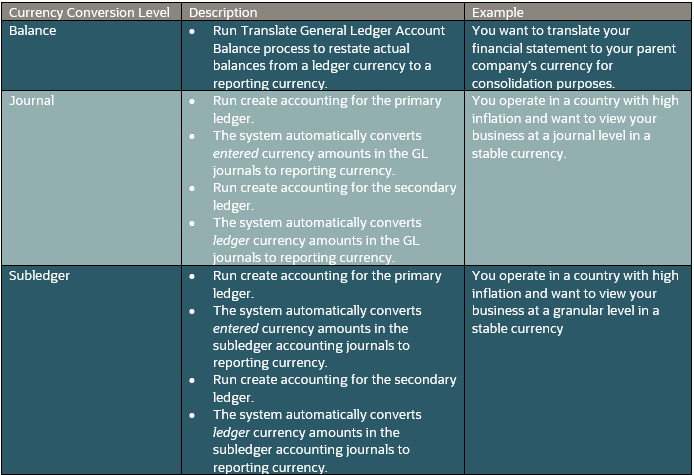

Reporting Currencies
You maintain accounting records and report in more than one currency through reporting currencies. You can define one or more reporting currencies for a ledger in Oracle Cloud ERP.
Remeasure or translate primary or secondary ledger balances into another currency.
Decide on one of the currency conversion levels: balance, journal, or subledger.
Currency conversion levels

Primary Ledgers
  • The Spanish and Canadian subsidiaries report to the parent company in USD and US GAAP.
  • Establish a corporate chart of accounts combined with the same corporate calendar and accounting method across the primary ledgers to address US GAAP.
  • Nominate the primary ledger currency as the functional currency of each subsidiary, meaning the local country currency.
  • Process finance data and view results in screens and reports in primary ledger currency.
Secondary Ledgers
  • The Spanish subsidiary must also adhere to regulatory requirements in Spain.
  • Define a secondary ledger to help address the regulatory requirements.
  • Decide on which option to use to populate the secondary ledger, as explained at start of this blog.

  • Associate a reporting currency ledger in USD with the Spanish primary ledger. Apply Balance level translation.
  • Associate a reporting currency ledger in USD with the Canadian primary ledger. Apply balance level translation.
