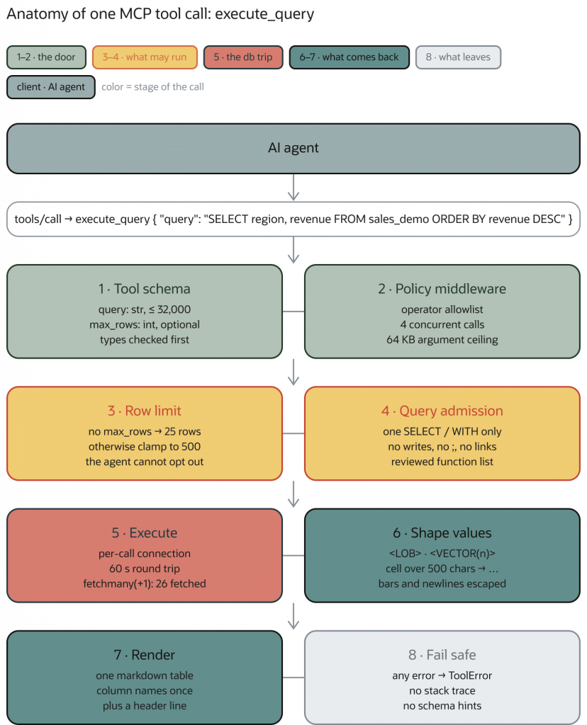

The anatomy of an MCP call
execute_query call, from tool schema and query checks through database execution, result formatting, and error handling.Let’s follow what happens to one of the functions inside the MCP: execute_query. After an MCP call is made, eight stages are triggered, and every MCP server call roughly follows this pattern.
- Tool schema. The request arrives as
tools/callwith a tool name and its arguments. Before invoking the tool, the server checks those arguments against the types the tool declared. For example,querymust be a string no longer than 32,000 characters, whilemax_rowsis optional but must be an integer if supplied. The types are strict: a string such as"25"is rejected as a value formax_rows. Arguments that do not match the advertised schema are rejected before they reach the database. - Policy middleware. This layer belongs to whoever operates the MCP server. It holds an allowlist of which tools exist. A disabled tool isn’t refused, it’s never listed. Each call gets an ID for future inspection in the MCP server logs.
- Row limit. The agent can ask for a number of rows, but can’t ask for all of them. If no
max_rowsis specified, it defaults to 25, and if it’s specified it will be limited to a maximum of 500 results. If the AI agent needs more information apart from the maximum number of results, it can make another MCP query. This prevents the context window of the AI agent from filling up unnecessarily. - Query admission. Now the SQL is read as text: exactly one statement, opening with either
SELECTorWITHstatements, no writes, no semicolon (the injection tricks we mentioned earlier), no database links, no unbound parameters, and every function must be on a list a human (the MCP creator, in this case me) reviewed, where the SUM and ROUND operations are included. It decides what is worth sending to the database; it doesn’t decide what the database will allow to run. This tool selection must be relevant to what you want the agent to be able to do: according to the functionalities of your MCP server, you will notice actions or entities that you want available. For example, in this case, a way for the agent to execute SQL queries. - Execute. One connection, opened for this call and closed when it ends, with a 60-second limit on each database round trip (to avoid stuck processes). The server asks for one row more than it shows, and the connection identifies itself to the database with the call’s ID — so the session on the database side is named and traceable in the logs.

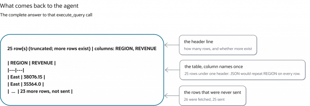

- Shape values. The result is the database’s, not the agent’s, and it’s converted at the door: a Large Object (LOB) becomes
<LOB>and is never read, a vector with adimdimensionality column becomes<VECTOR(dim)>— the agent learns the embedding is there without receiving 1,536 values — binary becomes<binary N bytes>, and any cell past 500 characters gets clipped. Pipes and newlines are escaped so a value can’t forge table structure. Same decision as “what is worth letting in,” applied one cell at a time. - Render. In this step, we render the result as a markdown table, with column names (only appearing once) at the top, and a metadata line, avoiding the JSON context window issues we mentioned earlier as well.
- Fail safe. If there is an error, we simply return an error message avoiding any type of data leakage: no stack trace (which would allow attackers to try to find exploits in the code), no database error texts, and no schema hints. An error message that names your tables and columns is free information for malicious actors. The detail goes to the server’s log, where the MCP operator can read it, but the AI agent can’t. Note that not all AI agents are running on frontier labs models that have refusals, so we need to be careful just in case the model has been trained to remove refusals and act maliciously.
So for this MCP call, here is the complete answer that comes back: a header line saying how many rows there are and whether more exist, a single row of column names, and 25 rows. The next rows can be fetched, but are discarded and not returned to the AI agent. We simply tell the agent that there’s more available, and the agent is free to make another tool call to retrieve more information if it needs.
