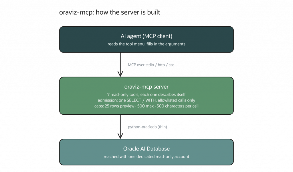

I built a minimal MCP for the Oracle AI Database, with a focus on data visualization and being deliberately tiny: seven tools, read-only, small enough to read in a sitting.
It connects to Oracle AI Database, runs queries, profiles tables, and turns results into charts. It isn’t a replacement for Oracle’s official MCP servers — it’s a proof of concept MCP.
When people hear “MCP server,” they picture infrastructure: a service, a cluster, a deployment diagram. It’s nothing like that. An MCP server is a collection of things an AI agent is allowed to do, where each item on the list describes itself. You write one function per item — “run this query,” “list these tables” — and attach a plain-English description. The agent reads the menu, picks an item, and fills in the blanks.
So the interesting part isn’t how the MCP protocol works: it’s three questions each item on the list has to answer.
Question 1: What am I allowed to run?
My server only accepts read-only queries. Before anything reaches the database, it checks that the request starts with SELECT — the word meaning “show me” — and rejects anything that would create, change or delete data.
It also refuses to run two commands at once, an old trick used in cybersecurity injection attacks, which consists in smuggling a second instruction past a check that only inspected the first part of a query.
Here’s the part that matters: this check is cosmetic, and cosmetic checks are theater. It’s pattern-matching on text — it reads the shape of a request, not its meaning. It can’t catch a request that’s technically read-only but triggers side effects. And it fundamentally cannot stop a perfectly ordinary “show me everything in the employees table” that returns every salary in the company. If you want to manually control this, it’s just a matter of writing more detailed functions or capabilities of your MCP server with access control and similar techniques.
The check is like wearing a seatbelt in your car: it won’t stop you from crashing if you’re determined to crash, but it will certainly make the crash easier on your body.
The real boundary isn’t code at all — it’s which database account the server logs in with (as there’s only one database account the MCP server uses). If that account can’t change data, the MCP server won’t be able to change the data either. Not because the code says so, but because the database already has access control implemented in its software. That holds no matter what the agent asks for, or what instructions somebody hid in a document it read.
That account still needs a real identity. In production, give the agent or workload its own principal, authenticate it through the same identity system you use elsewhere, and grant only the roles it needs (the fewer permissions, the better). OAuth, workload identity federation, or a tightly scoped key can establish that identity.
Your MCP server’s security model (for your database) is your first line of defense against attackers We don’t need to reinvent the wheel, as the database already has a pretty robust and secure system built around it. If you want to remember something from this reading, make it this.

Every tool in my MCP that returns data follows the same contract:
| What’s capped | Default |
| Rows shown by default | 25 |
| Absolute maximum per query | 500 |
| Characters per cell | 500 |
| Query timeout | 60 seconds |
There’s a small trick in there I like to do: when the agent asks for 25 rows, the server quietly fetches 26, shows 25, and throws the extra away. That discarded row is how it knows to say “there’s more where this came from” without paying to send it.
