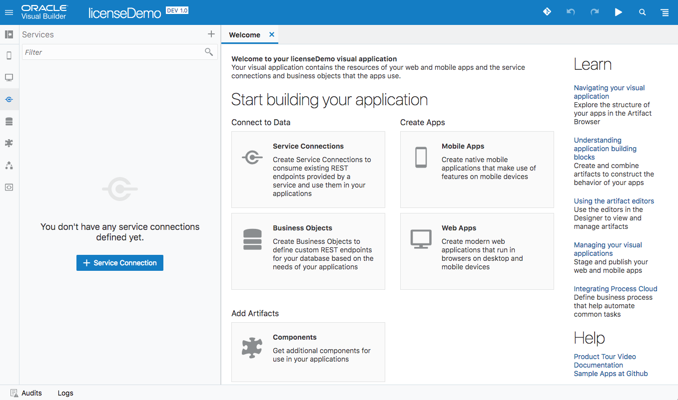

We start by defining a new Service Connection:

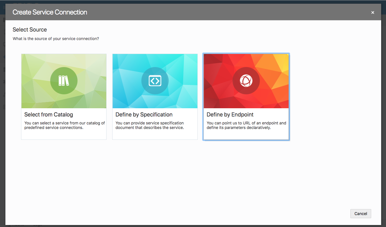

Choose Define By Endpoint:

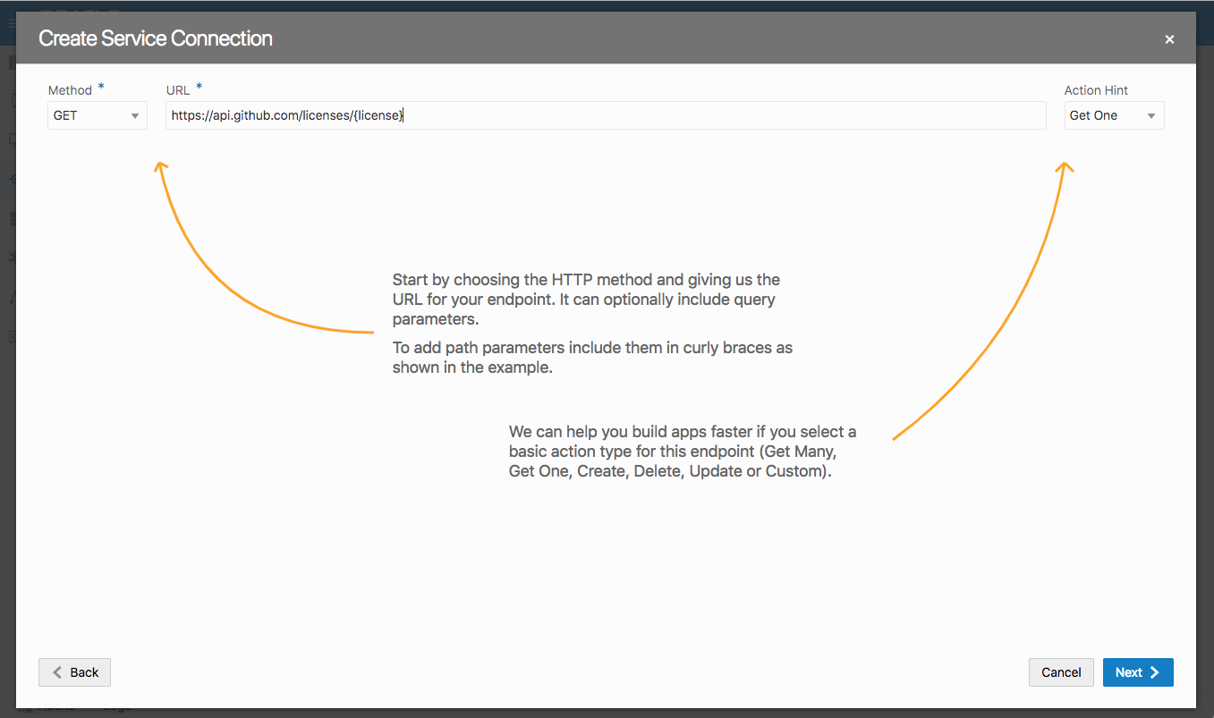

And define the service + endpoint:
And press Next:

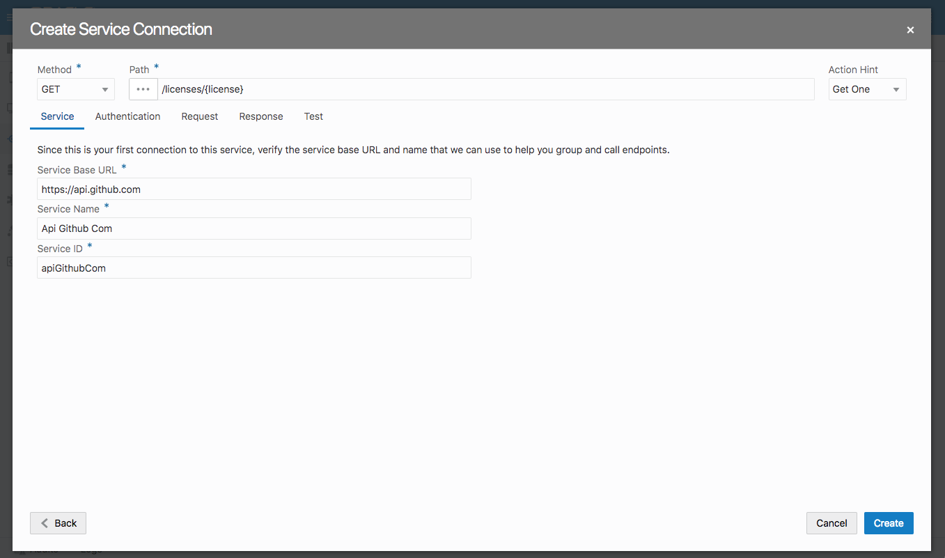

Here of course we would usually define the authentication as well, however, in this simple example we can skip that. However, do pay attention to the Service ID field. You will need this ID later when you come to call the service. You can change the value of you wish or use the default ID as generated. I’ll use the default value of apiGithubCom here.

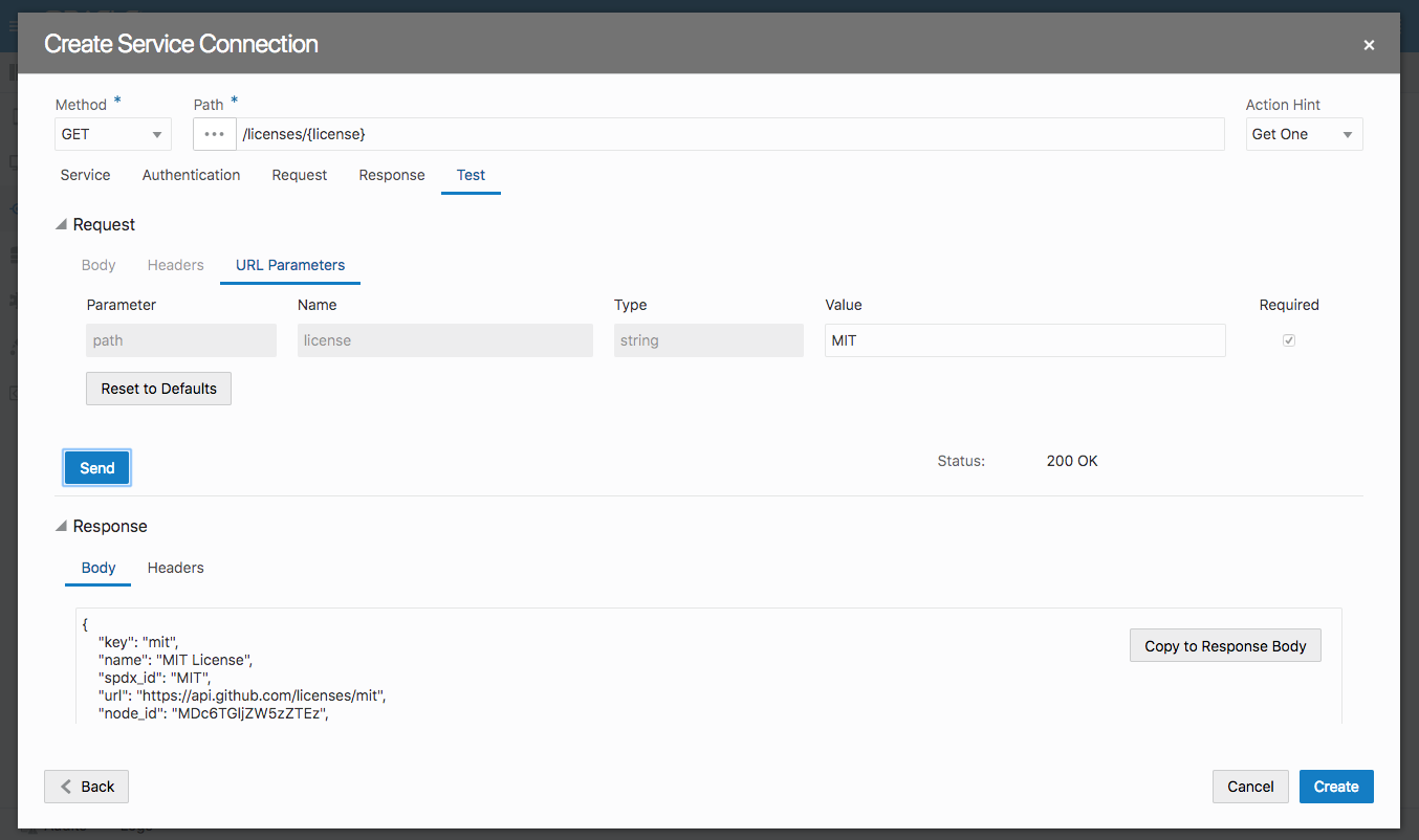

Next we go the the Test tab and make sure that we’re getting the data we expect with an example license e.g. MIT:
At this point we press the Copy to Response Body button to describe the basic shape of the response payload and we’re done so we can press the Create button.

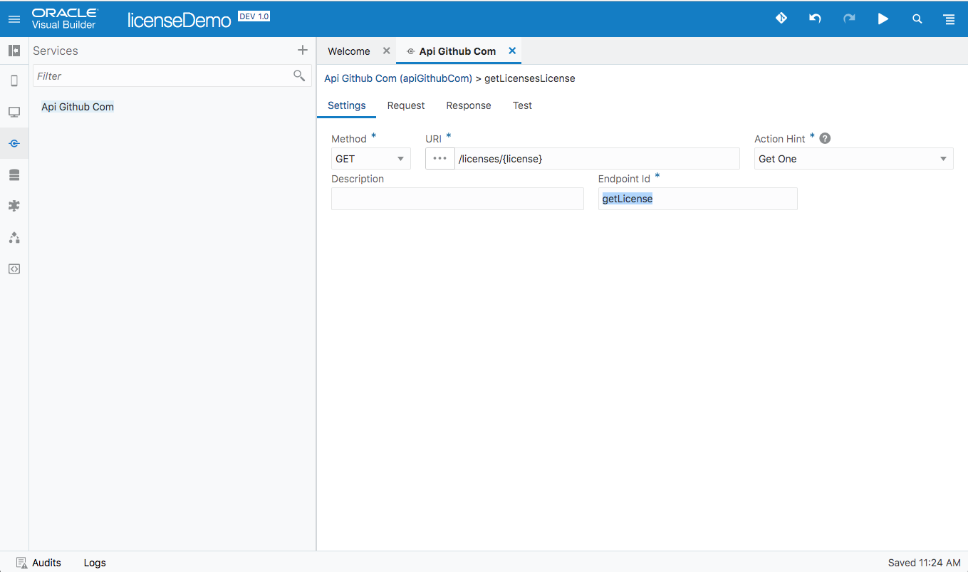

Once the create is done, re-select the service and endpoint and make a note of the Endpoint ID as shown here. Again you can change this if you wish and I’ve updated mine from the default value of “getLicensesLicense” to the more readable value of getLicense.
