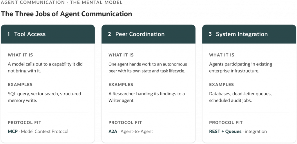

Agent communication isn’t just one problem. It involves tool access, peer coordination, and system integration. Each area needs its own solution.
Tool access occurs when a model needs to use a capability it lacks, like a SQL query or memory write. The Model Context Protocol (MCP) addresses this need. It’s often the first task for production agent systems.
Peer coordination happens when one agent assigns work to another. This isn’t just a function call; it’s a task with its own state and lifecycle. The second agent may work independently on this task. The Agent-to-Agent protocol (A2A) supports this, solving problems that the tool-call model can’t handle well.
System integration involves agents interacting with your broader infrastructure—databases, queues, services, scheduled jobs, and audit pipelines. For two decades, REST, message queues, and event buses have managed this. Often, the simplest solution is the best.

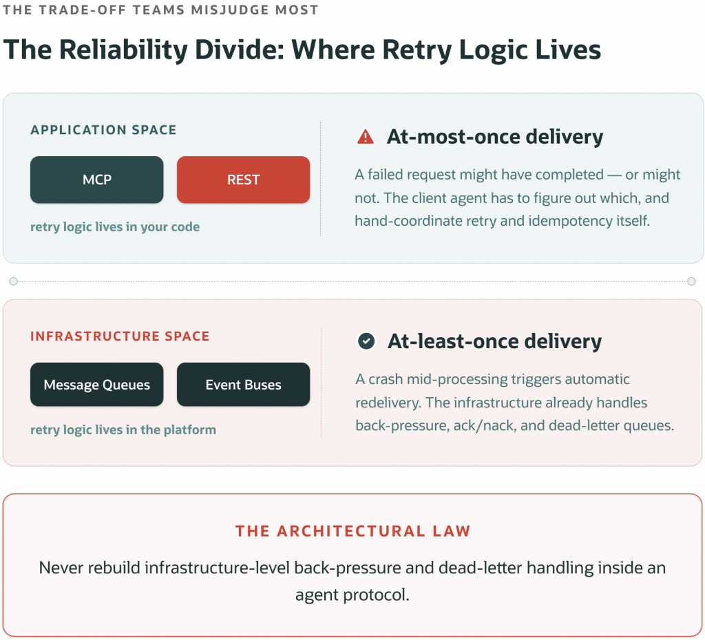

The reliability column is the most important trade-off in the matrix. Teams often misjudge it.
Comparison of reliability models. Application-layer protocols such as MCP and REST provide at-most-once delivery and require retry logic in application code. Infrastructure services such as message queues and event buses provide at-least-once delivery with built-in retries, acknowledgments, back-pressure handling, and dead-letter queues. The diagram advises keeping infrastructure reliability concerns in the platform layer.
Application versus infrastructure responsibility for reliability, retries, and message delivery.
At-most-once delivery, common in HTTP protocols like MCP and REST, means that a failed request might have been completed or not. This leaves the client uncertain.
At-least-once delivery, typical for queues and event buses, ensures a message is processed at least once. However, it might be processed more than once if a worker crashes. Here, idempotency becomes the app’s responsibility.
Neither approach is better than the other. The key question is where you want retry logic: in your application code (HTTP) or in your infrastructure (queues).
Pattern 3 suggests that for certain agent tasks, placing retry logic in the infrastructure is better.

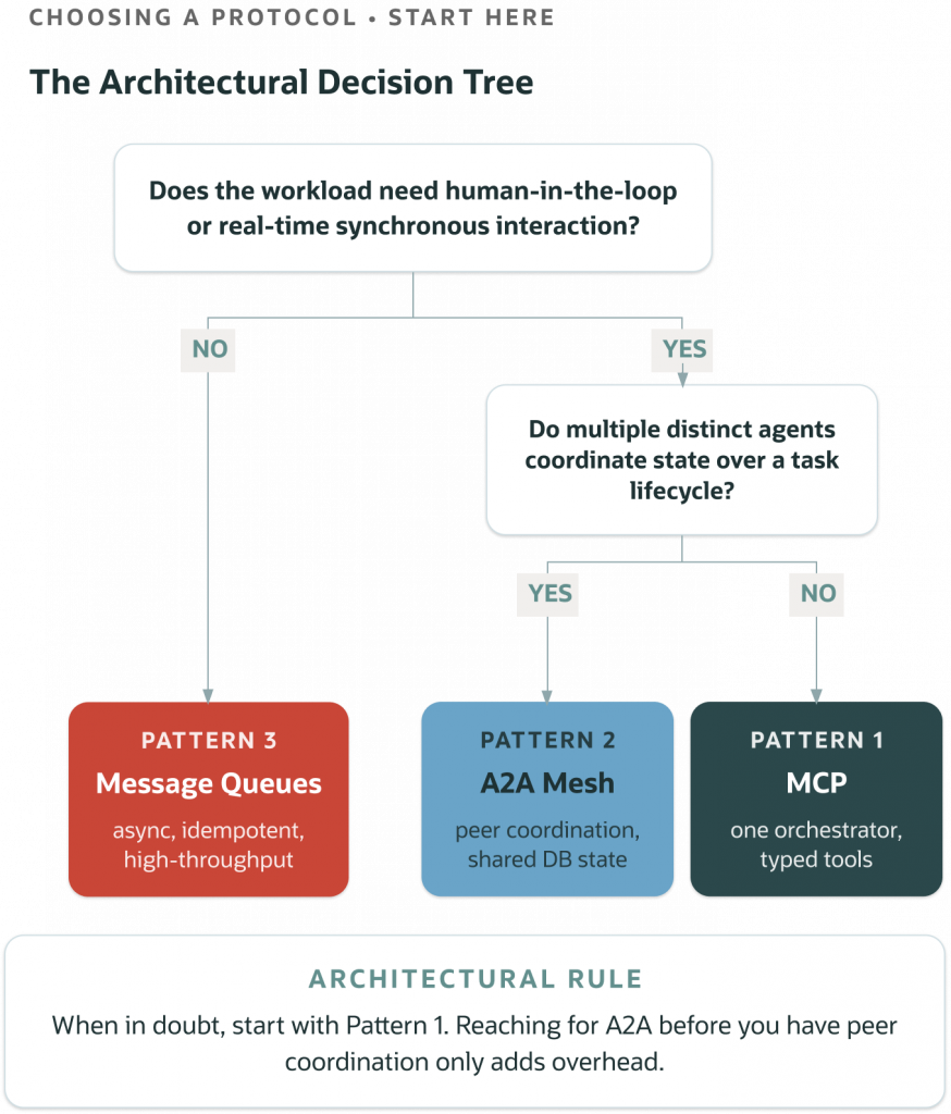

The matrix doesn’t choose a protocol for you. It shows what you’re trading.
Decision tree for selecting an agent communication pattern. If a workload does not require real-time or human-in-the-loop interaction, use message queues. If it does, determine whether multiple agents coordinate shared state. Coordinated agents use an A2A mesh, while a single orchestrator uses MCP. A note recommends starting with MCP unless peer coordination is required.
Decision tree for choosing between MCP, A2A, and message-queue architectures.

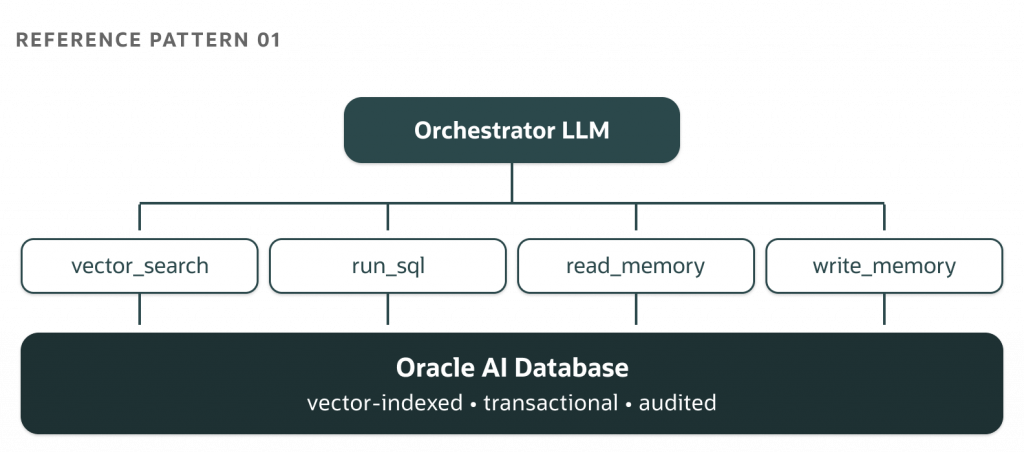

Pattern 1: MCP-Centric Tool Access
Diagram showing a single-agent architecture. An Orchestrator LLM accesses Oracle AI Database through four tools: vector search, SQL queries, memory reads, and memory writes. Oracle AI Database serves as the shared backend for vector-indexed, transactional, and audited data access.
Single-agent orchestration pattern using Oracle AI Database for retrieval, transactions, and memory.
Spec: Model Context Protocol specification, Anthropic (2024)
This is the pattern for production agent systems: a single LLM orchestrator, one or more MCP servers, and a typed contract between them. The model doesn’t call your database directly. Instead, it uses a tool that interacts with it, and this difference is important.
MCP excels at the discovery layer. When an MCP client connects to a server, it sends a tools/list request. In return, it receives the full schema of available capabilities: names, parameters, descriptions, and return types. The model sees this inventory before acting. Selecting tools becomes a reasoning step rather than a hardcoded choice. This is a significant change. A model with discoverable tools handles “I don’t know how to do that” better than one with fixed function calls. The lack of a tool provides useful information for the model to reason about.
Oracle AI Database serves well as the MCP server. The capabilities you want to expose to an agent—like vector search over embedded content, parameterized SQL against business tables, and structured memory reads and writes—fit perfectly with MCP’s tool model. A typical Oracle-backed MCP server offers four or five tools: vector_search, run_sql, read_memory, write_memory, and summarize_thread. Each is a small, focused function with a typed schema. The model chooses among them based on the task.
The code below shows the minimal version: an MCP server registering one tool that performs vector search against Oracle AI Database. Note the typed array.array("f", ... ) bind for the vector column; a plain Python list will not work. The full server, with authentication, retries, and the other four tools, is in the companion repo.

Here are a few key points about what’s happening here. The tool schema acts as a contract. The model views vector_search as a typed capability. It requires a query string and allows an optional integer k. This info helps the model decide when and how to use it.
The Oracle AI Database vector search executes as a single SQL statement on a VECTOR column. It uses a cosine-distance HNSW index. There’s no separate vector store, no sync job, and no eventual-consistency window.
The embed() call is left out here for clarity. In the repo, it connects to a local Ollama model. (This setup allows the demo to run without needing paid API keys).
In tests with the demo corpus (1,000 chunks using 768-dimensional embeddings via Ollama’s nomic-embed-text on a GPU workstation), median tool-call round-trip latency is 15.3ms. This includes 14.1ms for embedding inference and 0.9ms for Oracle vector search. On CPU-only hardware, the embedding step is usually 5 to 20 times slower, but the database side remains constant. Remember this key point: an MCP tool call to an Oracle-backed server is fast like a database, not like an LLM. The latency during an agent turn mainly relies on the model’s own inference, not the tool.
Recommended usage: Use one orchestrator agent with various specialized tools. Teams should standardize access across different agent frameworks or model providers. This setup works best when the typed schema improves model behavior, which is often true. MCP is ideal if you plan to add tools later. The discovery layer allows new capabilities to integrate with the model without changes on the client side.
When not to use this: Avoid having a single agent for just one tool. Don’t add a protocol if a function call is enough. If your “agent” is simply one model with a clear capability, an MCP server adds extra complexity. The discovery layer is helpful when there’s something to find; with only one tool, there’s nothing to discover.

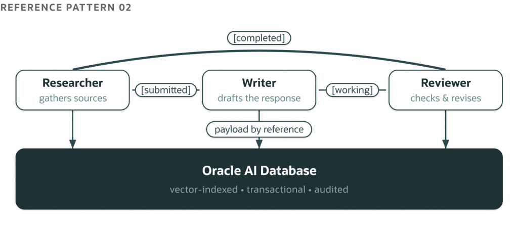

Pattern 2: A2A Mesh with Oracle Memory
Diagram showing a multi-agent workflow with Researcher, Writer, and Reviewer agents. The Researcher gathers sources, the Writer drafts content, and the Reviewer validates and revises it. Agent state and payloads are stored in Oracle AI Database, which provides vector-indexed, transactional, and audited persistence across the workflow.
Multi-agent collaboration pattern with shared state stored in Oracle AI Database.
Spec: Agent-to-Agent Protocol specification, Google (2025)
A2A solves a problem MCP doesn’t: what happens when an agent isn’t calling a tool but handing work to another agent. The distinction sounds semantic until you try to express “the Researcher has finished gathering sources; the Writer should now draft a response using them” as a tool call. It doesn’t fit. The Writer isn’t a function the Researcher invokes. It’s a peer with its own model, its own prompt, its own lifecycle. A2A models that relationship as a task with state, addressable identity, and a status machine that both sides observe.
Consider a two-agent research workflow. A Researcher agent gathers context from external sources, checks relevance, and produces findings. A Writer agent then uses those findings to draft a response in the desired tone and format. A simple setup would have the Researcher return findings directly as a response to a tool call. This works for two agents but fails with three. When a third agent, like a Reviewer, needs the same findings, you end up duplicating data in message history instead of having a central record.
The A2A pattern changes this. Findings are stored in the Oracle AI Database as durable, vector-indexed rows. The Researcher writes them and sends a task message to the Writer with a reference to the findings, not the data itself. The Writer reads from the same table. This protocol ensures coordination, while the database holds the state. Multiple agents can access the same information without the protocol layer needing to see the contents.
The code below is one half of the mesh: the Writer agent’s task handler, listening for task.created events from the Researcher and producing a draft. The Researcher side, plus the full A2A envelope with retries and status updates, lives in the companion repo.
import asyncio, oracledb, os
from a2a.server import A2AServer
from a2a.types import Task, TaskStatus, Message
pool = oracledb.create_pool(user=os.environ["DB_USER"],
                            password=os.environ["DB_PASS"],
                            dsn=os.environ["DB_DSN"], min=1, max=4)
writer = A2AServer(agent_id="writer-v1")
@writer.on_task("draft_response")
async def handle_draft(task: Task) -> Message:
    # The Researcher passed a memory_id, not the findings themselves.
    memory_id = task.payload["memory_id"]
    with pool.acquire() as conn, conn.cursor() as cur:
        cur.execute("SELECT findings, source_refs FROM agent_memory WHERE id = :id",
                    id=memory_id)
        findings, sources = cur.fetchone()
    await writer.update_status(task.id, TaskStatus.WORKING)
    draft = await llm_draft(findings, sources, tone=task.payload["tone"])
    cur.execute("UPDATE agent_memory SET draft = :d WHERE id = :id", d=draft, id=memory_id)
    return Message(role="agent", content=draft, refs={"memory_id": memory_id})
A few things in that snippet do the load-bearing work. The Writer never receives the findings in the message. It receives a memory_id and reads the actual content from Oracle. That’s the payload-by-reference pattern, and it’s the core architectural move of this pattern. The update_status call tells the Researcher (and any observer subscribed to the task) that work has begun; A2A’s status machine handles the streaming update without the Writer having to manage its own connection lifecycle. The final Message returns the draft inline because it’s the artifact of the task, but it also includes the memory_id ref, so a third agent picking this up next reads the same memory rather than re-deserializing a payload.
The trade-off is clear in token counts. In the demo, using serialized findings in the message costs 1,394 tokens per Writer turn for 3KB of research. This size is typical for a research agent creating a synthesized summary with source references.
In contrast, the payload-by-reference version only costs 61 tokens, no matter the findings’ size. This means a 22.9 times reduction at 3KB. The difference grows with findings size: at 500 characters, the reduction is 5.6 times; at 8KB, it reaches 58.9 times. The ratio isn’t fixed; it depends on how much data is in the message versus in the database. (Tokens counted using OpenAI’s cl100k_base tokenizer; Anthropic and Google tokenizers yield similar counts for English text.)
The compounding effect is more important than any single hop. A three-agent mesh sharing the same research context across two handoffs costs about 4,000 tokens in the naive version. In the payload-by-reference version, it costs only 183 tokens. At five hops, the difference exceeds 6,500 tokens per request. This is before any agent has done actual reasoning work. The cost of “just put it in the message” increases linearly with mesh depth. Most mesh topologies grow over time, not the other way around.
Oracle AI Database plays a key role here. The agent_memory table serves as a single source of truth. It is vector-indexed for semantic recall and transactional for consistency between reads and writes. Each row includes the agent ID, making it audit-friendly. The protocol layer can be A2A today and something else tomorrow. However, the memory layer stays the same.
Recommended usage: Use multi-agent workflows that need peer coordination, like planner-and-specialist patterns or multi-step research pipelines. This applies when multiple agents require consistent access to the same conversational or task state. A2A is ideal for long-running tasks where a synchronous request/response model would keep connections open unnecessarily.
When not to use this: Avoid A2A for one agent with a set of tools. This is an MCP problem, not an A2A issue. Using A2A with a single orchestrator adds unnecessary task lifecycle management. A good test: if you can name a second agent and explain its independent decisions, A2A works. If the “second agent” is just a different prompt using the same model, it’s a tool call.

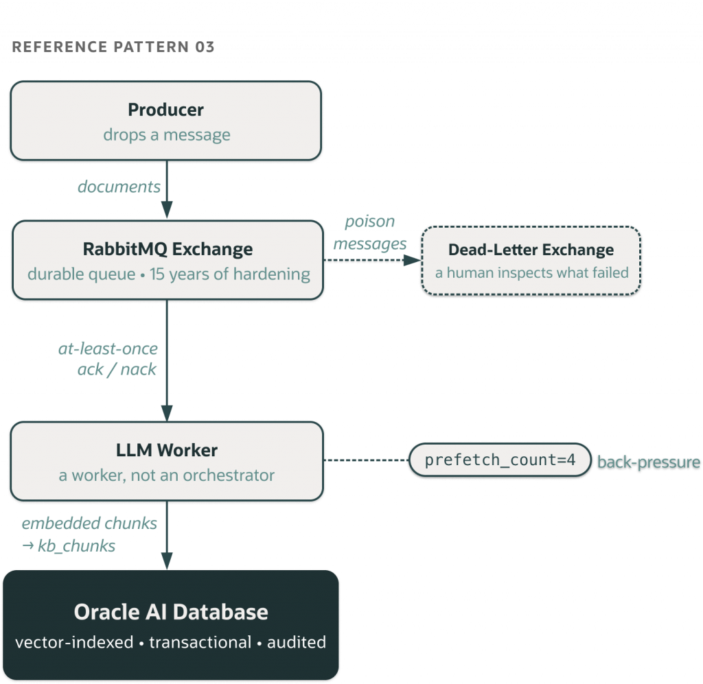

Pattern 3: Queue-Backed Backoffice Agents
Diagram showing an asynchronous processing pattern. A producer publishes messages to a RabbitMQ exchange, which delivers work to an LLM worker. Failed messages are routed to a dead-letter exchange for inspection. The worker writes processed results into Oracle AI Database and uses queue features such as acknowledgments, retries, and back-pressure management.
Message-driven AI workflow using RabbitMQ and Oracle AI Database.
Imagine a document-processing pipeline. PDFs arrive in a queue. A worker agent picks them up, extracts text, embeds chunks, and writes them to the Oracle AI Database with vector indexing. It then shows results through a simple FastAPI endpoint. No MCP. No A2A. This is key. Adding either would increase the surface area without enhancing capability.
This pattern resists the pull of new protocols. The urge to add MCP just because there’s an LLM involved somewhere is strong but should be resisted. A worker using the same embedding model and prompt for each message doesn’t need tool discovery. It needs at-least-once delivery, a dead-letter queue, and back-pressure for when the embedding service slows down. These are queue issues, not agent-protocol issues.
The architectural shape predates the agent era, which is key to its function. Producers send messages to a queue. Workers process them at their own pace. If messages fail, they retry with exponential backoff and go to a dead-letter queue if they keep failing. The LLM acts as a worker in the pipeline, not as its orchestrator. This means the protocol layer above the LLM is as straightforward as the rest of the system, and that’s a benefit.
The code below is the worker’s core loop: consume a message, embed the chunks, write to Oracle AI Database, acknowledge. Producer, dead-letter handling, and the FastAPI edge live in the companion repo.
import array, json, oracledb, pika, os
from embed import embed_chunks  # local Ollama call, see repo
conn = pika.BlockingConnection(pika.URLParameters(os.environ["AMQP_URL"]))
ch = conn.channel()
ch.queue_declare(queue="documents", durable=True,
                 arguments={"x-dead-letter-exchange": "documents.dlx"})
ch.basic_qos(prefetch_count=4)  # back-pressure: at most 4 in-flight per worker
def handle(ch, method, _props, body):
    doc = json.loads(body)
    chunks = doc["chunks"]                          # already segmented upstream
    vectors = [array.array("f", v) for v in embed_chunks(chunks)]
    with pool.acquire() as db, db.cursor() as cur:
        cur.executemany("""
            INSERT INTO kb_chunks (doc_id, chunk_text, embedding)
            VALUES (:doc, :txt, :vec)
        """, [(doc["id"], t, v) for t, v in zip(chunks, vectors)])
        db.commit()
    ch.basic_ack(delivery_tag=method.delivery_tag)
ch.basic_consume(queue="documents", on_message_callback=handle)
ch.start_consuming()
The interesting parts are what isn’t there. There’s no tool schema, no agent identity, and no status state machine. The worker doesn’t need to show its capabilities because nothing is looking for it. The contract is the queue’s message schema, enforced by the producer’s chosen validation. The prefetch_count=4 setting tells the whole back-pressure story. If the embedding service slows down or Oracle’s connection pool fills up, messages stay on the queue instead of piling up in worker memory. The DLX (dead-letter exchange) on the queue means any message that fails repeatedly goes to a place where a human can check it, without the producer or any other agent needing to know.
Reliability semantics play a crucial role here. RabbitMQ provides at-least-once delivery with ack/nack semantics. This means if a worker crashes during processing, the message is sent to another worker. You don’t need application-level retry logic. In contrast, achieving the same reliability with an MCP server involves manually writing idempotency keys, retry coordination, and ordering logic. The queue handles this for you, and “for free.” RabbitMQ has been improving these semantics since 2007. You’re not going to outdo that on a side project.
The Oracle integration mirrors Patterns 1 and 2: it’s durable, vector-indexed, and transactional. The worker writes embedded chunks into the same kb_chunks table that Pattern 1’s MCP vector_search tool reads from. Teams using Oracle Database can merge the queue and memory layer into one component with Oracle Advanced Queuing. The trade-off is one less service to manage, but with slightly less portable demo code. This is the architectural benefit of the three-pattern arc: while the protocol layer changes (MCP, A2A, none), the memory layer remains constant. A document processed by Pattern 3’s queue worker is instantly searchable by Pattern 1’s MCP tool and can be referenced by Pattern 2’s A2A peers. This isn’t a coincidence; it reflects the efficiency gained when each protocol performs its best role, with Oracle AI Database maintaining the shared state for all three patterns.
Recommended usage: Use this for asynchronous, idempotent, and throughput-sensitive tasks. Examples include document processing, batch embedding, ETL pipelines, scheduled report generation, and back-office automation. Here, the LLM acts as a worker, not an orchestrator. This pattern is ideal when you need to manage slow or temporarily down downstream services. Queues can handle those issues without the application noticing.
When not to use this: Avoid it for real-time, conversational, or human-in-the-loop tasks. Don’t place a queue between a user and a chatbot. It’s not suitable when latency is more critical than throughput, especially when users expect quick answers. The conversational loop fits in Patterns 1 or 2, while Pattern 3 works behind them, tackling non-interactive tasks.
