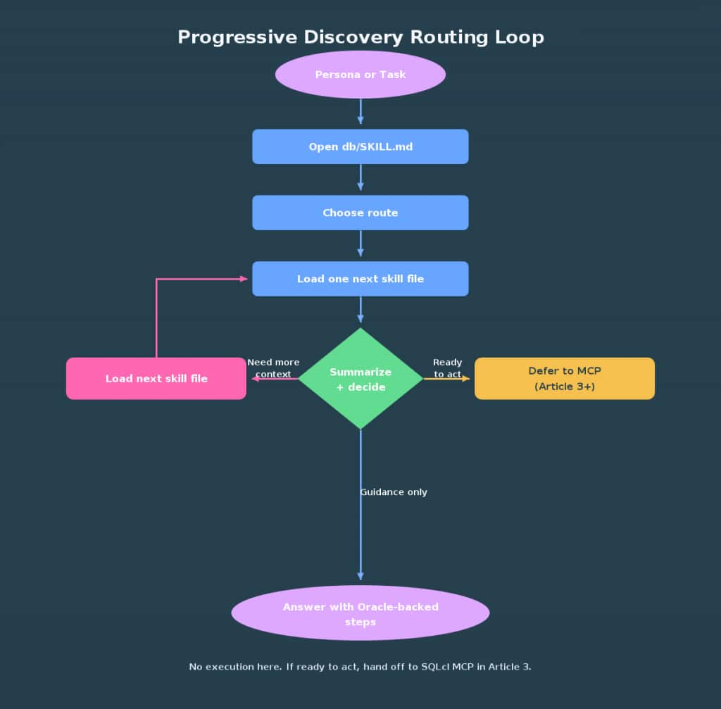

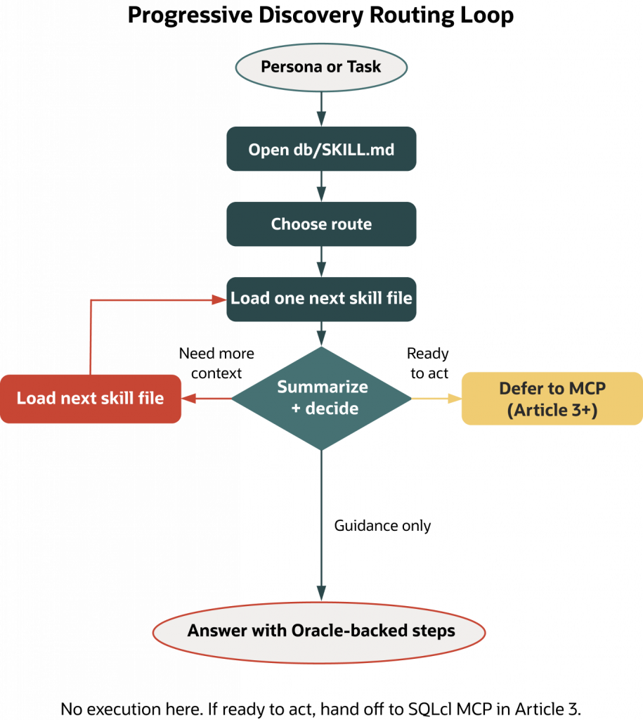

A compact prompt that enforces progressive discovery
A small prompt can prevent freelancing by enforcing a loop: route, read one file, summarize, decide. That discipline keeps the context precise and affordable.
Prompt
Open db/SKILL.md. I’m [persona or task].
Which single skill file should I load next, and why?
Summarize that file in 5 bullets, then propose the next decision (read another file or stop).
Do not execute any actions.
Flowchart showing Oracle skill routing logic. A persona or task opens db/SKILL.md, chooses a route, and loads one skill file at a time. A decision step summarizes results and determines whether to load another skill file, defer to MCP for advanced actions, or answer directly with Oracle-backed steps.
Oracle skill routing workflow for iterative reasoning, MCP escalation, and Oracle-backed responses
