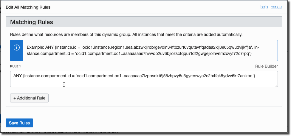

To work with OSMS, you must first create a dynamic group that will apply to the instances that you would like to manage. I find it easiest to create the dynamic group at the compartment level, and make sure that all my instances that I intend to be managed by OSMS reside within that compartment, but you can create your dynamic group with whatever rules make sense. Read more about dynamic groups here. Here's what my dynamic group rule looks like:

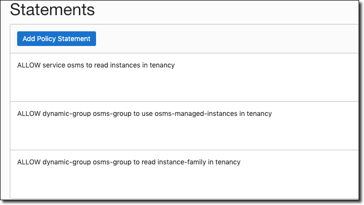

Next, you'll need to apply a few policies to the dynamic group we just created.
The first policy above is required if you would like to emit metrics from OSMS.
Note: If you do not create the policies above, you will be unable to manage your instances with OSMS!

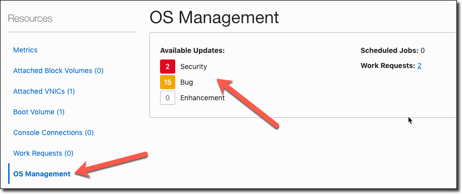

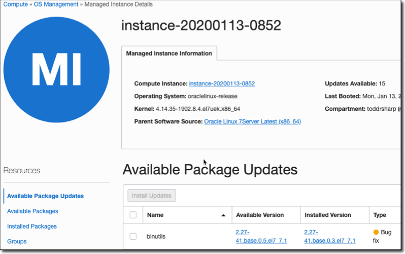

After the agent has been installed on your instance(s) and has been registered with the OSMS service, you're ready to start using OSMS with the instance(s). Visit the details page for any registered instances and click on 'OS Management' in the sidebar.
In this case, you'll see that this instance has 2 security updates and 15 bug fix related updates available for install.
View Managed Instance Details

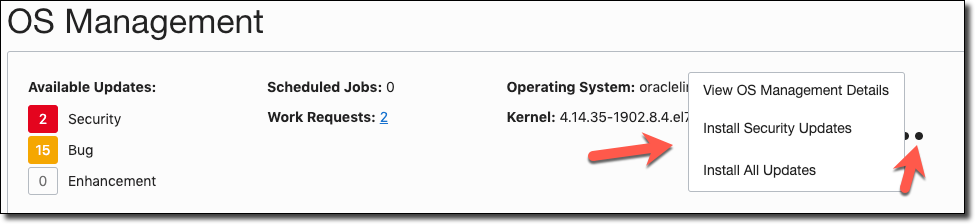

If you hover over the three dots in the OS Management tab of the compute instance details page, you'll see some options to take further action. You can immediately choose to install the available updates, but for now click on 'View OS Management Details':
View OS Management details for the instance:

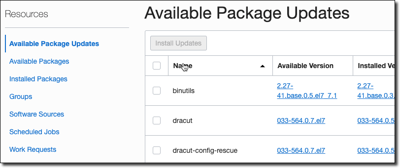

From the managed instance details page, you can view a ton of information about the software installed and available for your instance. You can view available package updates for existing, installed software:

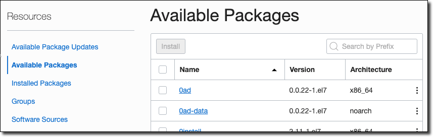

View available packages (that are not yet installed), search for and install them:

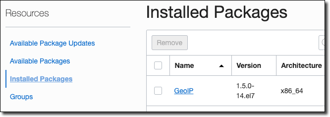

View all installed packages:

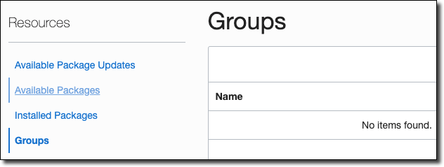

View the managed instance groups that the instance belongs to:

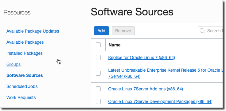

View the software sources that the instance has available to it:

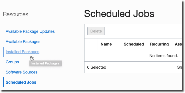

View scheduled jobs:

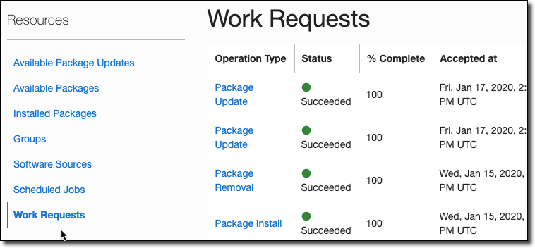

View work request history:

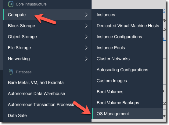

If you have multiple OSMS managed instances that have the same OS release and version, you can make your life much easier by adding each managed instance to a managed instance group so that you can perform bulk operations and schedule updates for all grouped instances instead of managing each individually. To create a managed instance group, click on 'Compute' -> 'OS Management' from the console burger menu.

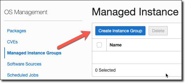

Then select 'Managed Instance Groups' from the sidebar and click on 'Create Instance Group'.

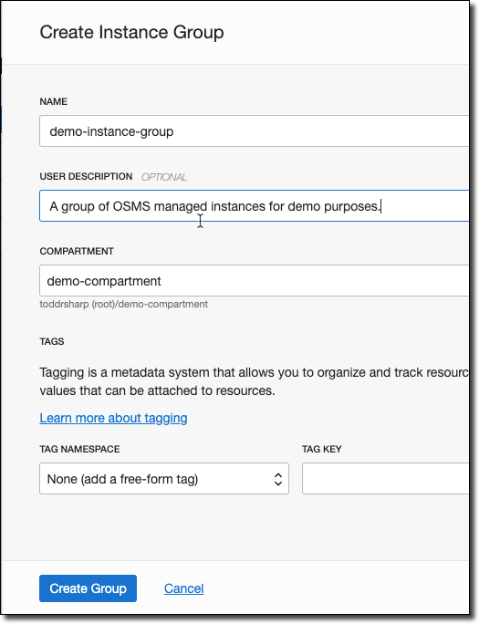

Provide details for the group, and click 'Create Group'.

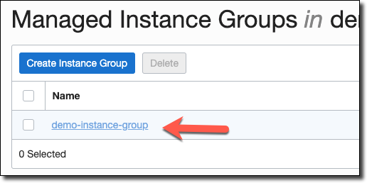

Once the group has been created, click on the group name to go to the group details page:

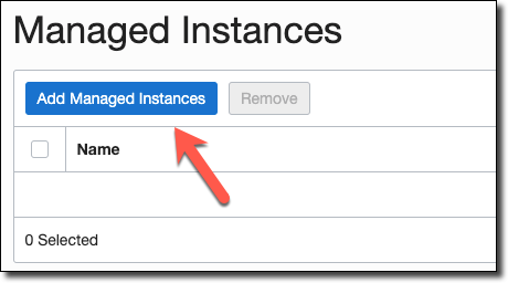

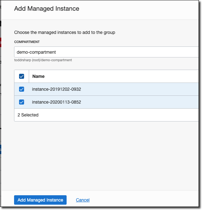

On the group details page, click 'Add Managed Instances'.
In the dialog that appears, all of the available managed instances in the chosen compartment are listed. Select the instances that you'd like to add to the group and click 'Add Managed Instance'.

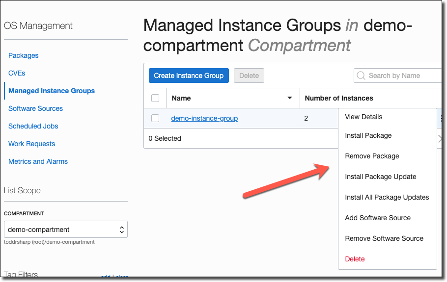

At this point, your group is ready to be managed. Head back to the 'Managed Instance Groups' list page and click on the three dots in the row of the group you're interested in working with and you'll see many options for bulk operations on all instances within the group:
Installing Packages

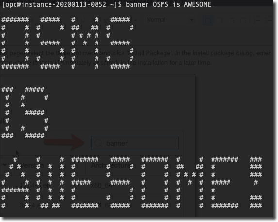

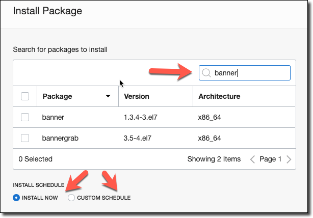

From the managed instance group list page, select the three-dot menu and click 'Install Package'. In the install package dialog, enter a search term and click 'enter' to search for a package. You can choose to install immediately or schedule the installation for a later time.
You can see here that the package 'banner' is not installed in the instance before the installation:
But after clicking 'install' to install this package in the group the package becomes available within the instance:

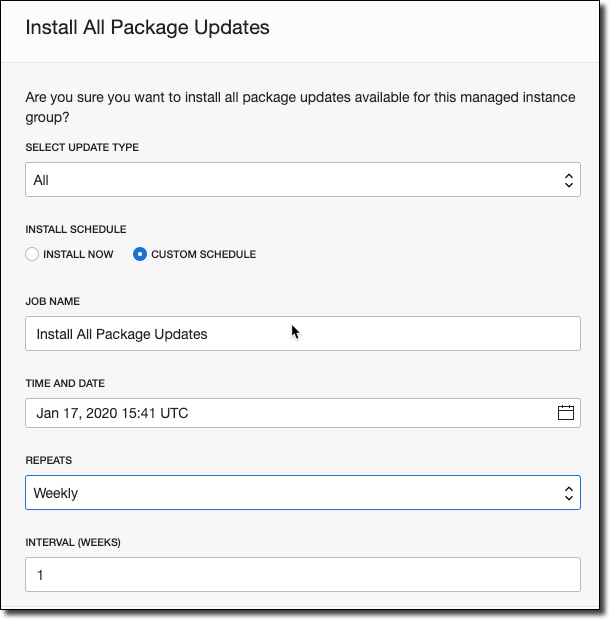

From the managed instance group list page, select the three-dot menu and click 'Install Package Updates' or 'Install All Package Updates'. From this dialog you can update your packages on-demand, or more likely create a scheduled job to make sure that all instances in the group are up to date on a daily/weekly/monthly basis.
