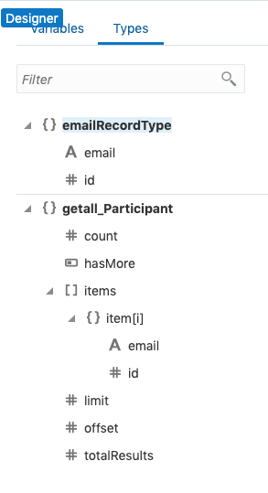

Step 1 – Defining Types
To keep your code readable and maintainable, I strongly encourage  the liberal use of well defined types to make mapping clearer and less error prone.  For my use case, the Participant Business object exposes a GET many endPoint for which we’ll want to generate a type, and I’ll also create a simple object for the array row type called emailRecordType:

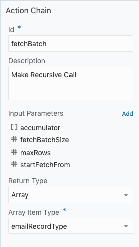

Step 3 – Define the API for the Recursive Action Chain
As the title of the article mentioned, the process of making multiple calls to the endpoint to get all the rows will be managed through recursion, e.g. I’ll have an action chain that will call itself, essentially looping until all the rows (or some max number of rows) have been obtained.  So the first part of this will be to define the API for that Action Chain in terms of the inputs to it and the data that it will return.
So I create a new Action Chain called fetchBatch and define input parameters and a return type as follows:
Some details on each of those input parameters:
  • accumulator – this will be used to pass the set of data pulled from the endpoint to the next iteration of the loop / recursion.  It has a default value of an empty array ([])
  • fetchBatchSize – is a number input which can be used to define how many rows to get from the endpoint on each iteration.  I’ve defaulted it to 25, but you can set that to whatever works best for your use case.
  • maxRows – is a number defining an approximate maximum number of rows you want to get before stopping. This is just a bit of a safety net and optional.  I’ve set it to a default value of 1000.
  • startFetchFrom – is a number defining where to start a given iteration from. This value will increment by the fetchBatchSize as we go through each iteration.  The default is 0 (zero) as we want to start at the beginning!
The return type for the Action Chain is again an array of the emailRecordType I defined in step 1.

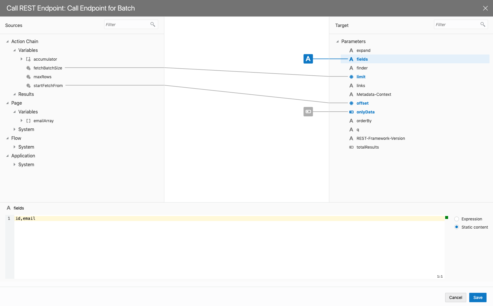

Now we need to implement the Action Chain and the first step is the actual call to get a batch of records.  To do this. we just drop a Call REST Endpoint action into the flow and wire that to the endpoint that I’m getting the data from:
And let’s look at that assignment mapping in more detail:
You can see here that the fetchBatchSize and the startFetchFrom input parameters are mapped to the limit and offset parameters on the REST call. In this case I’ve also set onlyData (to true) and the fields that I want in the return payload to optimize things a little, but that’s optional.
The return type for the REST action is the getall_Participant type that was set up in step 1.

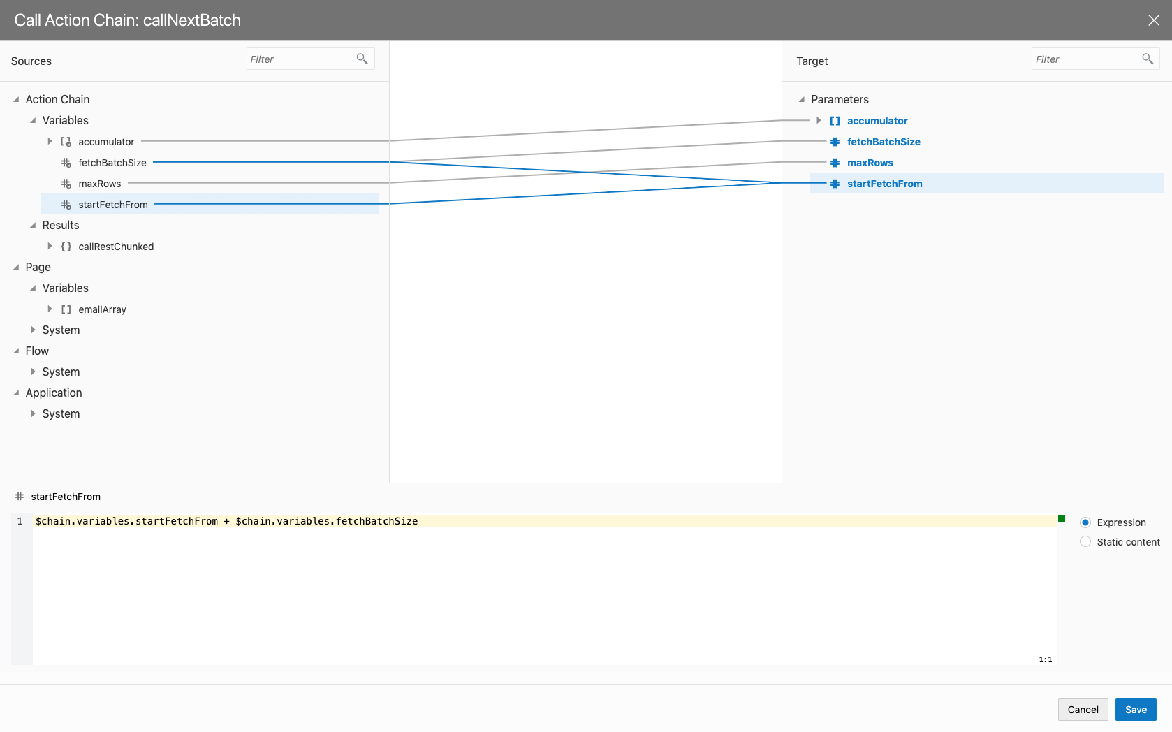

If the recursion check passes then this is the point at which we need to recursively call the same action chain. To do this, we drop a Call Action Chain action in and map it to use this same chain.  The important part of course is is the mapping of the parameters:
It’s all pretty simple 1-1 mapping except for the value passed into startFetchFrom which of course needs the incremented fetch starting position which we can calculate as shown here by just adding the batch size to the previous start point.

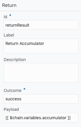

Step 9 – Return the Result
With that we’re all done. All we need to do now is return the accumulator array to the caller, so we drop a return action in and do so:

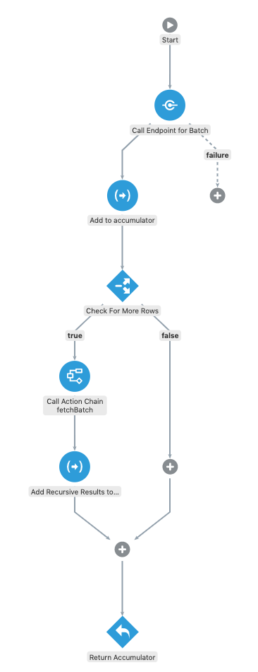

And here’s an overview of the whole chain that has just been defined:

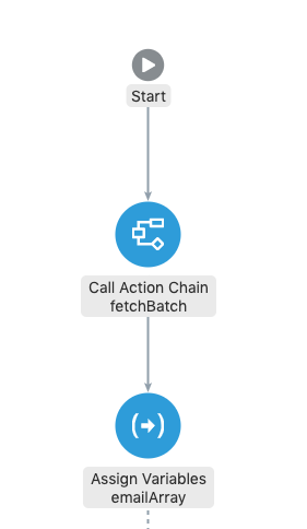

Once this chain is defined you can then just call it from your desired action chain and the recursion will take care of the rest., for example:
