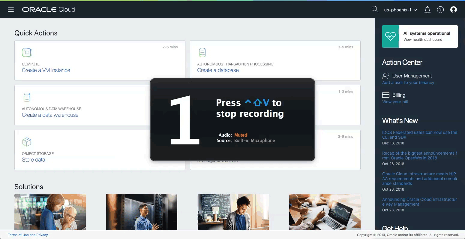

Before getting started you’ll need to configure your Oracle Cloud tenancy.  If you’re in the Limited Availability trial, make sure your tenancy is subscribed to the Phoenix region because that’s currently the only region where Oracle Functions is available.  To check and/or subscribe to this region, see the following GIF:

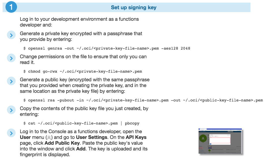

Next, create a signing key.  I’ll borrow from the quick start guide here:
If you’d rather skip heading to the console UI in the final step, you can use the OCI CLI to upload your key like so:
oci iam user api-key upload --user-id ocid1.user.oc1..[redacted]ra --key-file <path-to-key-file> --region <home-region>
Next, open your OCI CLI config file (~/.oci/config) in a text editor, paste the profile section that was generated in the script above and populate it with the values from your new signing key.
