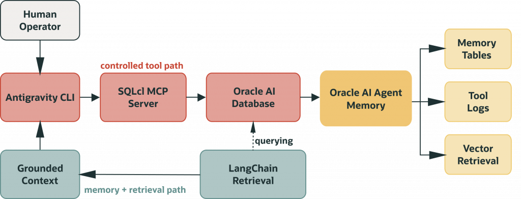

A human operator sends requests through Antigravity CLI and SQLcl MCP Server to Oracle AI Database, which connects to Oracle AI Agent Memory. Memory tables, tool logs, and vector retrieval branch from memory, while LangChain Retrieval returns grounded context.
Controlled Antigravity MCP + Oracle AI Database Workflow

The workflow has five cooperating layers. Antigravity is the developer-facing agent interface. SQLcl MCP is the tool boundary. Oracle AI Database is the durable substrate for memory, traces, and retrieval. Oracle AI Agent Memory is the application-side memory API. LangChain is the optional orchestration wrapper. The companion notebook sits outside all five, as the build-and-validation harness that proves the pieces are wired correctly before the workflow is handed to Antigravity.
LayerResponsibility
Antigravity Developer-facing MCP client and agent interface.
SQLcl MCP Exposes declared Oracle tools to Antigravity; it is the tool boundary.
Oracle AI Database Stores durable data, retrieval evidence, vectors, metadata, traces, and enforces database privileges.
Oracle AI Agent Memory Provides application APIs for users, agents, threads, durable memories, scoped retrieval, and context assembly.
LangChain Wraps Oracle-backed retrieval results as Document objects and supports application-side orchestration.

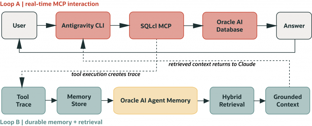

The Two Execution Loops
The system naturally forms two execution loops:
  • Loop A: Antigravity works with MCP to discover tools, inspect data, run bounded read-only queries, and return results immediately.
  • Loop B: Application code writes history, tool logs, memory records, chunks, and embeddings to Oracle AI Database, then retrieves context before a later answer or workflow step.
Loop A routes a user request through Antigravity CLI, SQLcl MCP, and Oracle AI Database to an answer. Loop B records a tool trace in Memory Store, passes it through Oracle AI Agent Memory and Hybrid Retrieval, and returns grounded context to Claude.
Dual Execution Loop: MCP Interaction and Durable Memory
SQLcl MCP handles live tool use. Oracle AI Agent Memory handles durable memory and scoped recall. Most production setups need both loops, but they solve different problems.

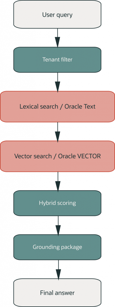

The notebook combines lexical search, vector search, and hybrid search so retrieved context can include both exact operational terms and semantic matches.
The grounding package also returns visible evidence before the assistant answer is assembled:
Status: READY
Top evidence:
- Saved SQLcl connections for MCP
- SQLcl MCP execution boundary
- Tool logging baseline
- LangChain as orchestration glue
If retrieval is empty or too weak, the notebook returns INSUFFICIENT_CONTEXT and displays a safe empty-result message instead of trying to select columns from missing evidence.

A user query passes through a tenant filter, Lexical search using Oracle Text, Vector search using Oracle VECTOR, Hybrid scoring, and a Grounding package before producing the final answer.
Retrieval pipeline diagram
Where LangChain Adds Value
LangChain should not be treated as the source of truth. Antigravity does not call LangChain directly in this architecture, and LangChain is not the permission boundary, memory store, or audit layer.
In this notebook, LangChain is used as a compatibility layer. The custom Oracle-backed hybrid_search() path performs retrieval, then the results are wrapped as LangChain Document objects so applications that already expect LangChain interfaces can consume them.
By the time LangChain is introduced, the database tables, package memory, retrieval scores, and validation snapshot already exist. LangChain becomes a wrapper around evidence, not a substitute for evidence.
class OracleMemoryRetriever(BaseRetriever):
    def _get_relevant_documents(self, query: str):
        rows = hybrid_search(query, tenant_id="TENANT_A", top_k=3)
        return [
            Document(page_content=row["chunk_text"], metadata={"category": row["category"]})
            for _, row in rows.iterrows()
Use it when the consuming application already expects retrievers, documents, chains, or tool orchestration. If the application only needs direct SQL, package-backed Agent Memory search, or a simple evidence table, the extra abstraction can make debugging harder.
