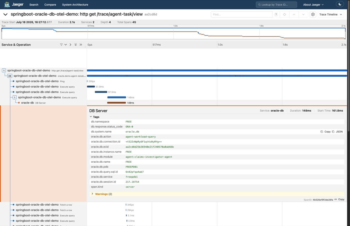

Diagram showing Spring Boot and Oracle JDBC client-side spans and Oracle AI Database server-side spans both exporting to the same OpenTelemetry collector and backend.
Application and JDBC spans flow from the Java process, while database server-side spans flow from Oracle AI Database; both meet in the same OpenTelemetry collector.
Jaeger trace timeline showing Spring Boot and Oracle JDBC spans with an Oracle AI Database DB Server span selected and database-side tags visible.
The selected database server-side span shows database timing and database-side identity tags in the same trace as the application request.

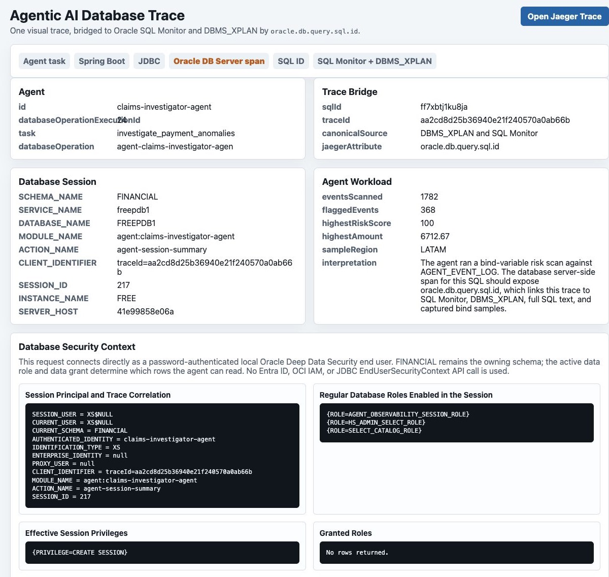

Agentic AI database trace page showing agent task metadata, database session details, trace bridge, SQL runtime statistics, and SQL Monitor information.
The demo page keeps the agent task, database session context, database security context, SQL diagnostics, and trace bridge together.

In Jaeger, the orange oracle-db / DB Server span then carries database-side evidence such as oracle.db.module, oracle.db.action, oracle.db.session.id, oracle.db.pdb, and oracle.db.query.sql.id.
Some of these names can also appear in client-side JDBC spans because the driver can receive database metadata and the application deliberately sets MODULE, ACTION, and CLIENT_IDENTIFIER. The important difference is provenance and timing: the oracle-db / DB Server span is emitted by Oracle AI Database itself, with database-side duration, response status, session context, and SQL identity attached to the server’s view of the work. A client span can time the Java round trip, but it cannot by itself prove the database server’s own span timing in the same trace.

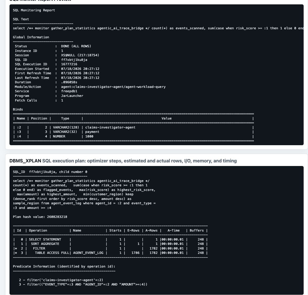

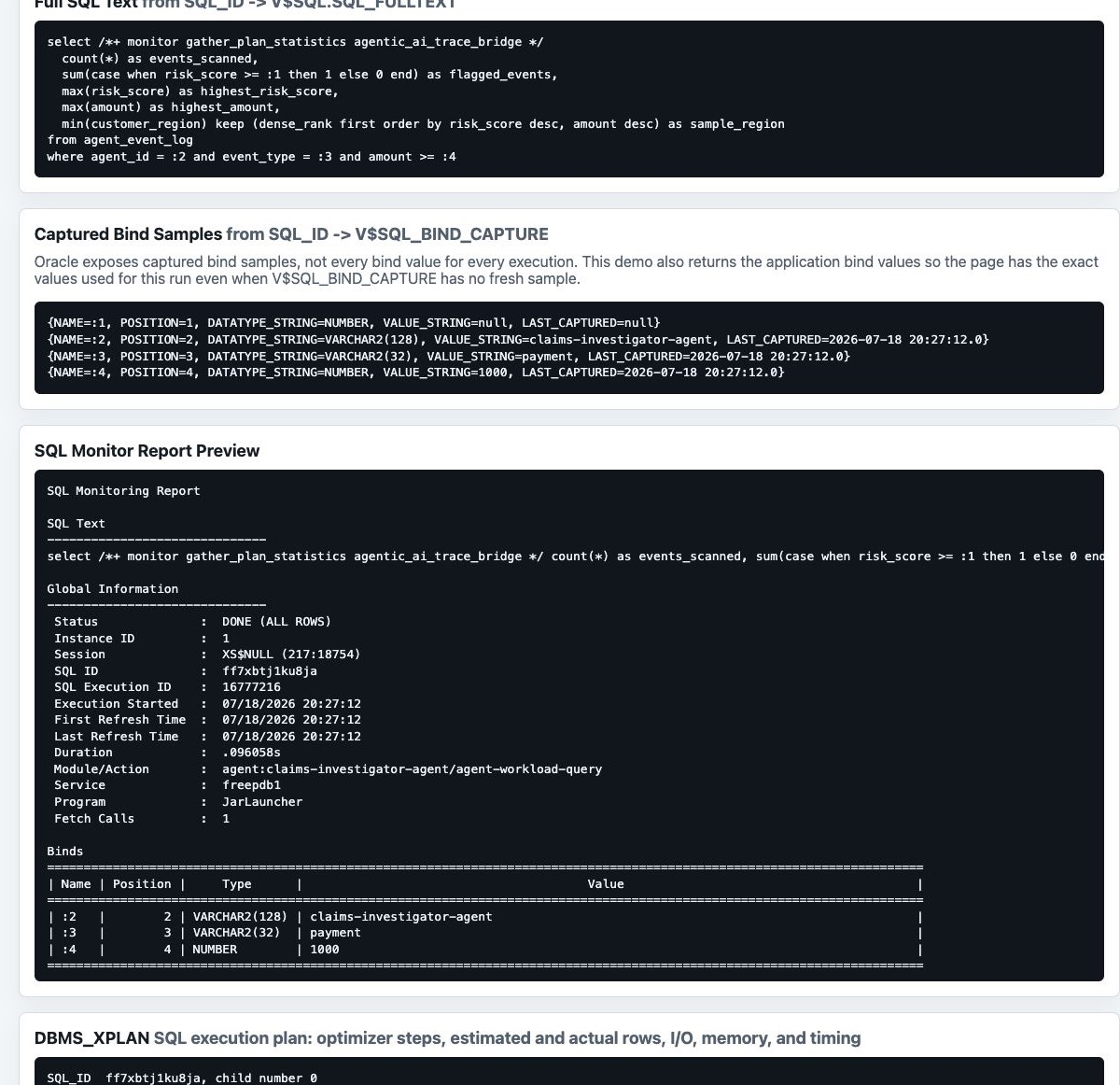

The demo returns a canonical SQL ID from the cursor used for its DBMS_XPLAN and SQL Monitor lookups. Oracle JDBC spans and database-exported spans can also expose oracle.db.query.sql.id, but do not assume that every layer will report the same cursor. A verified run for the screenshots in this article returned one canonical SQL ID on the demo page and a different SQL ID on the selected oracle-db / DB Server span.
Keep the correlation intact with the trace id, database ECID, MODULE, ACTION, and session id. Then use the canonical SQL ID returned by the page for its V$SQL, bind capture, SQL Monitor, and DBMS_XPLAN drill-down. A SQL ID on a particular span remains useful evidence, but it identifies that span’s database cursor rather than a guaranteed cross-layer identifier.
EvidenceWhere it comes from
Visual trace and database server evidenceTrace id, ECID, module, action, session id, and any layer-specific oracle.db.query.sql.id attribute
Full SQL textCanonical SQL_ID -> V$SQL.SQL_FULLTEXT
Captured bind samplesSQL_ID -> V$SQL_BIND_CAPTURE
Runtime planDBMS_XPLAN.DISPLAY_CURSOR, the SQL execution plan with optimizer steps, estimated and actual rows, I/O, memory, and timing
SQL Monitor reportDBMS_SQL_MONITOR.REPORT_SQL_MONITOR
The demo also calls DBMS_SQL_MONITOR.BEGIN_OPERATION around the agent task. That call is different from setting JDBC end-to-end metrics: it creates a named database operation for SQL Monitor so the agent task has a database-side operation id and attributes. The trace and SQL-ID bridge still work without it, because the workload SQL uses the MONITOR hint and the app queries V$SQL, V$SQL_BIND_CAPTURE, SQL Monitor, and DBMS_XPLAN by SQL ID. Keeping BEGIN_OPERATION makes the demo stronger by giving SQL Monitor a named server-side operation for the agent task; removing it would simplify privileges and code, but would lose that named database-operation evidence.
Demo page showing full SQL text from SQL_ID to V$SQL.SQL_FULLTEXT, captured bind sample explanation, and SQL Monitor report preview.
SQL_ID lets the demo drill from the trace into full SQL text, bind-sample notes, and SQL Monitor output.
Demo page showing SQL Monitor report preview and DBMS_XPLAN execution plan output for the traced SQL statement.
SQL Monitor and DBMS_XPLAN make the traced database span useful for performance profiling and SQL diagnostics.
What Does the Agentic AI Demo Page Show?
The browser endpoint keeps the demo cohesive by returning the agent story, database diagnostics, and Jaeger trace on one page:
http://localhost:8080/trace/agent-task/view?agentId=claims-investigator-agent&task=investigate_payment_anomalies
The page includes:
  • Agent id and task name.
  • Trace id and SQL ID bridge.
  • Database session context, including module/action/client identifier.
  • Application bind values used by this exact request.
  • Full SQL Text heading labeled from SQL_ID -> V$SQL.SQL_FULLTEXT.
  • Captured Bind Samples heading labeled from SQL_ID -> V$SQL_BIND_CAPTURE.
  • SQL Monitor and DBMS_XPLAN output.
  • An embedded Jaeger trace loaded after a short delay so spans have time to flush.

In the verified Linux environment, Jaeger showed a single trace containing both services: springboot-oracle-db-otel-demo from the Java process and oracle-db from Oracle AI Database server-side export.
  "services": [
    "oracle-db",
    "springboot-oracle-db-otel-demo"
  "ops": [
    "DB Server",
    "Execute query",
    "Fetch a row",
    "http get /trace/agent-task",
    "oracle.demo.agent-database-investigation"

How Does the Trace Connect to Security and Auditing?
The demo correlates its trace with Oracle AI Database Deep Data Security. Observability shows what the agent did; database security explains why Oracle AI Database allowed or denied it. The trace already carries the join keys needed for that correlation:
  • trace.traceId identifies the distributed request.
  • agent.id identifies the AI actor in the application span.
  • oracle.db.module=agent:<agent-id> identifies the same actor inside Oracle AI Database.
  • oracle.db.action identifies the database phase.
  • CLIENT_IDENTIFIER=traceId=<trace-id> gives database security and audit policy a compact correlation value.
  • oracle.db.query.sql.id bridges the trace to SQL text, SQL Monitor, DBMS_XPLAN, and later audit records.
The sample app now includes a Database Security Context panel backed by a real password-authenticated local Deep Data Security end user. It works without Entra ID, OCI IAM, OAuth tokens, or a JDBC EndUserSecurityContext call. The page correlates the trace with ORA_END_USER_CONTEXT.username, the associated schema, MODULE, ACTION, CLIENT_IDENTIFIER, enabled database roles, effective privileges, the granted data role, the applicable data grant, and V$END_USER_DATA_ROLE for this request. A row-filtering proof runs in that same traced session and shows both the number of rows allowed by the data grant and zero visible rows for other agents.
The panel deliberately separates regular Oracle Database roles from Oracle AI Database Deep Data Security data roles. A role such as SELECT_CATALOG_ROLE is a normal session role and appears in SESSION_ROLES. A DDS data role such as AGENT_CLAIMS_INVESTIGATOR appears in DBA_DATA_ROLES and receives data grants in DBA_DATA_GRANTS. The local setup script observability/sql/setup_local_deep_data_security.sql creates the local end user claims-investigator-agent, assigns AGENT_CLAIMS_INVESTIGATOR with GRANT DATA ROLE, and grants that role SELECT access to only the agent’s event-log rows. The FINANCIAL database user remains the owning schema rather than the runtime principal.
A Deep Sec local end user is distinct from a conventional database user. Data roles cannot be granted directly to the FINANCIAL schema account. Direct password login as the local end user establishes the end-user security context in Oracle AI Database and activates the assigned data role without application-side token propagation. The Entra ID and OCI IAM provider/API examples remain the right pattern when an application must propagate externally managed end-user identities through a shared pool user.
A security-aware version can run the same agent workload against protected tables, then show effective database user, enabled roles, policy decisions, rows allowed or filtered, and a denied-operation example. After that, a scoped audit policy can record the same actor, module, action, SQL ID, and trace id so the page shows one story: this agent made this request, Oracle AI Database enforced these policies, and the audit trail recorded it.
