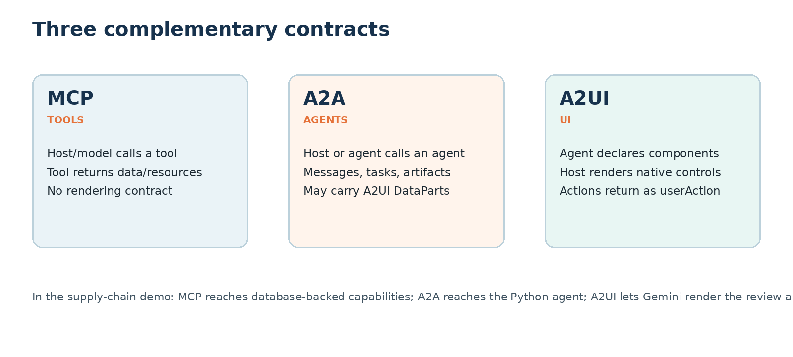

Which Protocols Connect Which Responsibility?
The host examples in this article are the standalone browser, Gemini Enterprise, ChatGPT, and Claude. Each supports a different combination of transport and UI capabilities.
AG-UI is not required merely because an application uses A2UI or MCP Apps. AG-UI is an optional event transport for a custom frontend; A2UI is a declarative JSON UI specification; and MCP Apps package a developer-built web application. A design can use any one of them or combine them when their separate responsibilities are needed.
Comparison of MCP for tools, A2A for agent communication, and A2UI for declarative host-rendered user interfaces.
Three complementary contracts: MCP exposes tools, A2A connects a host or agent to another agent, and A2UI lets an agent declare controls that the host renders.
Protocol responsibility map showing AG-UI between the standalone browser and backend, MCP between the agent and governed tools, A2A between a capable host and its adapter, A2UI in native host interfaces, MCP Apps in compatible hosts, and Oracle AI Database below the Toolkit.
MCP connects the service to tools, AG-UI connects the custom browser to the service, and A2A connects a capable host to its agent. A2UI and MCP Apps remain different UI rendering models.
LayerPrimary jobIn this application
AG-UIOptional transport pipeline for tokens, events, tool lifecycles, and shared state between an agent backend and a custom frontend.Carries run lifecycle, text, MCP tool activity, A2UI messages, state, and errors over SSE.
A2UIDeclarative, streaming JSON recipe that lets an agent dynamically build and update a UI from the host’s pre-approved native component catalog.Defines inventory cards, notes, approval, and cancel controls.
MCP AppsDeveloper-built HTML and JavaScript application returned as a ui:// resource for a host sandbox.Provides the portable recommendation dashboard for compatible conversational hosts.
MCPStandardizes discovery and invocation of tools and resources.Connects the service to five governed Oracle Database operations.
A2AStandardizes agent discovery, requests, and results.Carries host requests and A2UI v0.8 DataParts.
Oracle Database MCP Java ToolkitExpose reusable Oracle Database capabilities.Runs the exact YAML-defined allowlist of reads and procedure-backed writes.
Oracle AI DatabaseRemain the trusted data and execution layer.Computes recommendations and enforces locking, transactions, authorization, and auditing.

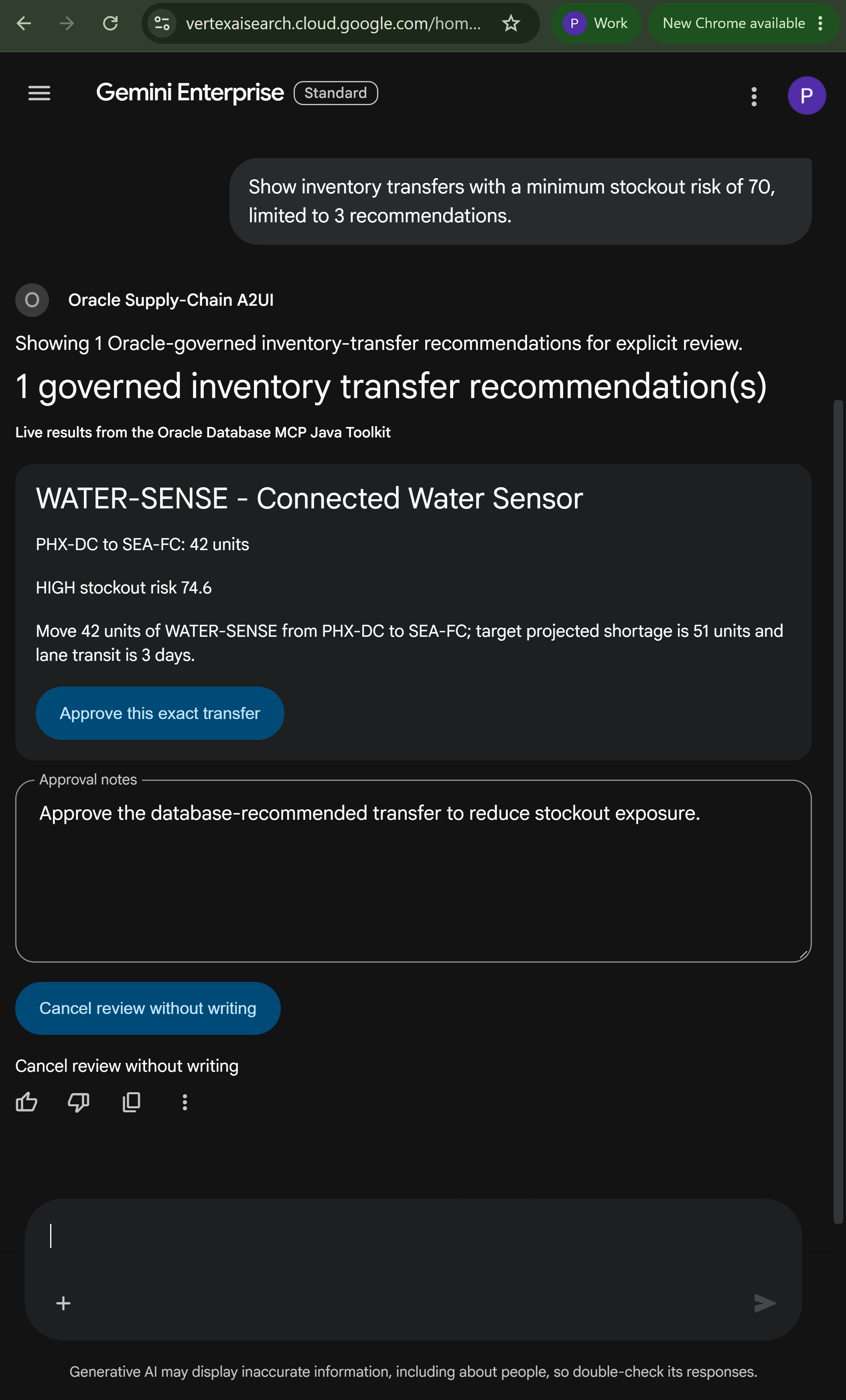

From Stockout Analysis to an Inventory-Transfer Decision
Consider the request: “Show inventory at risk of stockout, explain the demand and safety-stock factors, and let me approve a feasible transfer from another location.” A useful supply-chain AI application must expose more than a prose answer:
  • the current run status and governed database tool being invoked;
  • a bounded list of products and target locations at risk;
  • on-hand, reserved, inbound, forecast, safety-stock, and shortage quantities;
  • a feasible source location, transfer quantity, transit time, and cost;
  • an explicit approval boundary with an operator note; and
  • a transfer ID and auditable completion state.
The agent can decide when to request recommendations and how to explain them. It cannot choose an arbitrary transfer quantity, execute generated SQL, create new UI capabilities, or substitute a different source and target after approval. These enforced boundaries provide application and database guardrails that reduce manipulation, unauthorized operations, and unintended writes.

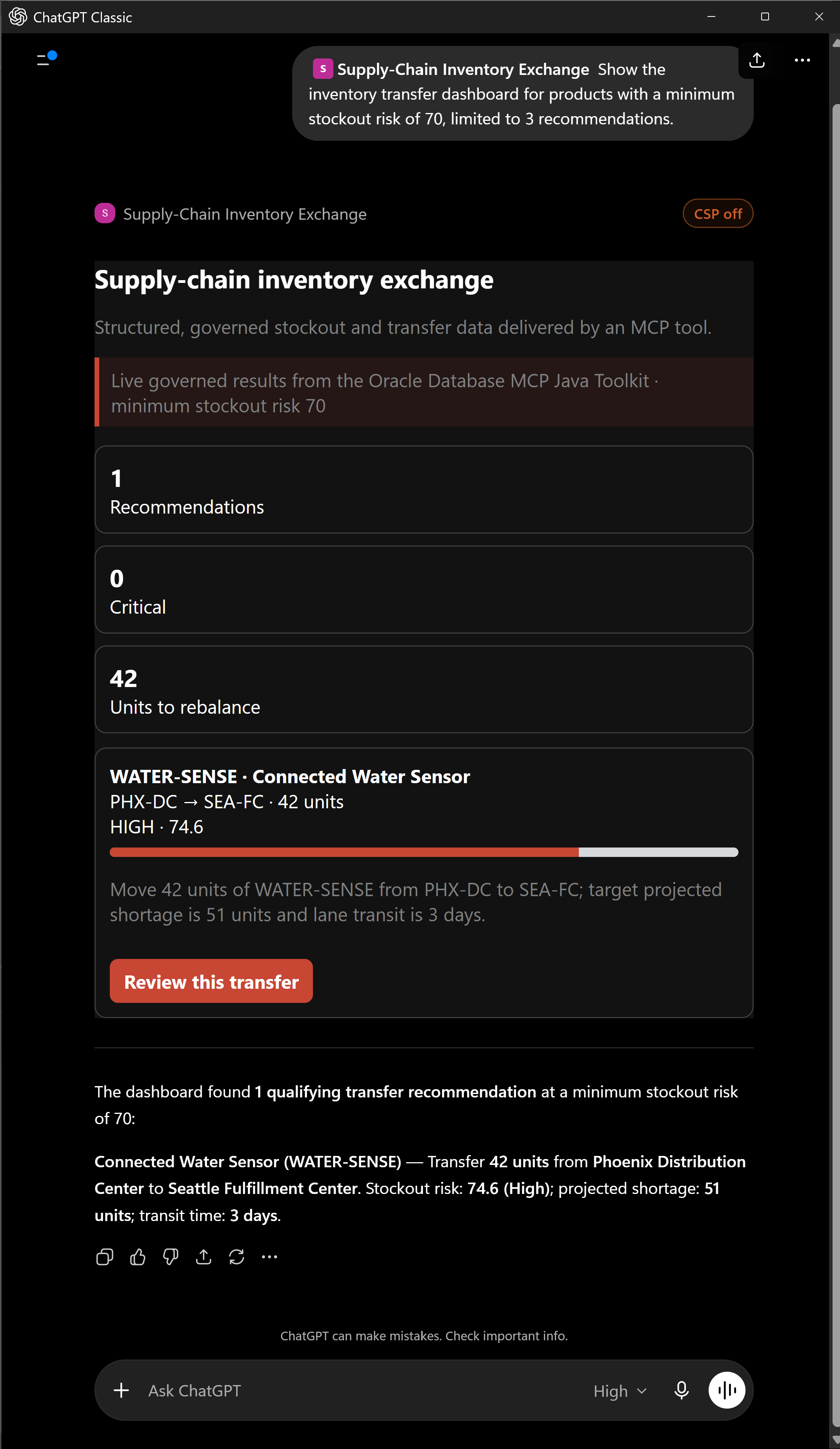

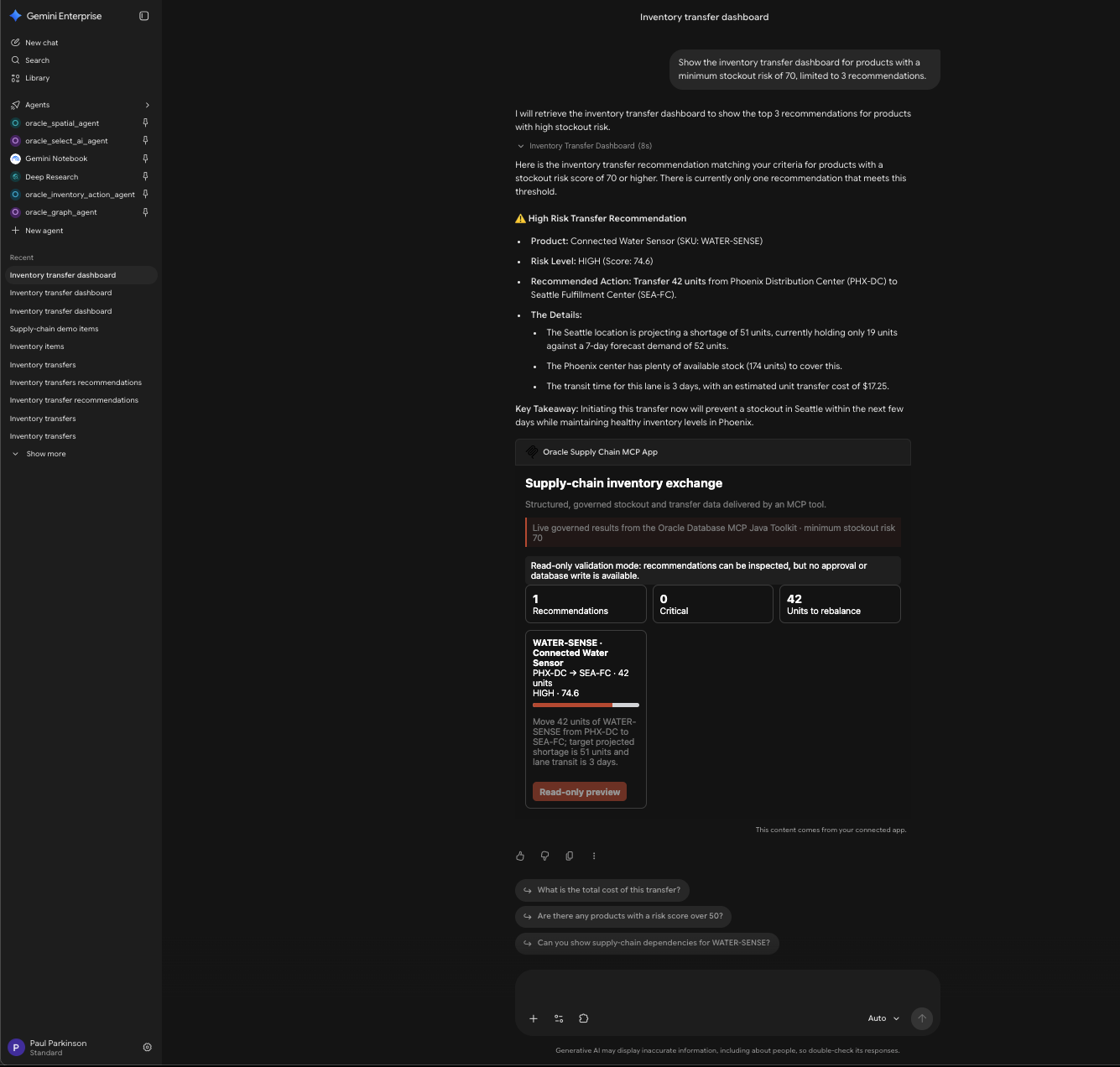

Do MCP Apps use A2UI? Not automatically. This reference application implements two alternative UI paths over the same governed service: a host-rendered A2UI path and a sandboxed MCP App path. The official A2UI project also defines optional composition patterns for embedding an MCP App as a custom component in an A2UI surface and for bundling an A2UI renderer inside an MCP App. Those patterns require explicit renderer, catalog, bridge, and sandbox integration; using either protocol alone does not activate the other.

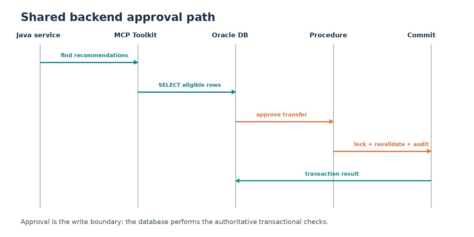

The Toolkit configuration enables exactly five business operations:
  1. find-stockout-transfer-recommendations returns bounded recommendations above a risk threshold.
  2. get-stockout-transfer-details retrieves one current recommendation by its compound ID.
  3. reserve-inventory-transfer-id obtains the next audit identifier.
  4. approve-inventory-transfer calls the locked, procedure-backed write.
  5. count-inventory-transfers verifies the resulting audit record.

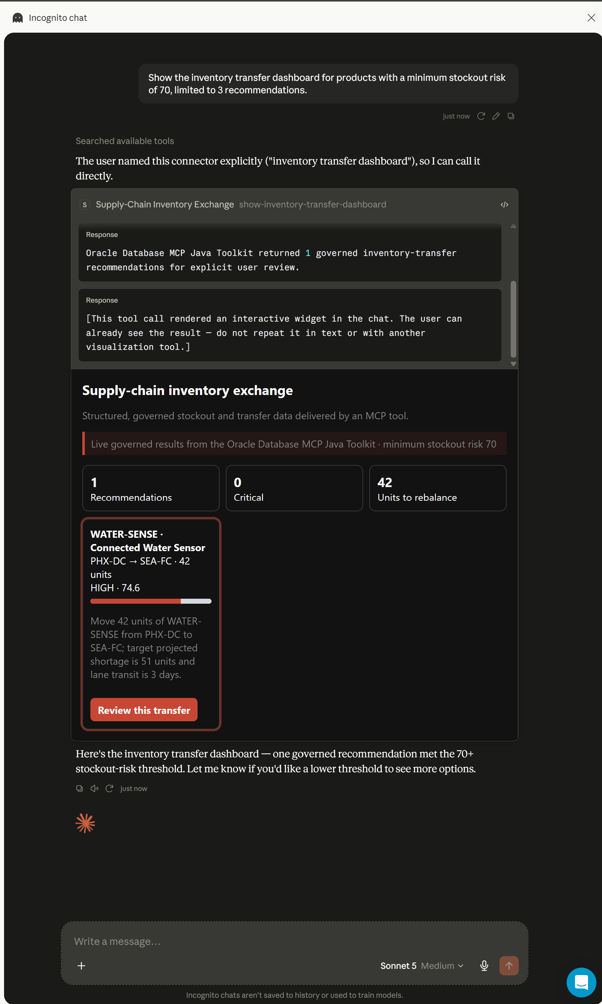

The Oracle logo illustrates the distinct controls. The MCP App permits the external image through resourceDomains in mcp-app/server.ts. The A2UI path separately requires the Image component and permits https://www.oracle.com through allowedImageOrigins in web-client/app.js. An A2UI payload does not inherit an MCP App’s CSP.

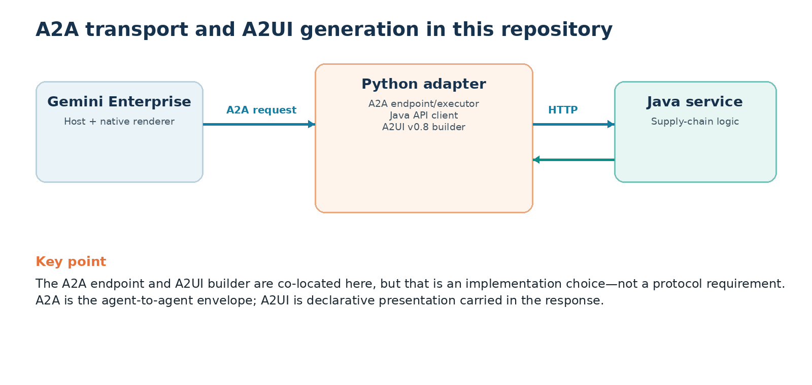

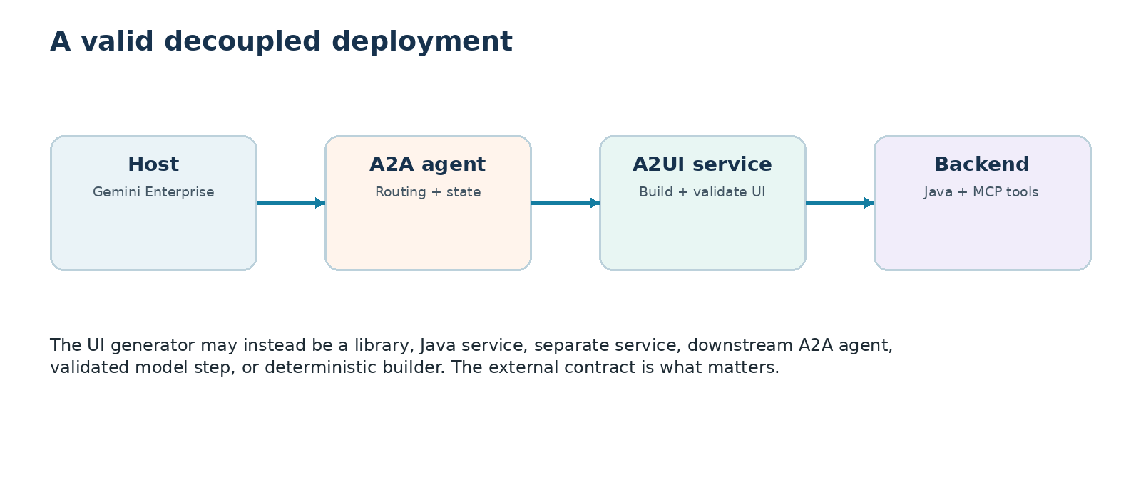

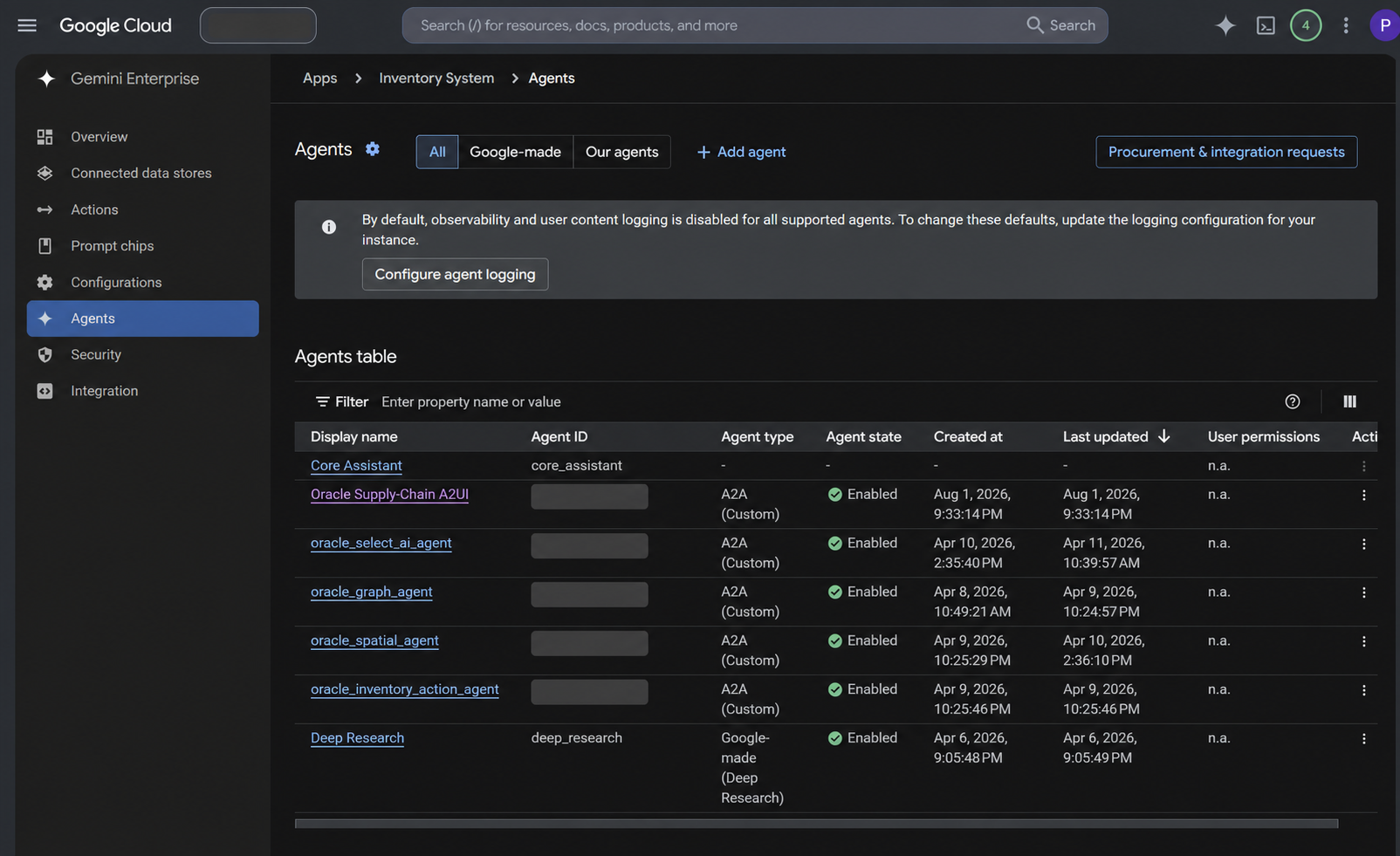

The A2A Agent Explicitly Advertises A2UI Support
The adapter publishes a dynamically generated agent card at GET /.well-known/agent-card.json. Its A2A protocol version and A2UI extension are separate declarations, so a host can discover both the communication contract and the supported UI capability before invoking the agent.
build_agent_card() in gemini-enterprise-a2a/main.py generates a card equivalent to this JSON representation:
  "capabilities": {
    "streaming": true,
    "extensions": [
        "uri": "https://a2ui.org/a2a-extension/a2ui/v0.8",
        "required": false,
        "params": {
          "supportedCatalogIds": [
            "https://a2ui.org/specification/v0_8/standard_catalog_definition.json"
  "protocolVersion": "0.3.0"

A normal request returns text plus an A2UI review surface. An approve or cancel userAction returns text plus a smaller A2UI result surface. A host that does not render the optional extension can still use the text part, and an error path returns text only.
Map Oracle Database Results into Gemini Enterprise A2UI
  1. gemini-enterprise-a2a/main.py calls the Java service and receives the database-backed recommendation dictionaries:review = await asyncio.to_thread( _post_agent, "/api/reviews", { "minimumStockoutRisk": minimum_risk, "maximumRows": maximum_rows, "accessProfile": access_profile, }, )
  2. gemini-enterprise-a2a/a2ui_payloads.py maps those values into approved A2UI components:components.extend([ _component( card_id, "Card", {"child": content_id}, ), # Additional approved components are omitted. _text( f"route-{index}", f"{recommendation['sourceLocationCode']} to " f"{recommendation['targetLocationCode']}: " f"{recommendation['recommendedTransferQuantity']} units", ), ])
  3. gemini-enterprise-a2a/main.py packages the messages as A2UI DataParts in the A2A response:parts = [ Part(root=TextPart( text=f"Showing {len(review['recommendations'])} recommendations." )), *(create_a2ui_part(message) for message in messages), ]
Native A2UI sequence showing a human supply-chain planner using Gemini Enterprise, which calls the A2A adapter, agent service, Oracle MCP Toolkit, and Oracle AI Database before rendering native controls and returning approval as a userAction.
The human planner uses an A2UI-capable host. The adapter returns A2UI DataParts, the host renders native controls, and the planner’s click returns to the same A2A agent as a bounded userAction.

Sequence diagram showing the service calling the Oracle Database MCP Java Toolkit, selecting eligible rows, invoking the approval procedure, locking and revalidating inventory, auditing the result, and committing the transaction.
Every UI path converges at the same write boundary. Oracle AI Database, not the host or model, performs the authoritative lock, revalidation, audit, and atomic commit.

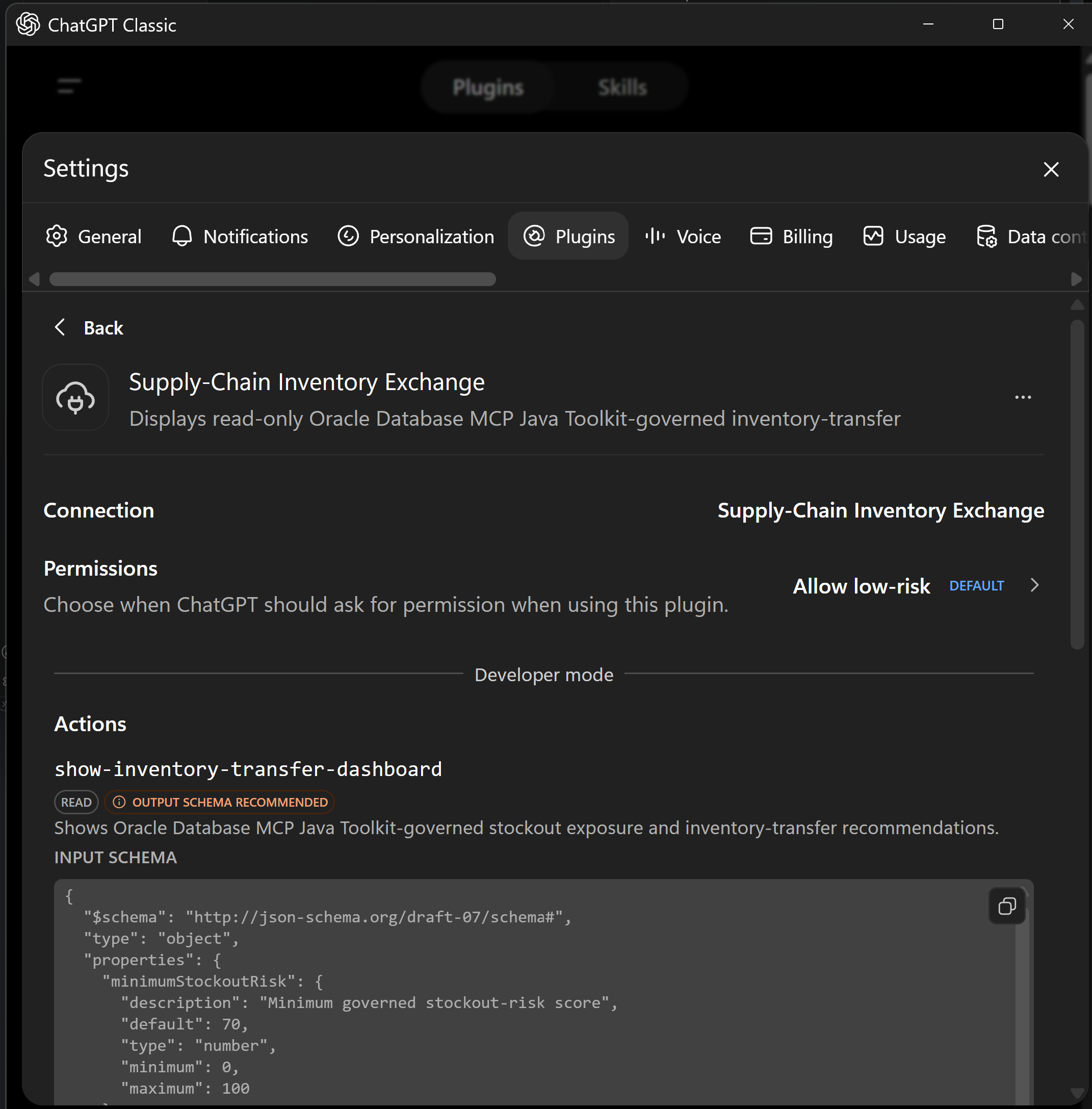

  1. Set the required environment variables documented at the top of deploy/gcp/deploy-chatgpt-mcp.sh, then run that script from macOS or Linux to build and deploy the private read-only service. It reads the wallet and password from Secret Manager.
  2. With a Google identity token, verify /health, tools/list, resources/read, and a read-only tools/call. Confirm that anonymous access still returns 403.
  3. Choose the access gate. Keep MCP_WRITES_ENABLED=false for a synthetic-data rendering demonstration. For durable use or any approval action, configure an established OAuth 2.1 provider.
  4. In ChatGPT, open Settings > Security and login and enable Developer mode. Workspace policy can control whether this setting is available.
  5. Open Plugins, select the plus button, name the plugin Supply-Chain Inventory Exchange, choose the configured authentication method, and enter the deployment URL ending in /mcp.
  6. Acknowledge the custom-MCP warning, create and connect the plugin, then inspect its metadata. Discovery must show only show-inventory-transfer-dashboard with minimumStockoutRisk and maximumRows inputs.
  7. Start a new conversation, add Supply-Chain Inventory Exchange from the tools menu, and ask: “Show the inventory transfer dashboard for products with a minimum stockout risk of 70, limited to 3 recommendations.”
  8. Verify that ChatGPT calls the tool with minimumStockoutRisk=70 and maximumRows=3, renders the embedded component, and labels the result as live data from the Toolkit.
  9. Refresh the plugin connection whenever tool or resource metadata changes.
ChatGPT plugin settings showing the single discovered show-inventory-transfer-dashboard action and its bounded risk and limit input schema.
Discovery exposes one model-visible action with bounded query inputs. Keep approval and rejection tools unavailable until authenticated write access is configured.
ChatGPT rendering the Supply-Chain Inventory Exchange MCP App with the live WATER-SENSE recommendation from PHX-DC to SEA-FC for 42 units at stockout risk 74.6.
The MCP App renders inline with the Toolkit source label, database-derived metrics, transfer route, and a model-readable summary.

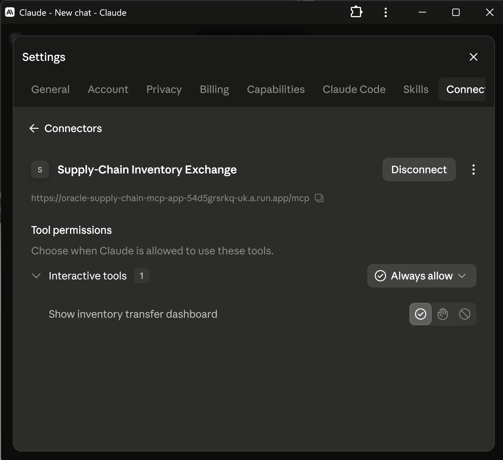

  1. Deploy the same Streamable HTTP MCP App service used by ChatGPT with an appropriate authentication boundary.

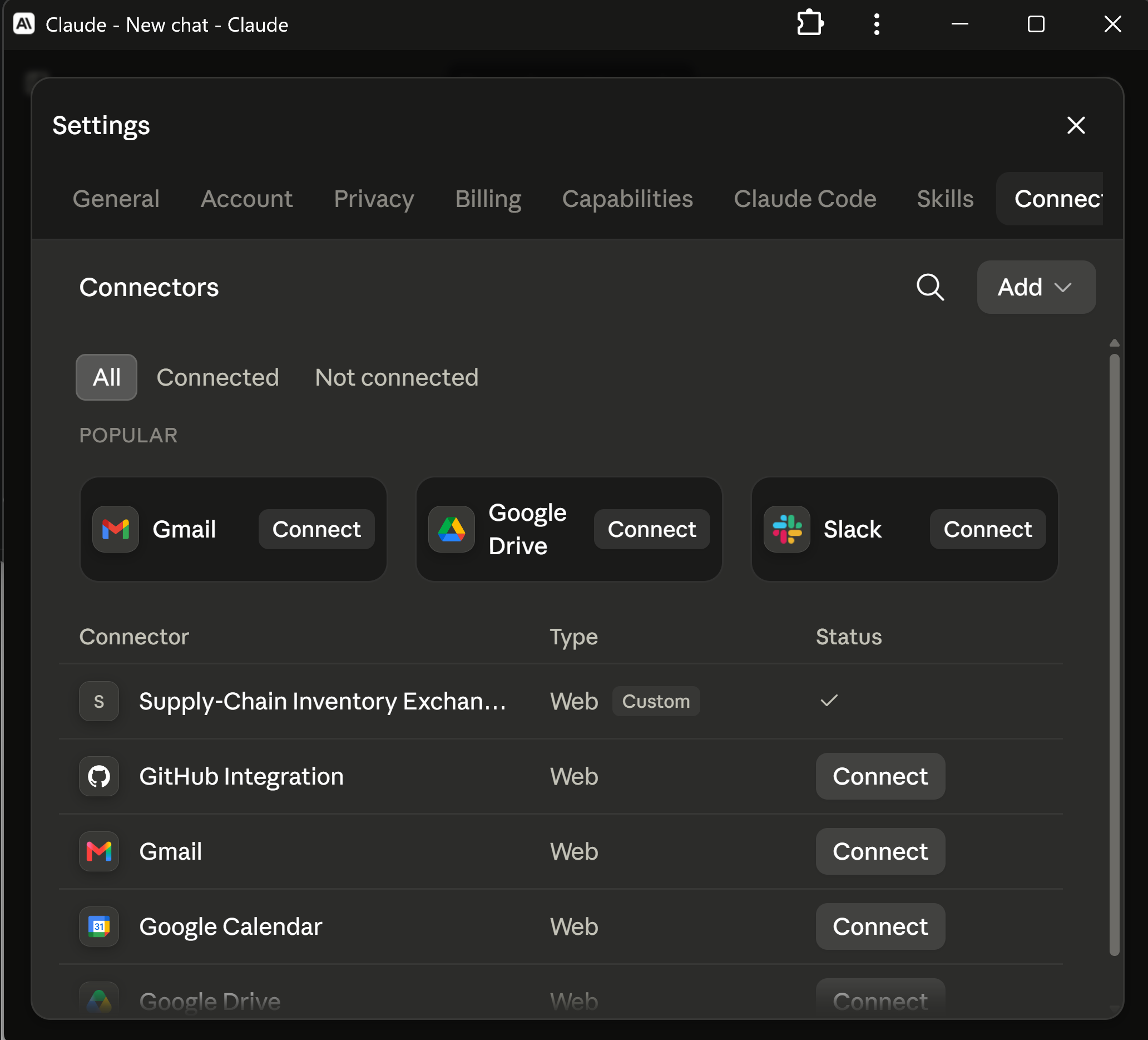

  2. In Claude, open Settings > Connectors, select Add > Add custom connector, provide a descriptive name, and enter the remote URL ending in /mcp.
  3. Open the connector detail page. Confirm that it is connected and exposes exactly one interactive tool, Show inventory transfer dashboard. Choose whether Claude may invoke it automatically, ask each time, or never.

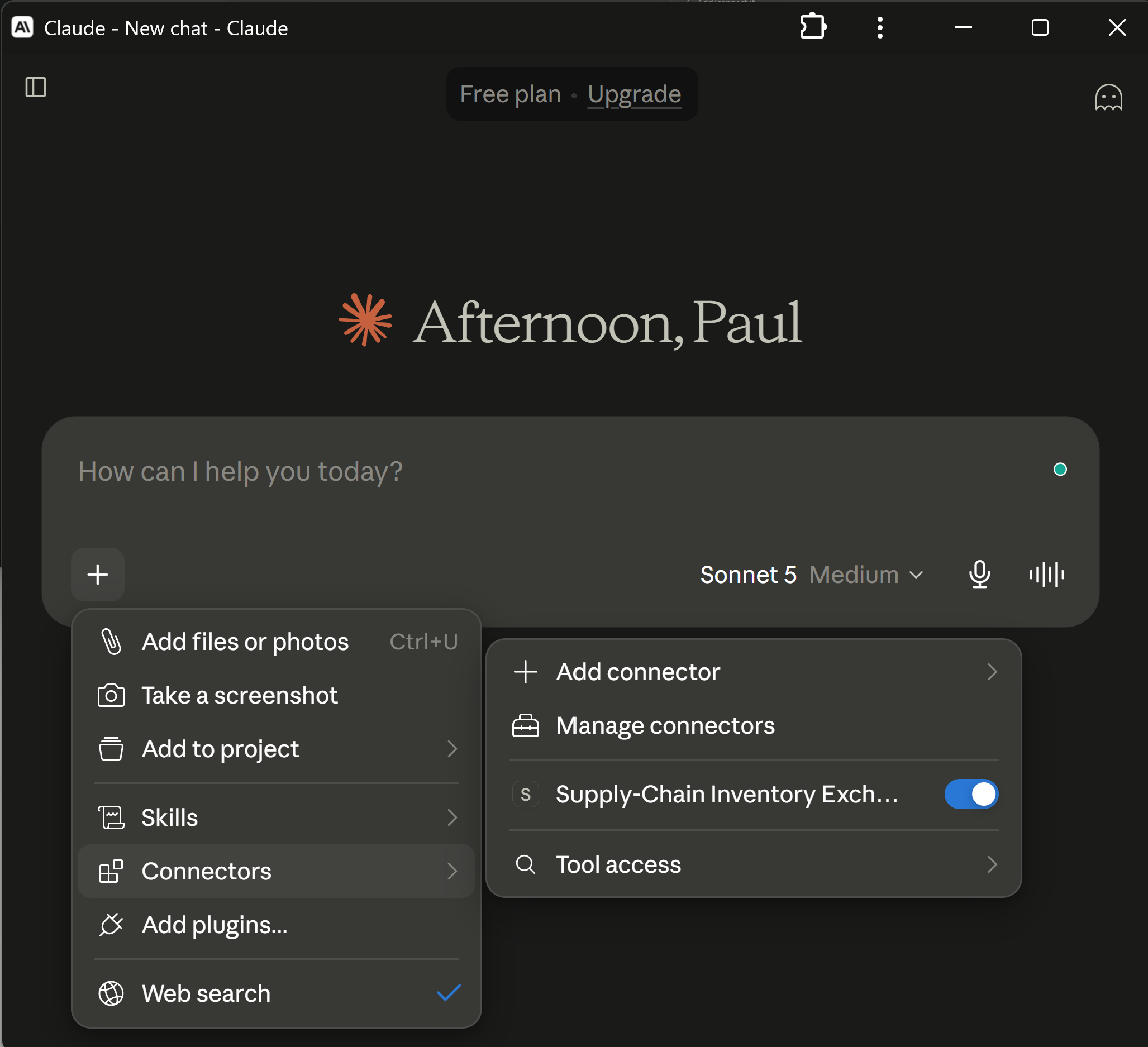

  4. Start a new chat, open the plus menu, enable Supply-Chain Inventory Exchange, and allow connector search if Claude presents that separate discovery opt-in.
  5. Ask: Show the inventory transfer dashboard for products with a minimum stockout risk of 70, limited to 3 recommendations.
  6. Verify the model-visible tool result and inline widget both report the same Toolkit-backed row: WATER-SENSE, PHX-DC to SEA-FC, 42 units, and stockout risk 74.6.
  7. Require OAuth 2.1 before exposing customer-specific data or registering the approval and rejection tools.

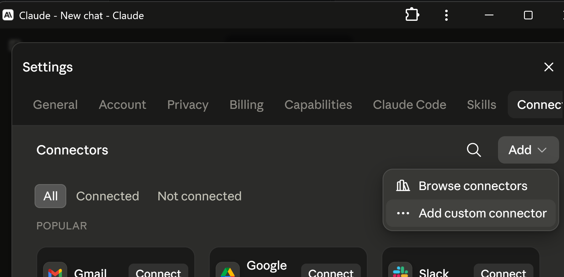

Claude Connectors settings with the Add menu open and Add custom connector selected.
Open Claude’s connector settings and choose Add custom connector.

Claude chat plus menu with Supply-Chain Inventory Exchange enabled under Connectors.
Enable the connector for the conversation from Claude’s plus menu before submitting the bounded dashboard prompt.
Claude in a regular browser rendering the live Supply-Chain Inventory Exchange MCP App with the WATER-SENSE recommendation.
Claude invokes show-inventory-transfer-dashboard, displays the Toolkit result, and renders the Oracle-backed MCP App inline.

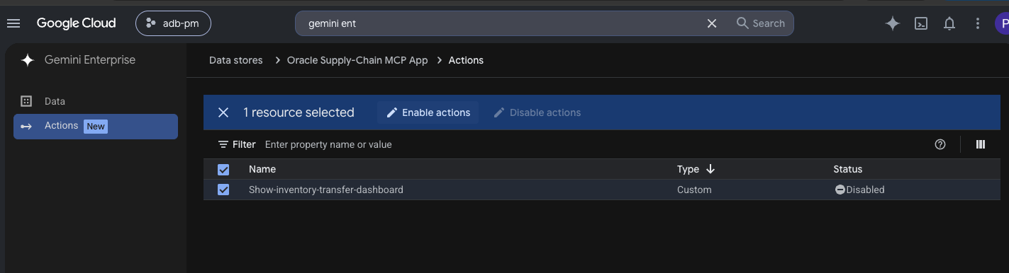

  6. Open Actions, select Reload custom actions, enable show-inventory-transfer-dashboard, and verify that no broader SQL or write tool is model-visible.
  7. In the Gemini Enterprise application, enable the connector and ask: Show the inventory transfer dashboard for products with a minimum stockout risk of 70, limited to 3 recommendations.
  8. Confirm that the tool result and sandboxed widget agree on the governed recommendation and display the read-only boundary. The native A2UI agent is not involved in this path.

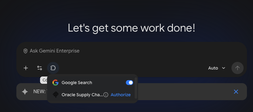

Gemini Enterprise connector Actions page with the show-inventory-transfer-dashboard action selected for enablement.
Enable the imported dashboard action on the connector.
Gemini Enterprise connector menu offering authorization for the Oracle Supply-Chain MCP App.
Authorize the connector for the conversation.
Gemini Enterprise displaying the Oracle Supply-Chain MCP App with a governed inventory-transfer recommendation.
Invoke the action and render the governed results inline.
Run Native A2UI in Gemini Enterprise
Author verification: The capability and setup claims in this section were checked against Google Cloud’s official A2UI registration and Cloud Run tutorial documentation on August 20, 2026. Product interfaces and terminology can change.
Gemini Enterprise is the A2UI-capable host used in this reference application. Its custom-agent path uses A2A as the conversation transport and A2UI as declarative UI cargo. This implementation targets A2A v0.3 and A2UI v0.8, while the standalone browser consumes A2UI v0.9.1 envelopes. This is one implementation example, not a coupling between A2UI and Gemini Enterprise.
Separate A2A Transport from A2UI Presentation
In this repository, gemini-enterprise-a2a/main.py co-locates the A2A endpoint, request executor, Java API client, and deterministic A2UI v0.8 builder in one process. That is a compact implementation choice, not a protocol requirement. A2A carries messages, tasks, artifacts, and DataParts between Gemini Enterprise and the remote agent; A2UI is the declarative presentation placed in those DataParts.
Diagram showing Gemini Enterprise sending an A2A request to one adapter process that contains the A2A endpoint and A2UI builder, then calls the supply-chain service.
The demonstration co-locates A2A transport and A2UI generation because the builder is small and deterministic and the adapter can keep Gemini-specific UI versions out of the domain service.
Diagram showing a valid decoupled deployment with a host, separate A2A agent, A2UI generation service, and backend connected in sequence.
A2UI generation can instead be a library, separate service, downstream agent, validated model step, or deterministic builder. The external version, catalog, message, and action contracts are what matter.
The agent card shown in the A2UI implementation section advertises the A2UI v0.8 extension and standard catalog that this co-located builder produces. A decoupled implementation would advertise the same external contract.
Follow the Native A2A/A2UI Path

The adapter emits deterministic beginRendering, surfaceUpdate, and dataModelUpdate messages containing native cards, approval notes, and one button per exact recommendation. Gemini Enterprise resolves the button context into a v0.8 userAction; the adapter forwards only the approval handle, recommendation ID, and notes. The Java service recovers the immutable recommendation and Oracle revalidates it under locks. Every host-specific adapter shares this governed workflow and transaction without sharing a UI protocol.
The following excerpt from gemini-enterprise-a2a/a2ui_payloads.py returns the ordered A2UI v0.8 messages that the host renders:

Register, share, and invoke the custom agent
Register the deployed agent card with the Gemini Enterprise application in the same project and location, then share the custom agent using the per-agent Agent User role. Assign the required Gemini Enterprise license to each user; licensing is an account prerequisite, not part of the application architecture.
Google Cloud Gemini Enterprise Agents page showing Oracle Supply-Chain A2UI as an enabled custom A2A agent in the Inventory System app.
The Google Cloud administration view confirms that Oracle Supply-Chain A2UI is registered and enabled as a custom A2A agent for the app.
In the Gemini Enterprise web app, the shared agent appears under From your organization. The prompt Show inventory transfers with a minimum stockout risk of 70, limited to 3 recommendations invokes the agent over authenticated A2A streaming. Oracle returned the one row in the sample data that met that threshold: a 42-unit WATER-SENSE transfer from PHX-DC to SEA-FC with a stockout-risk score of 74.6. Gemini Enterprise rendered the returned A2UI DataParts as a native card, approval-notes field, exact-transfer approval button, and cancel-without-writing button. The host never loaded the MCP App iframe.
Gemini Enterprise rendering an Oracle-backed A2UI inventory-transfer recommendation with approval notes, approve, and cancel controls.
A live Oracle Database MCP Toolkit result rendered natively by Gemini Enterprise from A2UI v0.8 delivered over A2A v0.3.

Why not let the agent generate SQL or choose any transfer?
A bounded recommendation view and stored procedure make the allowed data, feasibility formula, privileges, locks, transaction, and audit result explicit. Unrestricted SQL or client-selected quantities would expand the attack surface and make execution less deterministic.
Where is approval enforced?
The agent service binds approval to the authenticated actor and exact returned recommendation. The MCP tool accepts only validated inputs, and Oracle AI Database locks and rechecks current stock before it commits the transfer.
