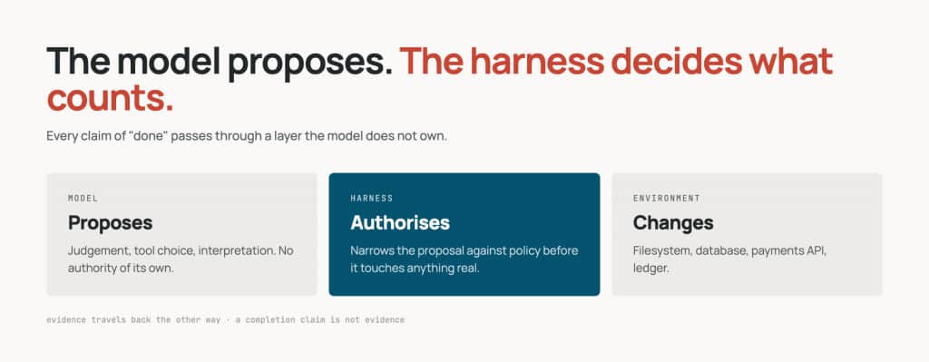

A model proposes an action, the harness narrows it against policy before it reaches anything real, and evidence travels back from the environment so a completion claim can be checked rather than believed.
Diagram showing the model proposing, the harness authorising, and the environment applying changes.

The model proposes, the harness authorises, the environment acts, and a verifier decides whether any of it counted. Your graduate’s induction.

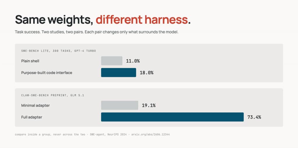

A bar chart of four task-success scores. A shell-only agent on GPT-4 Turbo reaches 11.0 per cent and the same model with a purpose-built code interface reaches 18.0 per cent. A minimal adapter on the GLM 5.1 backbone reaches 19.1 per cent and a full adapter on the same backbone reaches 73.4 per cent.
Bar charts show higher task success when the model is surrounded by a purpose-built interface or full adapter.
Each pair holds the model fixed and changes only what surrounds it. In a peer-reviewed ablation over 300 SWE-bench Lite tasks, GPT-4 Turbo solved 18.0 per cent with a purpose-built interface to the codebase and 11.0 per cent driving a plain shell (SWE-agent). In a 2026 preprint, a minimal and a full adapter on the same GLM 5.1 backbone scored 19.1 and 73.4 per cent (Claw-SWE-Bench). No weights changed, and the score did. A third study, over 5,194 trajectories on 106 sandboxed tasks at shared budgets, found a 23.8-point gap between its best and worst configurable harnesses (Harness-Bench). Each bundles several mechanisms per adapter, so none says which part did the work. Together they establish that the wrapper is a variable, not a detail.

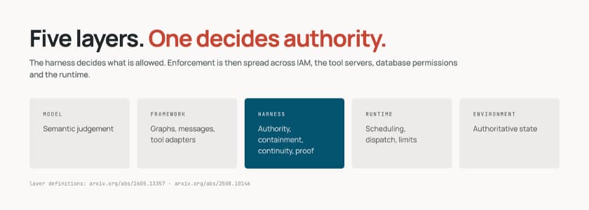

LayerWhat it isWhat it ownsWhat it cannot decide
ModelThe learned inference component that maps context to proposed actions (Toolformer)Semantic judgement, tool selection, interpretationWhether it holds the credential, or whether the call was allowed
FrameworkReusable developer abstractions: graphs, messages, tool adapters, hooks, as in LangGraph, AutoGen and Semantic Kernel (Agentic AI Frameworks)Construction primitives and wiringThe deployed application’s permissions, recovery rules or acceptance tests
HarnessThe configured operational envelope binding a model to one task under real credentials, real limits and a real definition of done (AI Harness Engineering)Authority, containment, continuity, proofWhat the model is semantically capable of
RuntimeThe machinery that instantiates and advances that envelope for one run (Scaling Managed Agents)Turn scheduling, dispatch, limits, event recordsThe policy it is enforcing
EnvironmentThe filesystem, browser, database, network and services where actions take effect (SWE-agent)Authoritative stateAnything about intent
Five layers side by side. The model, framework, harness, runtime and environment each own something, and authority is decided in one of them: the framework supplies materials, the harness supplies the configured rules, and enforcement is then spread across IAM, the tool servers, database permissions and the runtime that enacts those rules against a real environment.
Five-layer architecture diagram highlighting the harness as the layer that decides authority.

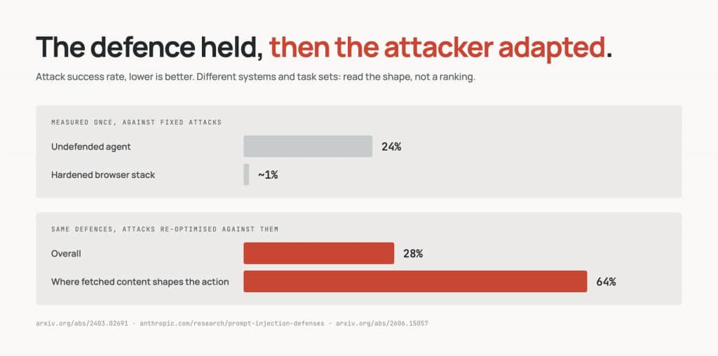

A bar chart of attack success rates. An undefended ReAct-prompted GPT-4 agent follows indirect attacks 24 per cent of the time. A hardened browser stack under a fixed adaptive evaluation sits near 1 per cent. When attacks are re-optimised against a deployed filter, success recovers to 28 per cent overall and 64 per cent on tasks where fetched content shapes the action.
Chart showing how attack success can increase when attackers adapt to existing defences.
Undefended, a ReAct-prompted GPT-4 followed indirect attacks in 24 per cent of 1,054 cases (InjecAgent). Hardening moves that a long way, through instruction-hierarchy training (Improving Instruction Hierarchy in Frontier LLMs) and, in one browser stack combining training, classifiers and red-teaming, down to roughly 1 per cent residual success at 100 attempts per environment, which the vendor still calls meaningful (Mitigating the Risk of Prompt Injections in Browser Use).
Then the ground moves. AutoDojo re-optimised its attacks against a filter that had scored zero under static testing and recovered 28 per cent success, rising to 64 per cent where fetched content helped decide the action (AutoDojo). A defence measured once is not a defence measured under pressure.
