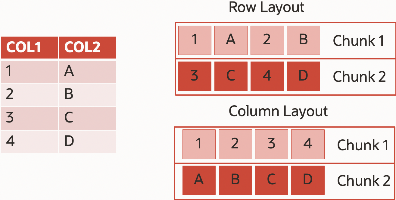

  • Columnar format.
Parquet Files are organized in columns, which means only columns listed in the SQL statement need to be read by compute layer if the processing engine is smart enough to take advantage of this format. Oracle is such a smart engine, and so are Spark or Presto.
 Row/Col layout
If you need to read a single column from a Parquet file, you only read the corresponding column chunks from all Row Groups. You do not need to read and interpret the full content of all Row Groups. So, if a table has 50 columns and the user runs a query like:
select col_1 from parquet_table where col_50=123;
Only two columns out of 50 will be used. With the I assumption that column sizes are roughly equal, we can say that reader would scan only 4% of the data. But there’s more a smart engine can do.

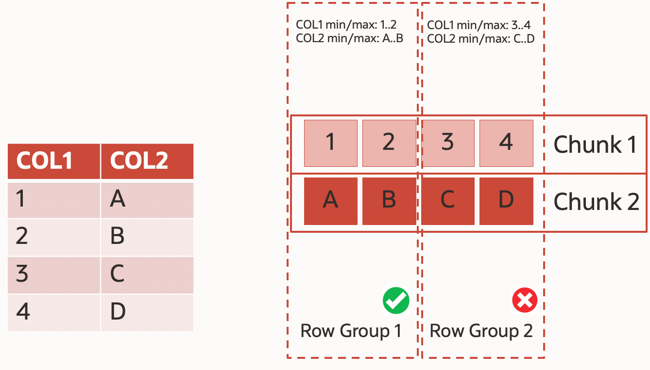

  • Predicate Push Down
Predicate Pushdown
I will not go too deep into the technical details of how Parquet files are organized (for those of you who want, here is the parquet open source standard specification), but each file is divided into chunks (called row groups), and each of those chunks has metadata for each column (min/max value). Row Groups are a way to implement hybrid row/column storage where rows are joint into row groups and within a row group stored by columns. A single Row Group contains data for all columns for some number of rows. This is pretty much exactly what Oracle Hybrid Columnar Compression does as well. A smart reader can use these metadata and skip reading part of the file based on SQL predicates. For example, look at the following query:
select * from my_table where col1=1;
Accessing the file illustrated in the graphic above, this query will only read one row group (because of col1=1 predicate) and will skip scan the second Row Group
