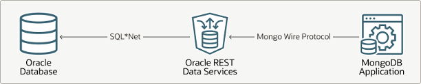

The MongoDB API is an integral part of ORDS. It rewrites MongoDB requests into appropriate Oracle SQL or SODA operations and passes them to the Oracle database server over SQL*Net. Storing your documents centrally in an Oracle Database enables you to provide MongoDB compatibility with your data stored and managed in the most mature, mission-critical Oracle Database and enhance your capabilities to work with the data beyond pure document-store APIs, such as full SQL/JSON access for analytics.
MongoDB and ORDS - architecture
You need to deploy ORDS as a standalone application, meaning that the ORDS process spins up its own Jetty Web Server. Such a deployment has the advantage of requiring only Java and a minimal resource footprint.
