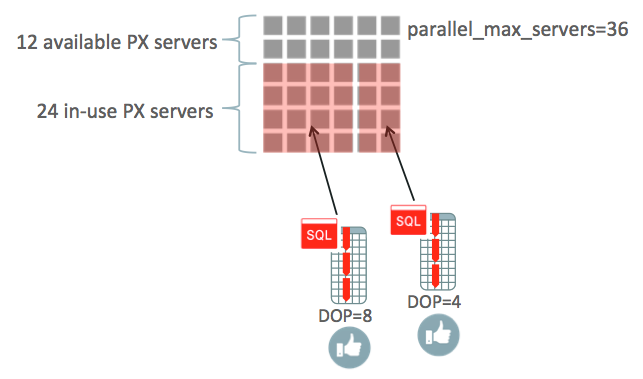

When a SQL statement requires PX servers these processes are allocated from the PX server pool. The number of PX servers required for a statement depends on the degree of parallelism (DOP) and the execution plan shape. Most statements are executed with DOP*2 number of PX servers because of the producer/consumer model. There are rare cases when a statement uses more than DOP*2 number of PX servers depending on the plan shape. Let’s not go into the details of when this can happen as I will cover these cases in another blog post soon.
Here is an example showing two queries running on an instance with parallel_max_servers=36. One query is running with DOP=8 and using 16 PX servers, the other query is running with DOP=4 and using 8 PX servers.
As you see in the picture there are 12 PX servers not used by any statement, these are available for any statement.

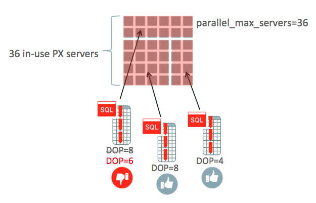

Continuing with the same example the following picture shows a new query submitted with DOP=8 and requires 16 PX servers.
Since there are only 12 available PX servers this statement gets downgraded from DOP=8 to DOP=6 and gets all 12 available PX servers.

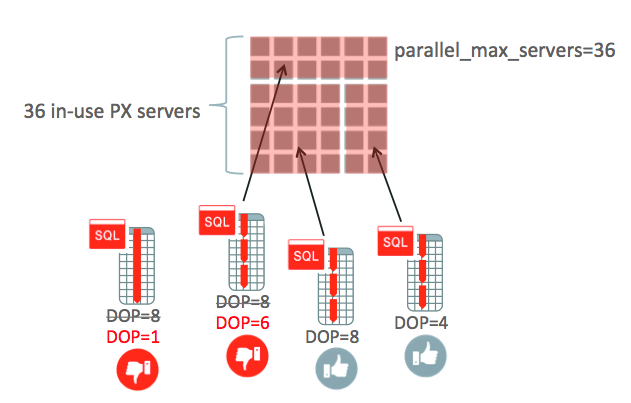

Consider another query submitted at this time with DOP=8. Even though this query requires 16 PX servers it will be given none because there are no available PX servers left. This query gets downgraded to DOP=1 and runs serially.

DOP downgrades can have a huge negative impact on SQL performance. It is not easy to quantify this impact without testing your query with different DOPs as it depends on the scalability of the statement and the downgrade percentage. If your statement gets downgraded from DOP=48 to DOP=36 maybe you can live with that but it gets worse as the downgrade percentage gets higher. For example, if the last statement above would complete in 10 minutes with DOP=8, it will now finish in 80 minutes assuming linear scalability as it will be using one process instead of eight. A statement cannot change its DOP after it starts, so even if the required number of PX servers become available just at the start of execution this statement will not be able to use them.
DOP downgrades due to PX server shortage also makes your SQL performance unpredictable. The performance of a statement depends on the number of available PX servers when it is executed, there is no guarentee that it will get the required number of PX servers. This causes users to get widely varying response times for the same statement.
