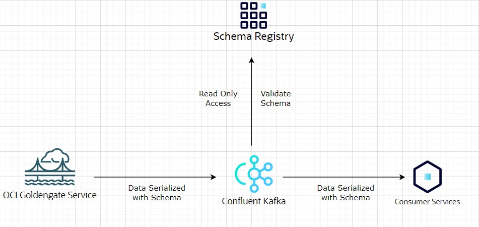

Architecture:
Use Case:
In this setup we have a requirement to only provide read only access to schema registry as we want to control the schema changes.
As by default OCI GG would update the schema registry with the new schema if any DDL change is done on the source table.

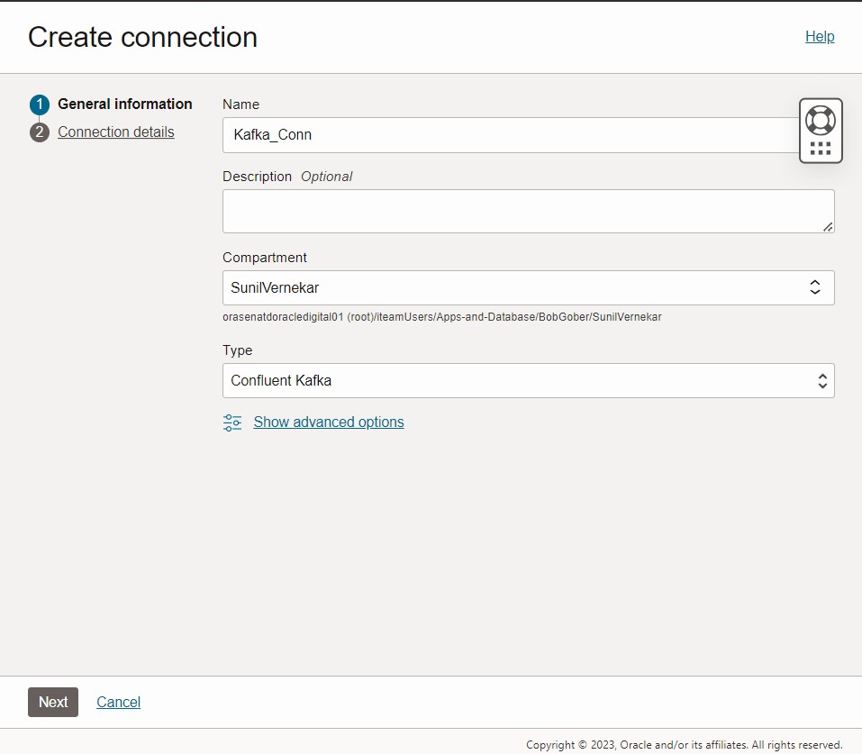

We can update the custom properties in connection section of OCI GG Service.

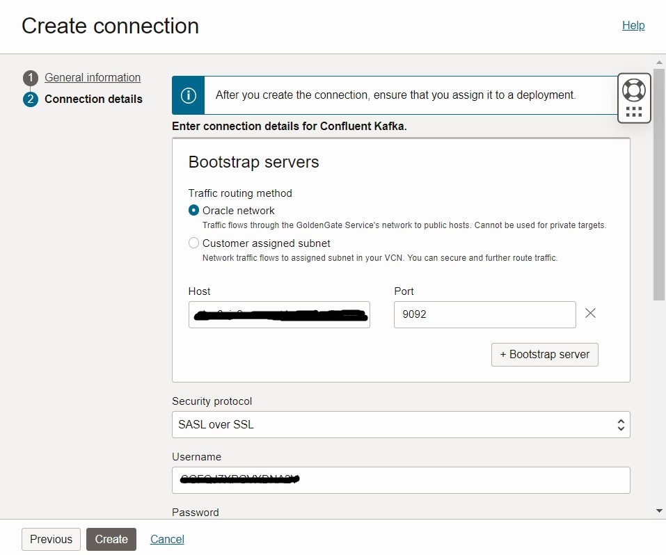

2. We would create 2 connections while replicating to confluent kafka. Assuming we already have created these connections
- Kafka connection
- schema registry connection
you can follow below blog to setup the replication to Kafka platforms.
Using Oracle Cloud Infrastructure GoldenGate with Kafka Platforms

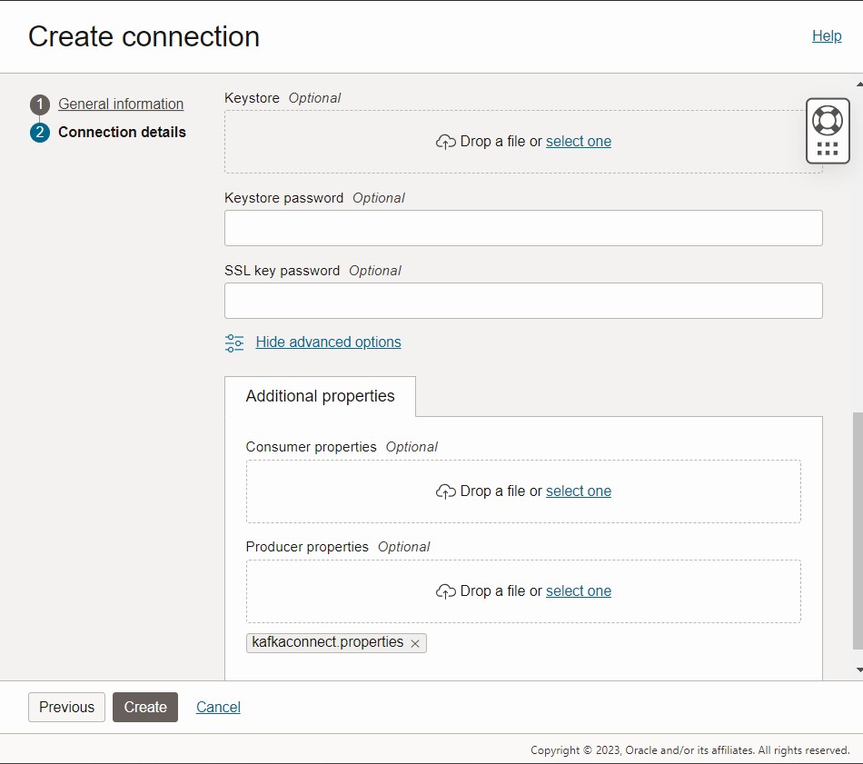

We would need to use the below custom properties while we have the write access to schema registry. So, we would create a file with following properties and upload it to your Kafka Connection
key.converter=org.apache.kafka.connect.storage.StringConverter
value.converter=io.confluent.connect.avro.AvroConverter
value.converter.auto.register.schemas=true
value.converter.use.latest.version=false
Or you can upload them while creating a new kafka connection.
You would find the option to upload the custom properties in
Show Advanced Options à Update additional properties à Producer properties
3. Once the replicat has created schemas for all the tables you can stop the replicat and remove the write access from the schema registry for GG user.
And edit the kafka connection and upload file with the below properties.
value.converter.auto.register.schemas=false
value.converter.use.latest.version=true
