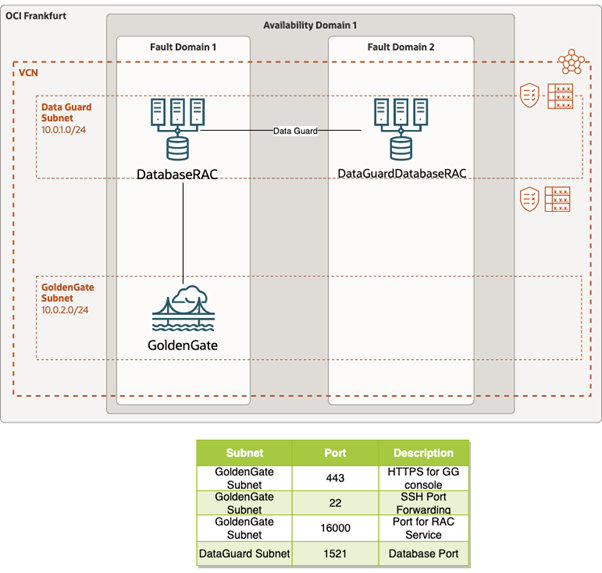

In the architecture diagram below, we have deployed the Oracle database in the ‘Data Guard’ subnet and OCI GoldenGate in the ‘GoldenGate’ subnet. The ‘Data Guard’ subnet must have an ingress rule allowing connectivity to port 1521, while the ‘GoldenGate’ subnet requires an ingress rule allowing connectivity to port 443 to open the GoldenGate private endpoint. Port 22 is also necessary for connecting to a private OCI GoldenGate instance through a Bastion. Additionally, OCI GoldenGate automatically assigns port 16000 to RAC environments using a SCAN proxy created by OCI Private Endpoints.

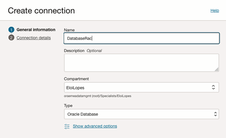

Navigate to Oracle Database > GoldenGate in the OCI Console, then click on Connections.

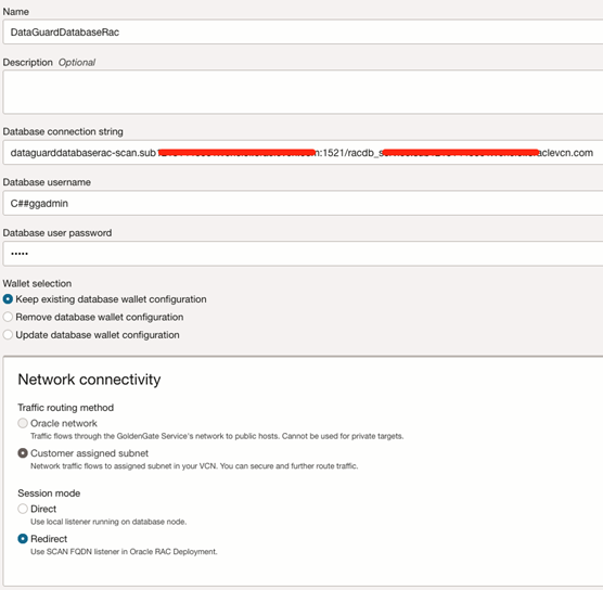

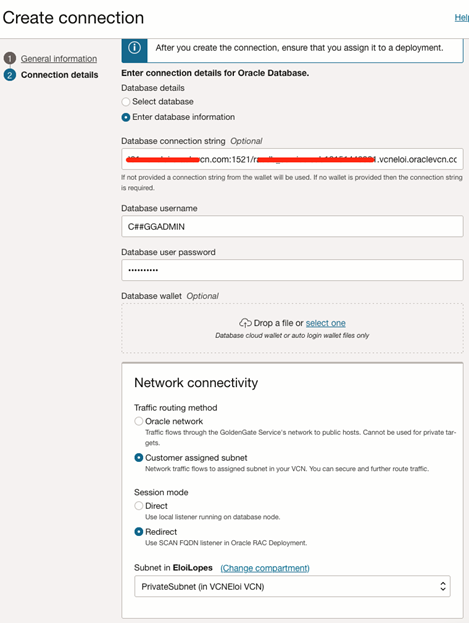

Click on “Create Connection”, provide a connection name, and select the option “Oracle Database”:
Provide a database connection string with a valid format, for example: <database name>:<database port>/<service_name>

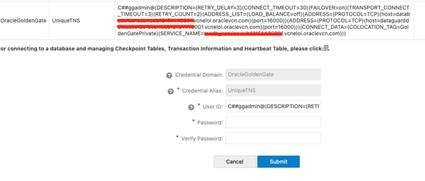

You have two credentials for each Real Application Cluster (RAC) at this stage. What you need is to create a credential that utilizes both RACs. To achieve this, you must create another credential from the GoldenGate console. It is necessary because OCI GoldenGate has already registered both databases in its tenancy, allowing access to both, but in separate connections. We must combine them by creating a third credential from the GoldenGate Console.
Create a dedicated credential for Data Guard in the GoldenGate console.
OCI GoldenGate accesses RAC environments using a SCAN proxy created by OCI Private Endpoints. It uses port 16000 here to access my RAC database which is why I am reusing it here.

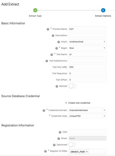

Create the Extract by specifying the Process Name, Trail Name, and the Credential you previously created (UniqueTNS):

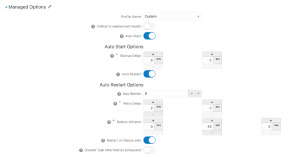

In the “Managed Options” section, please configure the Extract to auto-start and auto-restart. Adjust the configuration based on your Recovery Time Objective (RTO). In the example configuration below, the Extract is set to retry 9 times, with a 2-minute wait after each retry. If the Extract fails to connect to the database after 45 minutes, it will stop retrying.
