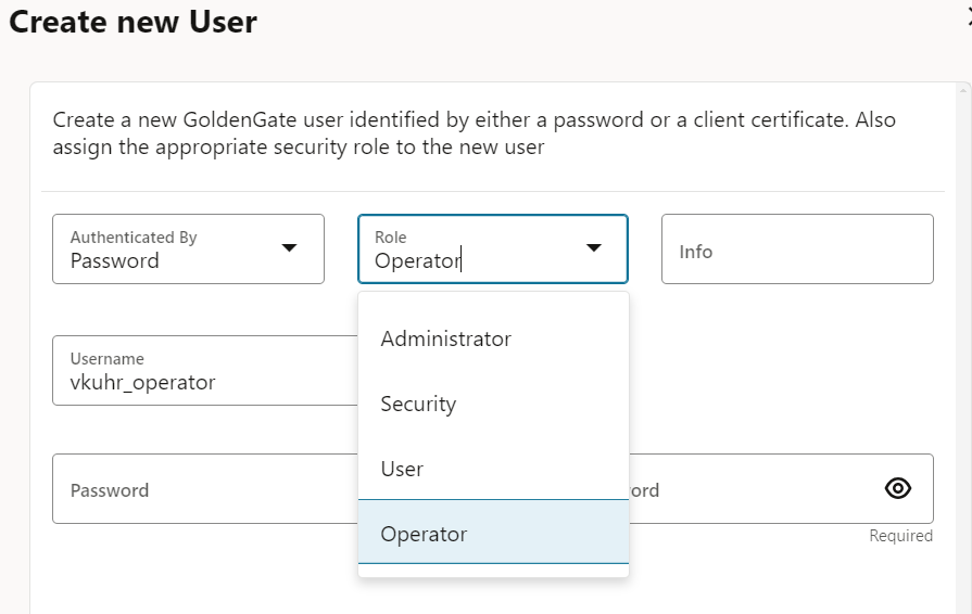

 For the Authorization (AuthZ), there are fixed hierarchical roles that can be used:
  • User role: Can only be used to retrieve information (get info, stats, status…)
  • Operator role: Ability to start/stop processes on top of User privileges.
  • Administrator role: Add/Delete/Modify process privileges on top of Operator privileges.
  • Security role:  User management privileges on top of Administrator privileges

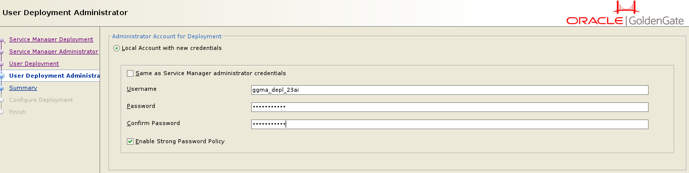

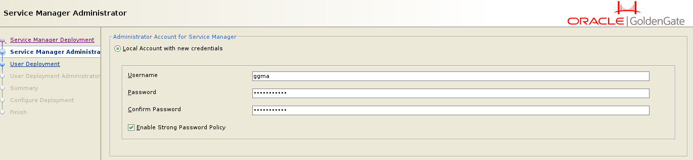

GoldenGate Deployment and Administrator Accounts
When you first deploy a GoldenGate, you’ll set up two deployments: the Service Manager and the User Deployment. Each deployment has its own security user, and it’s essential to define the credentials (username and password) for the Service Manager Security user.
The credentials (username/password) you provide are used to connect to GoldenGate. In the Microservice Architecture, you can connect remotely to the GoldenGate using the WEB-UI, AdminClient commands, or REST API calls. This represents a significant advantage over the legacy GoldenGate Architecture, where connections had to be made directly on the server using the ggsci program.
The Security User for the Service Manager holds the highest level of authority, functioning as a “Super User” with extensive control. This role manages the services for each user deployment. You can either use the same credentials across all deployments or choose to set up unique credentials for each one.
Each user deployment includes a Security user, which you define during the deployment process. With the GoldenGate Micro Service Architecture, additional Administrator Accounts are introduced to manage the deployment. This new feature means that, in addition to Database accounts, there are now specific Administrator Accounts within the GoldenGate deployment itself.

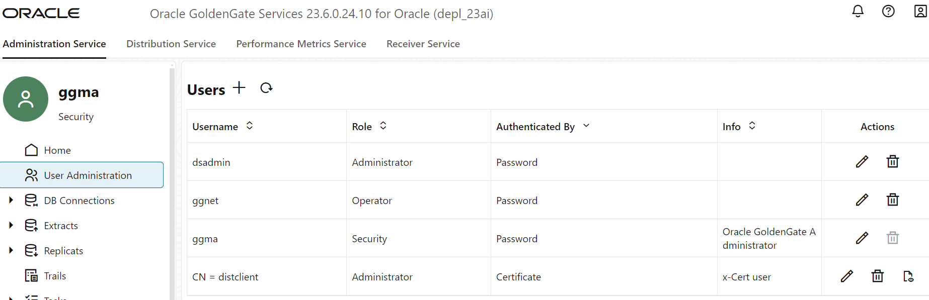

After deploying the GoldenGate, you can add more users directly through the WEB-UI, which includes a dedicated User Management section.
You also have the option to manage users by using REST API calls directly.
Here are three engaging ways to handle user authentication:
  • Local User with Password: This traditional approach involves creating a local user account secured by a password. It’s a straightforward method to grant team members access to GoldenGate.
  • Local User with Certificate: For enhanced security, you can authenticate a local user using a certificate. Here, the username is derived from the certificate you apply. This is particularly useful for Distribution Path users utilizing the secure Web Socket (WSS) protocol. When setting up a DistPath DPNS from the source to the target system, you’ll use a client certificate on the source system, which authorizes the DistPath on the target system.
  • External User with Identity Provider: Alternatively, you can authenticate users through an external Identity Provider, such as IAM (Cloud) or OAM (On-Premises). This blog focuses on local user setups, but you’ll find other resources that delve into integrating with external identity providers.

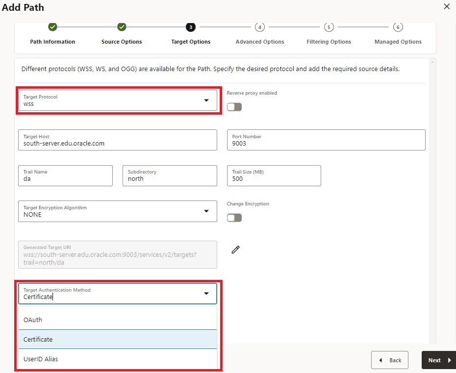

In addition to managing operational and administrative users, user management also extends to the Distribution Path. Typically, you’ll use either the secure Web Socket protocol (WSS) or the standard Web Socket protocol (WS). There is also an legacy OGG protocol for connecting with classic GoldenGate architectures, though this Blog does not cover that aspect.
  • When setting up a DistPath using the secure Web Socket protocol (WSS), you have several authentication options for the target user: OAuth (not covered in this Blog), certificates (as mentioned earlier), or credentials (username/password).
A screenshot of a computer
Description automatically generated
  • The Certificate option requires a client Certificate at the source (which you might have used during deployment). At the target, the user is authenticated by this certificate, and in this context, you must also apply for the signing CA certificate.
  • The USERIDALIAS option requires a USERIDALIAS at the source deployment so that Authentication can be done.
  • If you are setting up a DistPath using the Web Socket protocol (WS), you only have the choice to use the USERIDALIAS option.

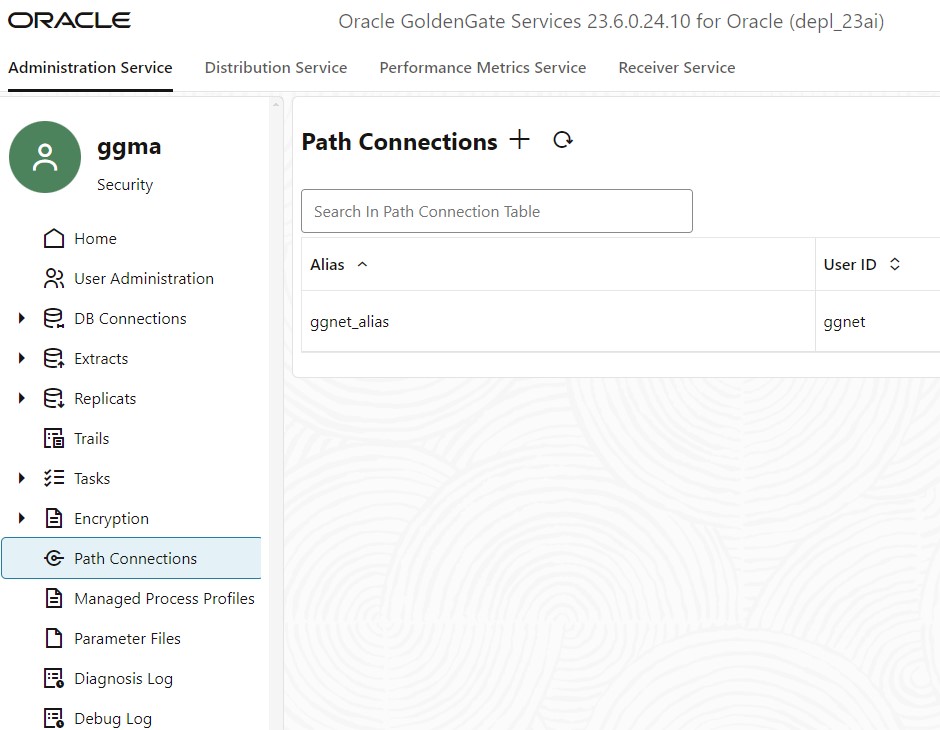

For the cases using UserIDAlias, I want to highlight that in GoldenGate 23ai, there is a new additional section about Path Connections.
