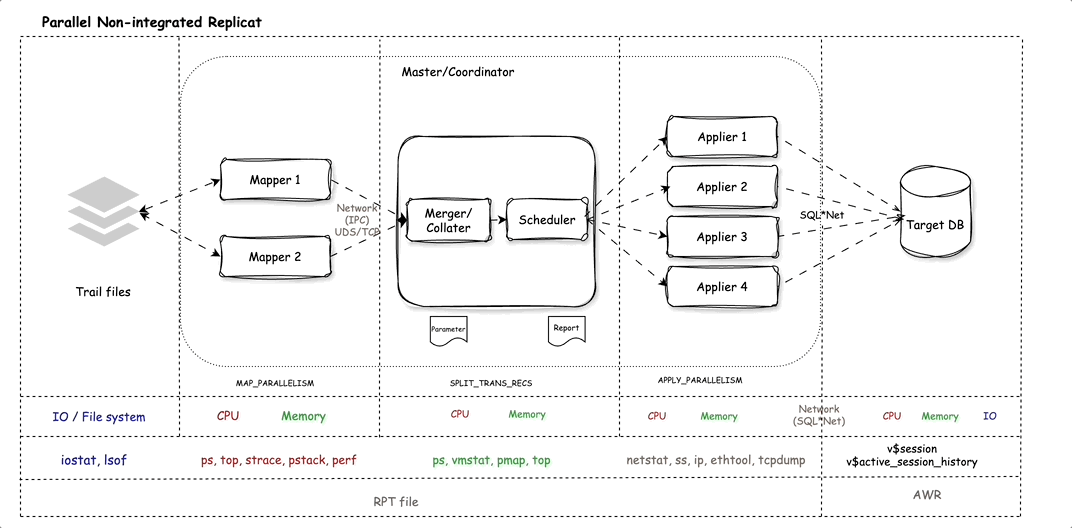

Meet the Pipeline
Think of Parallel Replicat as a relay team, passing transactions from one stage to the next. Here’s how the data flows:
  • Trail files (on disk)
  • Mappers – Parse trail data and map it to relevant tables
  • Merger (Collator) – Sorts records by SCN to preserve logical order
  • Scheduler – Calculates dependencies between transactions
  • Appliers (client-side) – Sends SQL to the corresponding server/shadow process in the target database for execution
  • Network – Between the GoldenGate hub where Parallel Replicat is configured and the target server where Oracle RDBMS is hosted
Applier server/shadow processes – Executes SQL on behalf of client applier sessions in the target database
Parallel Non-Integrated Replicat Data Flow
Non-Integrated Parallel Replicat Data Flow
All of this is orchestrated by a coordinator process, which owns and manages the pipeline. Some components are child processes (like mappers) of the coordinator process, while others are lightweight threads (LWPs in Linux).
Each part of the pipeline plays a critical role. For example:
  • Mappers kick things off by reading trail data and performing mapping.
  • The merger ensures SCN order.
  • The scheduler handles dependency calculation.
  • And the appliers do the final job of executing SQL in the target database.
The beauty of Parallel Replicat is in its design: it allows parallel execution without strict transaction ordering. That doesn’t mean it runs transactions out of order and breaks constraints, it performs dependency calculations and applies as many operations in parallel as possible, safely.

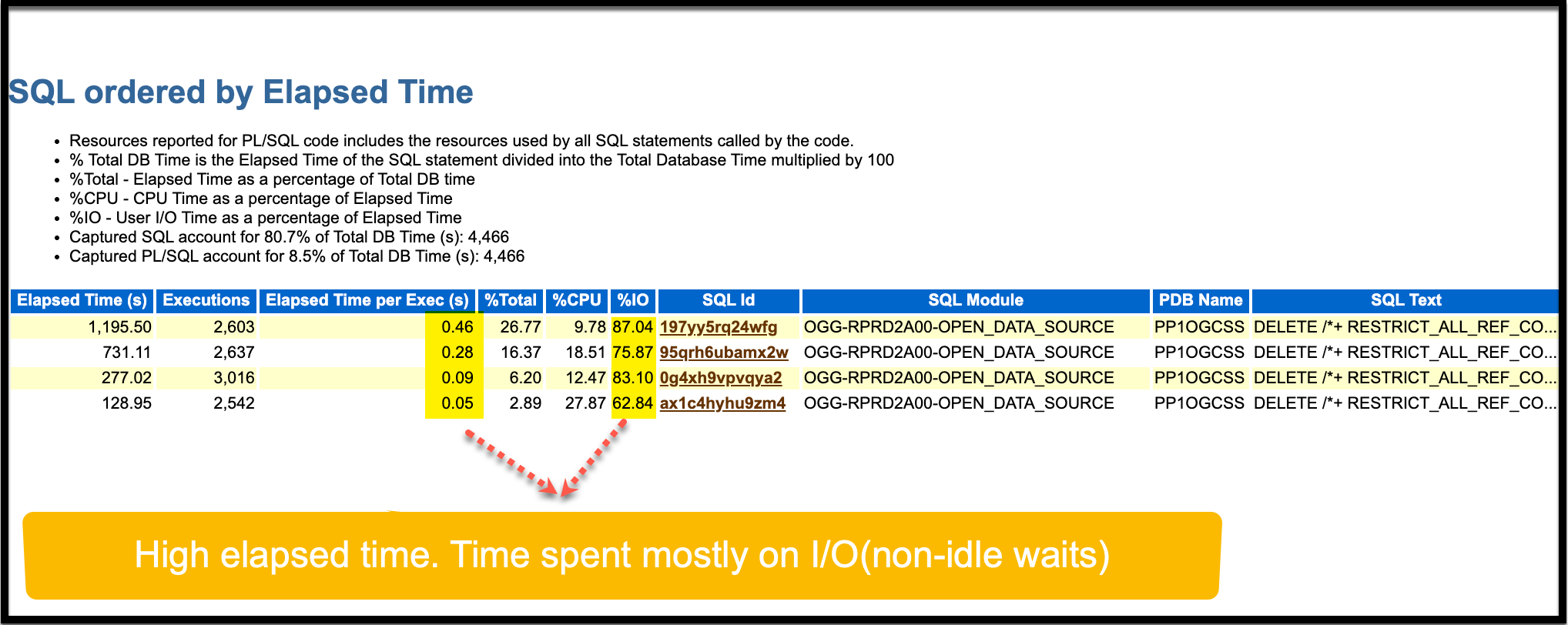

Follow the Trail: SQL Ordered by Elapsed Time
To begin your investigation, open the AWR (Automatic Workload Repository) report for the time window corresponding to the period of observed apply lag. Navigate to the section titled “SQL ordered by Elapsed Time.” This section lists the SQL statements that took the most cumulative time to execute during the snapshot interval and is one of the most effective starting points for identifying inefficient SQL driving bottlenecks.
Your objective here is to identify the SQLs issued by the Parallel Replicat applier sessions that are consuming excessive database resources.
 How to do that?
Check the MODULE column to identify SQLs executed by the Parallel Replicat sessions. These entries represent DML or DDL operations being applied to the target database as part of your replication workload.
Once you’ve isolated the relevant SQLs, pay close attention to the “Elapsed Time” and “%DB Time” columns. These values indicate how much wall-clock time and proportion of total database time were spent executing each SQL. If a particular SQL has both high elapsed time and is associated with a Replicat module, it’s a prime candidate for further analysis.
 Ask yourself:
  • Is the elapsed time for these SQLs driven mostly by non-idle waits, such as I/O operations, latch contention, row-level locking, or high CPU usage?
    •  If the answer is non-idle waits, then you’ve found a likely bottleneck, one that should be prioritized for deeper investigation and tuning.
Understanding these non-idle wait events will help determine the underlying cause, whether it’s related to missing indexes, poor table design (e.g., no primary key), locking issues, or I/O constraints. From there, you can decide what corrective actions are appropriate: optimizing SQL, tuning the schema, or isolating slow tables into separate Replicat groups.
By starting with “SQL ordered by Elapsed Time” and focusing on non-idle waits in Parallel Replicat-applied SQL, you are zeroing in on exactly where database time is being consumed, allowing for targeted, high-impact tuning to reduce apply lag and improve throughput.
But what if the appliers are CPU-bound?
  • Increase the the number of appliers. That should increase DB Time/sec, which in turn should boost apply throughput.
But if you observe high CPU usage in the target database along with a high number of buffer gets for the Parallel Replicat apply sessions, this is often indicative of inefficient data access paths during apply operations. One of the most common reasons for this is when the target table lacks a primary key (PK) or unique index (UI).
Without a defined PK or UI, the Replicat process cannot uniquely identify the target row based on the key values from the trail. As a result, it may be forced to perform full table scans or, in some cases, index range scans if there is a non-unique index present. These access paths are much more expensive in terms of logical I/O:
  • A full table scan reads every block in the table to find a match, which can drive a large number of buffer gets, especially for wide or high-row-count tables.
  • An index range scan, although slightly more efficient, may still access numerous index and table blocks if the index is not selective enough.
Over time, especially with high transaction volumes, these suboptimal access paths can severely impact CPU performance and cause significant contention for system resources like buffer cache and CPU cycles.
To mitigate this issue:
  • If the application logic allows, consider temporarily adding primary keys or unique indexes on those target tables to help the Replicat process apply changes more efficiently.
  • Alternatively, isolate such tables that lack PK/UI along with their associated child tables referenced through referential integrity into separate replicat groups. This ensures that even if those particular tables incur latency due to full scans, they do not become a bottleneck for other tables in the same Replicat configuration.
  • Accept that replicats operating on tables without PK/UI will naturally perform slower for update and delete operations, but by decoupling them, you contain the performance impact and improve overall pipeline throughput.Taking these steps helps ensure that apply lag is localized to the problematic tables and does not cascade to otherwise well-performing parts of your replication workload.
SQL statistics ordered by elapsed time

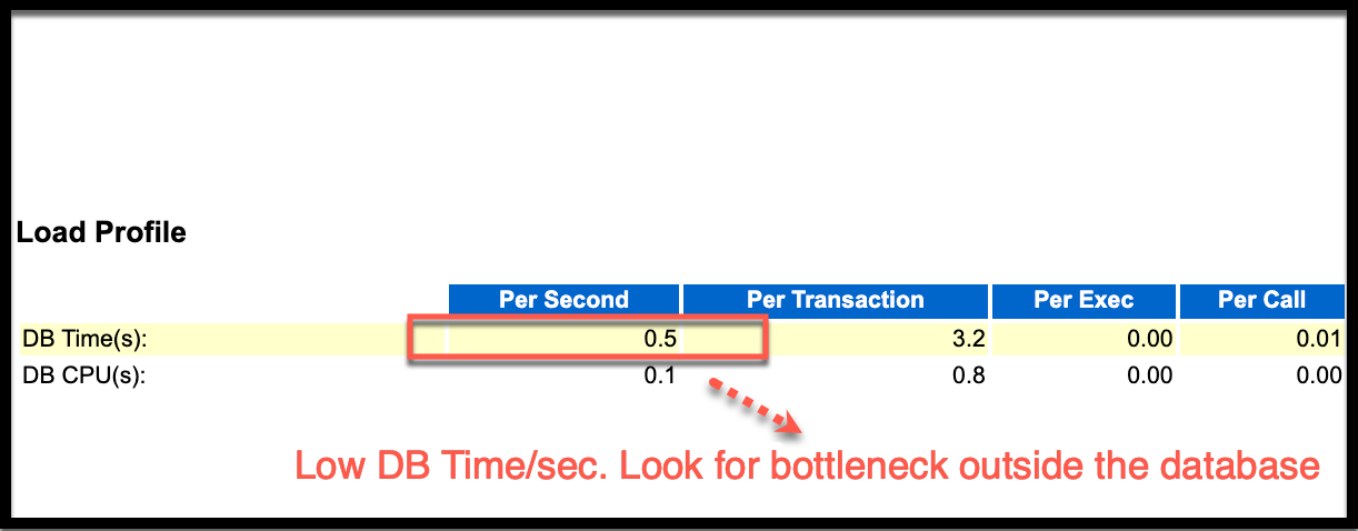

What If DB Time/sec Is Low?
If DB Time/sec is 1 or less, that tells a different story. It means the database isn’t doing much. Not because it’s idle, but because it’s not being fed work fast enough.
This points to a bottleneck outside the database, somewhere upstream in the replication pipeline.
That’s exactly where we go next.
DB Time/sec low. Time to look outside the DB
DB Time/sec low. Time to look outside the database

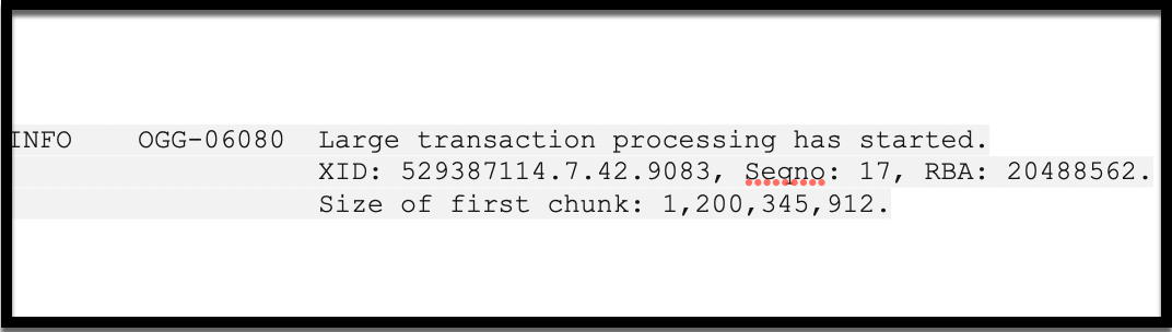

Long Transactions
One of the most common reasons Parallel Replicat may fallback to serialized apply is when it encounters a large transaction. By design, Parallel Replicat doesn’t break transactions by default. Each transaction is applied in full by a single applier thread to preserve atomicity and maintain referential integrity.
Whether a transaction is treated as “large” and forces serialization depends on the value of the CHUNK_SIZE parameter.
How CHUNK_SIZE Works
  • CHUNK_SIZE defines the maximum size in bytes for a transaction to still be considered safe for parallel apply.
  • The default value is 1 GB. If a transaction exceeds this threshold, Replicat treats it as barrier transaction, which forces serialization across the pipeline.
What Is a Barrier Transaction?
When Replicat encounters a barrier transaction:
  1. All prior transactions should be applied first.
  2. The large transaction is then applied serially by a single applier thread.
  3. Only after this transaction is fully applied and committed, Replicat resumes reading and scheduling other transactions.
This barrier behavior introduces a temporary full stop in parallel processing, so while Replicat remains active, it applies nothing else until the large transaction completes.
Examples to Illustrate Behavior
Let’s consider two transactions under the following configuration:
  • SPLIT_TRANS_RECS = 50000
  • CHUNK_SIZE is unset, meaning the default 1 GB applies
Example 1: Transaction size = 500 MB, number of changes = 200,000
Since this transaction is below the 1 GB CHUNK_SIZE, Replicat does not serialize it.
  • Replicat splits the transaction into four pieces:
    • (a) Changes 1–50,000
    • (b) Changes 50,001–100,000
    • (c) Changes 100,001–150,000
    • (d) Changes 150,001–200,000
  • These four pieces are evaluated for dependencies.
    • If no dependency exists, all four pieces can be applied in parallel, and they might even commit out of order.
    • If dependencies do exist (e.g., updates to the same rows), Replicat will enforce ordered apply, based on data dendencies. They may still be committed as four separate transactions if transactional boundaries allow.
Example 2: Transaction size = 100 GB, number of changes = 1,000,000 (LOB-heavy)
Though this transaction is broken into twenty pieces (50k changes each), each piece is still ~5 GB in size, exceeding the 1 GB CHUNK_SIZE.
  • In this case, even each piece is considered a large transaction.
  • Replicat marks the entire transaction as a barrier.
    • All other transactions are paused.
    • Transactions are applied serially by single applier thread.
    • No other scheduling occurs until these large transactions completes.
 Best Practices
  • Avoid increasing CHUNK_SIZE unless you’re absolutely sure the system has enough memory headroom. A larger chunk size leads to greater memory consumption and may impact stability under load.
  • Instead, set SPLIT_TRANS_RECS to a reasonable value (e.g., 100,000). This enables large transactions to be divided into manageable pieces, which Replicat can potentially apply in parallel, provided dependencies allow.
  • Well-chosen SPLIT_TRANS_RECS values reduce the likelihood of hitting CHUNK_SIZE limits, enabling more scalable and efficient parallel apply.
Snippet from Parallel Replicat report file showing serialization due to long transaction

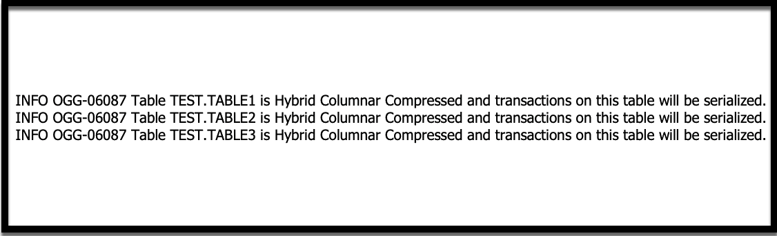

EHCC (Exadata Hybrid Columnar Compression)
One of the lesser-known yet significant challenges in maintaining parallelism in Oracle GoldenGate Replicat is the presence of EHCC-compressed tables on the target. EHCC, or Exadata Hybrid Columnar Compression, is a space-saving technology used in Oracle databases, especially in Exadata, that organizes data by column within compression units, rather than storing each row individually.
Why EHCC Affects Parallel Replicat
EHCC changes the physical storage and locking behavior of the table:
  • Rows are grouped into compression units. These large blocks (potentially containing thousands of rows) that are compressed together.
  • When any single row in a compression unit is updated, the entire compression unit is locked at the storage level.
  • This means that even if two different threads are trying to update two unrelated rows, if those rows happen to exist in the same compression unit, Oracle will escalate the lock to that unit.
What’s the consequence?
When Parallel Replicat tries to apply changes using multiple applier threads:
  • Two appliers working on different rows may block each other unintentionally.
  • This can lead to deadlocks, blocking sessions, and hence forced fallback to serialized apply, degrading performance.

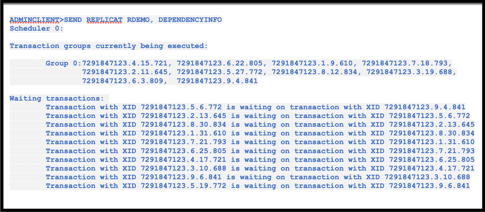

You’ll often observe warning messages in Replicat report file indicating serialization due to EHCC locking behavior.
Recommended Fixes
To avoid performance degradation and maintain parallel apply efficiency, you can:
Isolate EHCC Tables into a Separate Replicat Group
  • By moving EHCC tables into their own dedicated Replicat, you ensure that any locking-related serialization does not impact the rest of your schema.
  • It allows non-EHCC tables to continue benefiting from full parallelism, preserving throughput for the majority of the workload.
Set Hidden Parameter: _pr_serialize_ehcc = false—->(this parameter should be used only under guidance from Oracle support)
  • This disables the special EHCC-aware serialization logic in Replicat, allowing parallel apply even on EHCC tables.
  • Use with caution: Since EHCC locking is coarse-grained, this may increase the risk of deadlocks between applier threads. If a deadlock does occur, it will roll back the affected transaction and retry, potentially creating additional overhead or instability.
This parameter should only be used after careful testing and if you’re confident that the EHCC tables do not often cause contention under parallel apply.
If you’re running into EHCC-related apply lag and want to confirm the root cause, look for keywords like “Serialized apply” in the Replicat report file. These indicators can help pinpoint whether EHCC behavior is interfering with parallelism.
Snippet from Parallel Replicat report file showing serialization due to compression
Other Reasons for Serialization
Certain advanced features can also trigger serialization in Parallel Replicat. For example, using SQLEXEC to execute custom SQL logic or enabling sequence cache replication, tables with non-scaler data types (BLOB) with deduplication enabled, tables with bitmap indexes,  would force Replicat to serialize transactions to maintain order and consistency. Use these features judiciously in performance-sensitive environments.

How to Detect Dependency Bottlenecks
Use the following commands during runtime to diagnose skew:
  • SEND REPLICAT <name>, DEPENDENCYINFO
High transaction dependency
Reveals internal apply queues and the number of transactions waiting behind dependency fences.

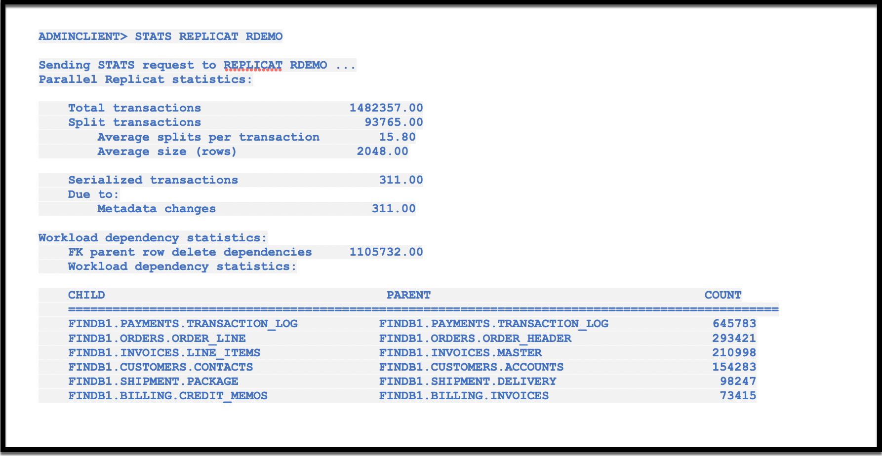

  • STATS REPLICAT <name>
High workload dependency
Shows whether a small number of long-running transactions are blocking a large number of others, indicating dependency skew.
If you notice a high number of dependent transactions queueing up behind a few others, that’s a clear sign that data dependency, not infrastructure is throttling performance.
Fixes and Workarounds
  • Disable Foreign Key Constraints during bulk loads or migrations, if your application logic can tolerate eventual consistency. This removes GoldenGate’s need to honor strict parent-child ordering and can significantly boost throughput.
  • Consider isolating dependent workloads into a separate Replicat with reduced parallelism to minimize cross-transaction dependencies.

Start with the AWR Report:
Begin with an AWR report that covers the lag window. This helps you determine if the problem lies within the database or outside it.
  •     High DB Time per second? Focus on non-idle wait events (like I/O waits, row-level locking, or buffer busy waits) or CPU usage associated with Replicat SQL.
  •     Low DB Time per second? The database is likely not the bottleneck. In that case, shift your attention to outside components, such as Replicat serialization, trail reading, or infrastructure issues like storage and CPU saturation.
This distinction is your first major fork in the troubleshooting path.

  •   Look for serialization messages that explain when and why parallelism was suspended.
  •   Common causes include:
    • Large transactions that exceed CHUNK_SIZE
    • EHCC-compressed tables causing unit-level locks
