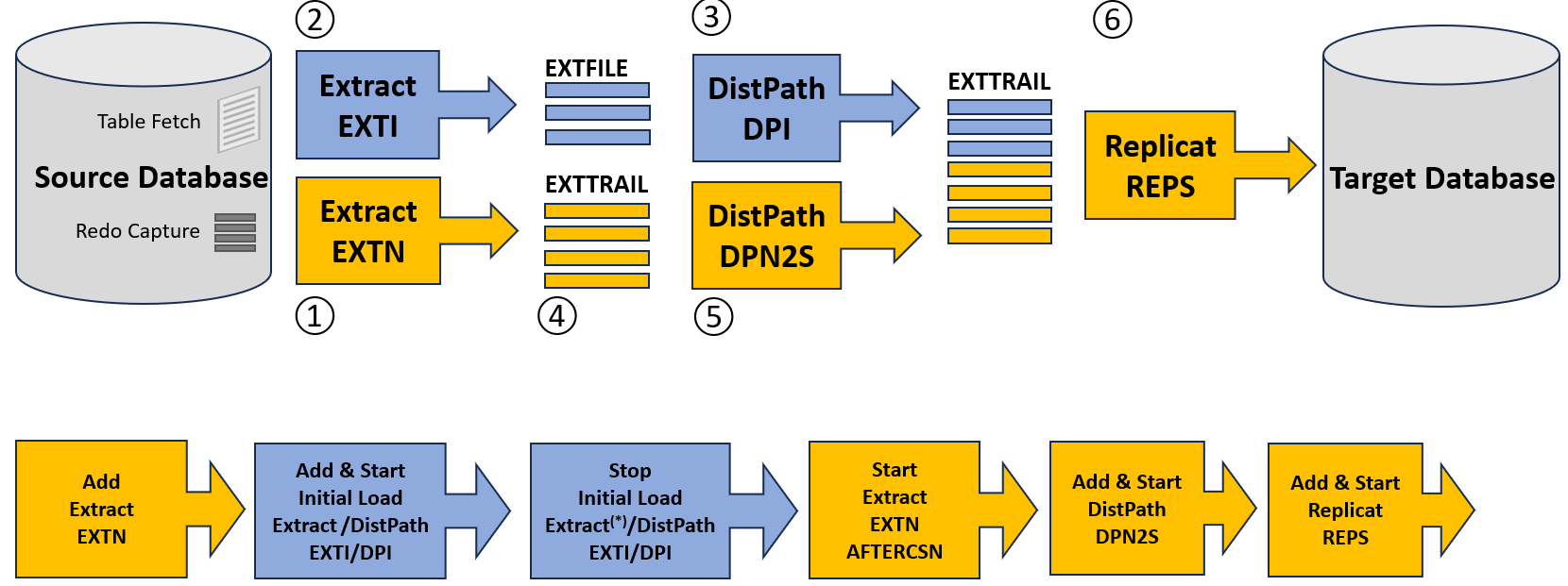

The diagram below outlines the overall workflow, which I’ll explain step-by-step in the following sections. It highlights two distinct phases: the Initial Load replication (shown in blue) and the continuous online change synchronization (shown in orange).
In summary, you set up (but do not start) continuous replication before running the Initial Load, and then start the continuous replication from the point in time when the Initial Load was initiated.
