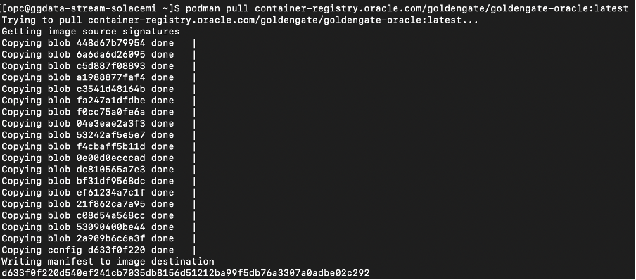

Step 1 – Pull GoldenGate 26ai Container Image
Confirm the GoldenGate image is accessible before proceeding to deployment:
# Pull and Inspect the image locally to confirm access (optional but recommended)
# Login to Oracle Container Registry:
docker login container-registry.oracle.com
# For GoldenGate 26ai (latest)
docker pull container-registry.oracle.com/goldengate/goldengate-oracle:latest
# Inspect the image entrypoint
docker inspect container-registry.oracle.com/ goldengate/goldengate-oracle:latest \
--format '{{.Config.Entrypoint}}'
Verify the image:
docker images

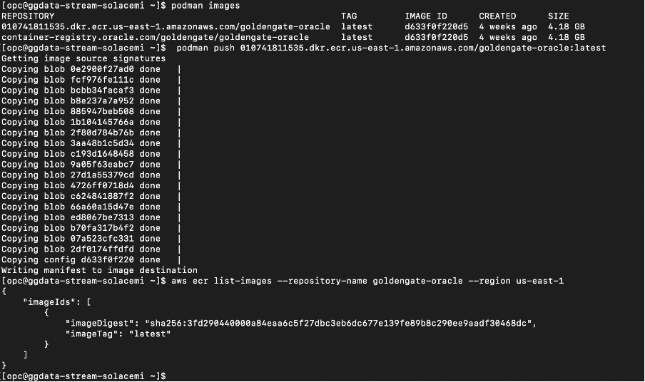

Step 2 – Push the Image to Amazon ECR
After building the Oracle GoldenGate container image locally, the next step is to store it in Amazon Elastic Container Registry (ECR) so that it can be deployed to container services like EKS, ECS, or EC2.
Amazon Elastic Container Registry is a fully managed Docker container registry that makes it easy to store, manage, and deploy container images.
In this step we will:
- Create an ECR repository
- Authenticate Docker to AWS
- Tag the GoldenGate image
- Push the image to ECR
2.1 Create an Amazon ECR Repository
First, create a repository in ECR where the GoldenGate container image will be stored.
Run the following command using the AWS CLI:
aws ecr create-repository \
--repository-name goldengate-oracle \
--region us-east-1
2.2 Authenticate Docker to Amazon ECR
Before pushing the container image, you must authenticate your local Docker client with Amazon ECR.
Run the following command:
aws ecr get-login-password \
--region us-east-1 \
| docker login \
--username AWS \
--password-stdin <ACCOUNT_ID>.dkr.ecr.us-east-1.amazonaws.com
Explanation
- aws ecr get-login-password retrieves an authentication token.
- The token is piped (
|) into the Docker login command. <ACCOUNT_ID>should be replaced with your AWS account ID.
2.3 Tag the GoldenGate Docker Image
Next, tag the existing GoldenGate container image with the ECR repository URI.
docker tag container-registry.oracle.com/goldengate/goldengate-oracle:latest <ACCOUNT_ID>.dkr.ecr.<region>.amazonaws.com/goldengate-oracle:latest
2.4 Push the Image to Amazon ECR
Now push the container image to your ECR repository.
docker push <ACCOUNT_ID>.dkr.ecr.<region>.amazonaws.com/goldengate-oracle:latest

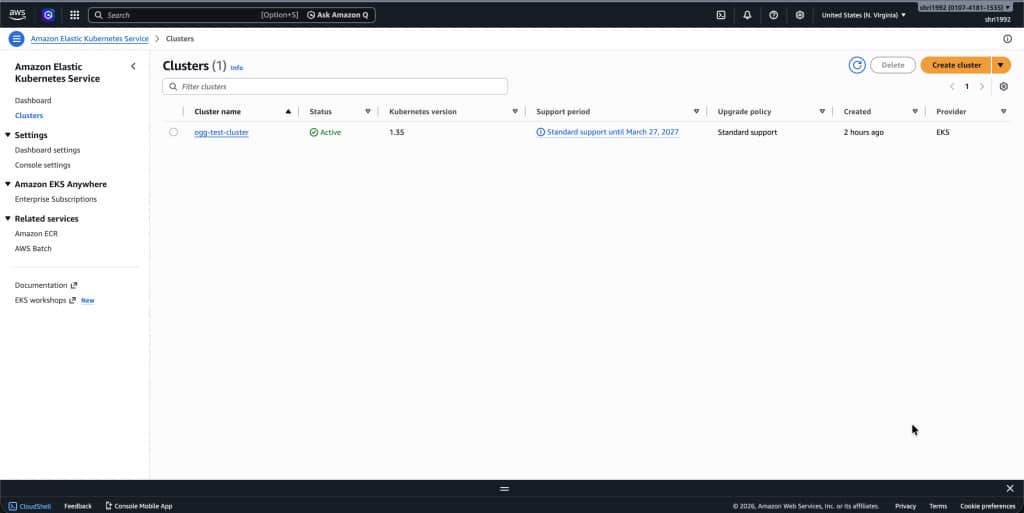

Step 3 – Create an Amazon EKS Cluster
Before deploying Oracle GoldenGate on Kubernetes, you need an operational Amazon EKS cluster where the GoldenGate container will run. Amazon EKS provides a managed Kubernetes control plane, allowing you to focus on deploying and managing workloads while AWS handles the underlying Kubernetes infrastructure, availability, and scaling of the control plane.
We assume that you either already have an EKS cluster available or will create a new one as part of your setup. There are two common ways to provision and configure an EKS cluster:
- Using the AWS Management Console (UI):
The AWS console provides a guided workflow to create an EKS cluster, configure networking, select Kubernetes versions, and add node groups. This approach is useful for users who prefer a graphical interface and step-by-step configuration. - Using the Command Line with
eksctlandkubectl:
Many cloud-native teams prefer infrastructure automation through CLI tools. The open-source tool eksctl simplifies the creation and management of EKS clusters from the command line. After the cluster is created, the standard Kubernetes CLI kubectl is used to configure access, manage namespaces, and deploy workloads to the cluster.
Verify cluster creation:
After creating your Amazon EKS cluster and worker nodes, the first step is to verify that the cluster and its nodes are successfully provisioned.
Run the following command to list the nodes available in your Kubernetes cluster:
kubectl get nodes
If the cluster was created successfully and the worker nodes have joined the cluster, you should see output similar to the following:
NAME STATUS VERSION
ip-172-31-10-11 Ready v1.35
ip-172-31-10-12 Ready v1.35
Expected Output
- The STATUS column should display
Ready - One or more nodes should be listed depending on the node group configuration
- The VERSION column should show the Kubernetes version configured for your cluster
If nodes appear with the Ready status, it confirms that the Kubernetes control plane is communicating correctly with the worker nodes.

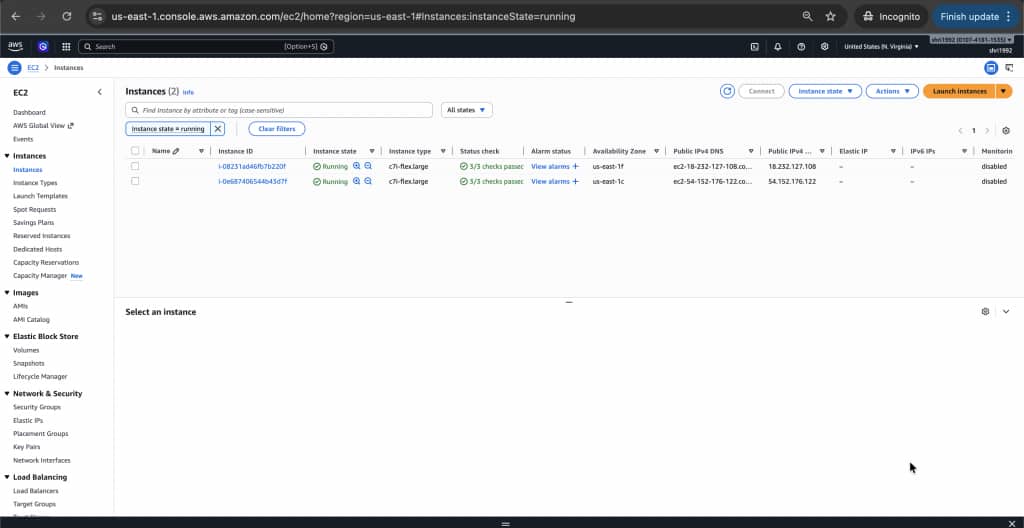

Step 8 – Verify Node Creation
Finally, confirm that the GoldenGate workload is running on one of the cluster nodes.
Run:
~ $ kubectl get pods -n goldengate -w
NAME READY STATUS RESTARTS AGE
goldengate-55fbccb8db-gfx9d 0/1 ContainerCreating 0 6m7s
goldengate-55fbccb8db-gfx9d 1/1 Running 0 6m56s
~ $ kubectl get nodes
NAME STATUS ROLES AGE VERSION
i-08231ad46fb7b220f Ready <none> 16m v1.35.0-eks-ac2d5a0
i-0a64d10b3d1a19b6e Ready <none> 16m v1.35.0-eks-ac2d5a0
This command displays additional details including:
- The node where the pod is scheduled
- Internal IP addresses
- Container runtime information
Verifying this ensures that the GoldenGate pod has been successfully scheduled and is running on a worker node within your EKS cluster.

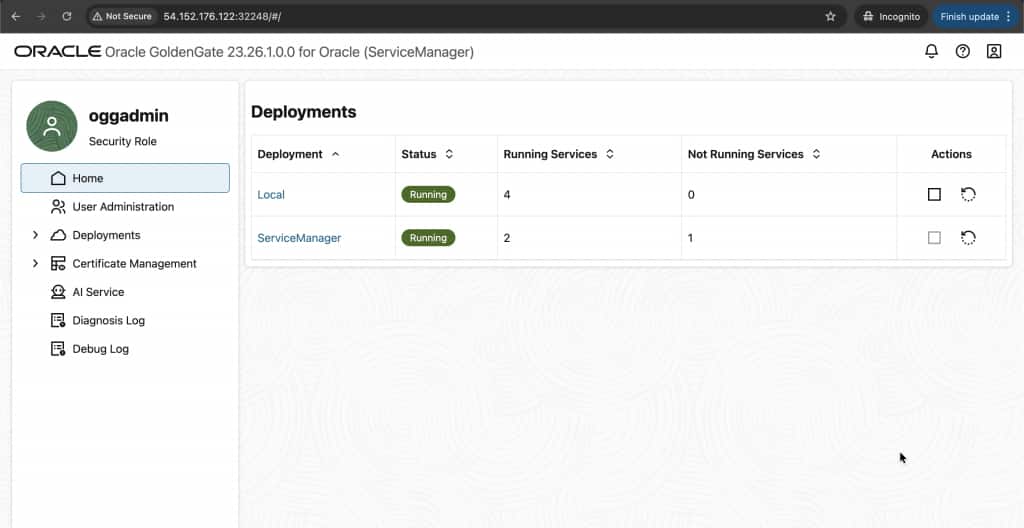

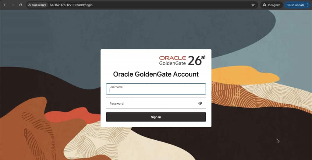

Step 9 – Expose GoldenGate Web UI
After successfully deploying the GoldenGate pod, the next step is to expose the GoldenGate Web UI so that it can be accessed externally. In Kubernetes, this is done by creating a Service that exposes the GoldenGate container port.
For this example, we will create a NodePort service, which exposes the application on a port accessible from the worker node’s public IP address.

Get Node Public IP
To access the service externally, you also need the public IP address of one of the worker nodes in the EKS cluster.
~ $ kubectl get nodes -o wide
NAME STATUS ROLES AGE VERSION INTERNAL-IP EXTERNAL-IP OS-IMAGE KERNEL-VERSION CONTAINER-RUNTIME
i-08231ad46fb7b220f Ready <none> 22m v1.35.0-eks-ac2d5a0 172.31.67.62 18.232.127.108 Bottlerocket (EKS Auto, Standard) 2026.3.3 (aws-k8s-1.35-standard) 6.12.68 containerd://2.1.6+bottlerocket
i-0e687406544b43d7f Ready <none> 3m1s v1.35.0-eks-ac2d5a0 172.31.23.255 54.152.176.122 Bottlerocket (EKS Auto, Standard) 2026.3.3 (aws-k8s-1.35-standard) 6.12.68 containerd://2.1.6+bottlerocket
Note the EXTERNAL-IP value of any available worker node.
Open GoldenGate Web UI
Once you have the node public IP and NodePort, you can access the GoldenGate Web UI from your browser.
Open your browser and navigate to:
http://NODE-IP:NODEPORT
Example:
http://54.152.176.122:32248
You should see the Oracle GoldenGate Administration Service login page, where you can sign in using the administrator credentials configured earlier.

4. Check Node Security Group (Most Common AWS Issue)
One of the most common reasons for not being able to access a NodePort service on Amazon EKS is that the AWS security group attached to the worker nodes blocks the external port.
Your nodes may have public IPs such as:
18.232.127.108
54.152.176.122
However, AWS security groups might still block incoming traffic on the NodePort.
To resolve this:
- Open the AWS Management Console
- Navigate to EC2
- Select Instances
- Locate your EKS worker node
- Identify the Security Group attached to the instance
Add a new Inbound Rule with the following configuration:
| Setting | Value |
| Type | Custom TCP |
| Port | 32248 (your NodePort) |
| Source | 0.0.0.0/0 |
This rule allows external traffic to reach the NodePort exposed by the Kubernetes service.
Once the rule is added, you should be able to access the GoldenGate Web UI using:
Example:
http://18.232.127.108:32248
If the configuration is correct, the GoldenGate Administration Service login page should load successfully.
