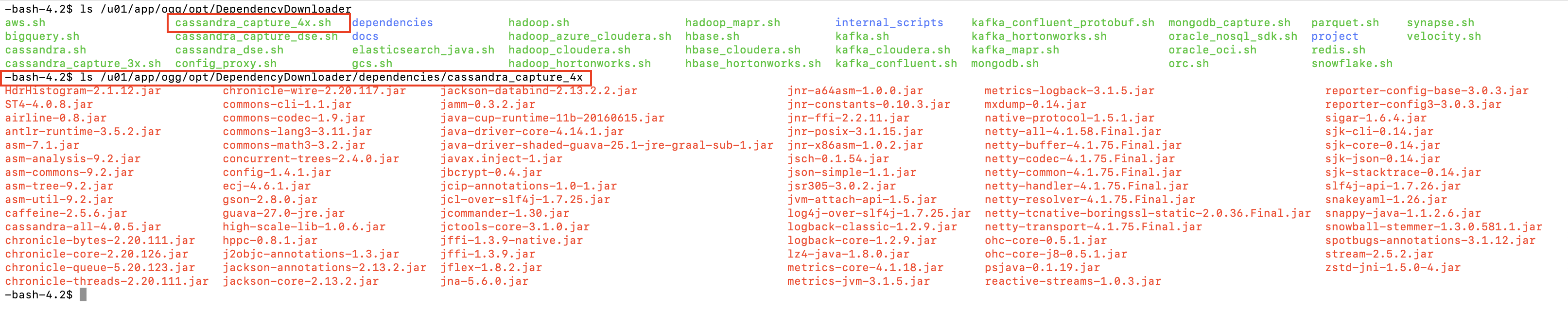

After GoldenGate for Big Data installation is complete, you can use dependency downloader to download dependency jar files for Cassandra 4x. Dependency downloader downloads all the required dependency jar files into a single directory. You can find the dependency downloader at GG_HOME/opt/DependencyDownloader. You can use cassandra_capture_3x.sh for Cassandra 3x dependencies, cassandra_capture_4x.sh for Cassnadra 4x dependencies and cassandra_capture_dse.sh for Datastax DSE dependencies. If you’re extracting from Datastax DSE, please take a copy of Datastax installation into GoldenGate for Big Data server. GoldenGate for Big Data uses some of the libraries from Datastax installation.

For this blog, I executed cassandra_capture_4x.sh. In GG_HOME/opt/DependencyDownloader/dependencies directory, I can see a directory created by dependency downloader. This directory holds all dependency files needed by GGBD to capture from Cassandra 4x.

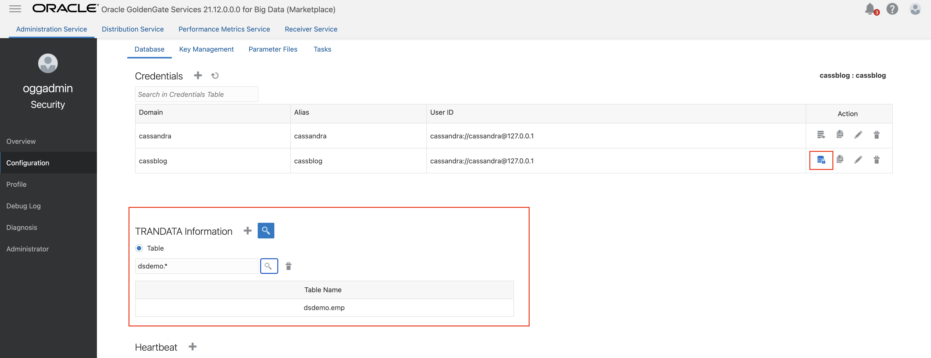

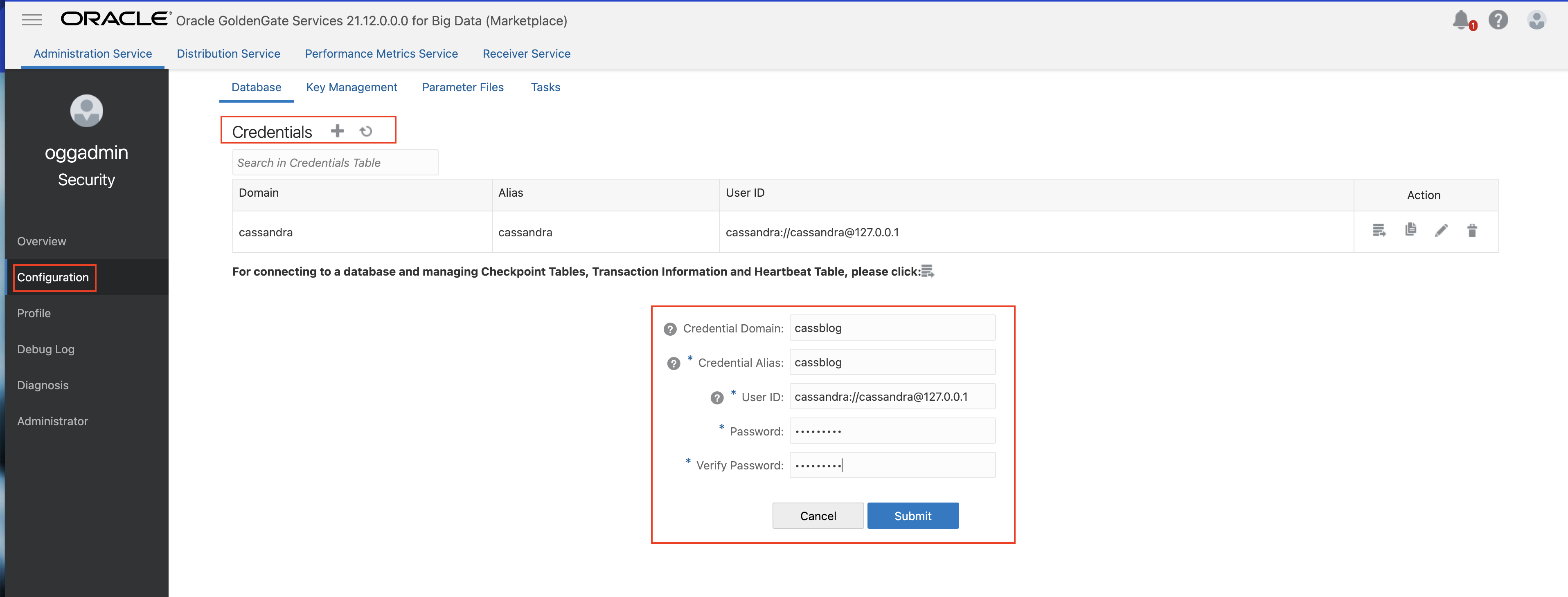

- In GoldenGate for Big Data Administration Service, go to Configuration/ Database and click Add Credentials. Provide Credential Domain, Credential Alias, User ID as cassandra://<user_name>@<cassandra_host> and Password. Click Submit.
If you’re configuring for a Cassandra cluster, you can configure more than one node. For example: cassandra://db-user@127.0.0.1,127.0.0.2:9042.
- Under Action, click Connect to Database to test the connection. If connection is succesful, you see TRANDATA Information. You can search for the source Cassandra table names.

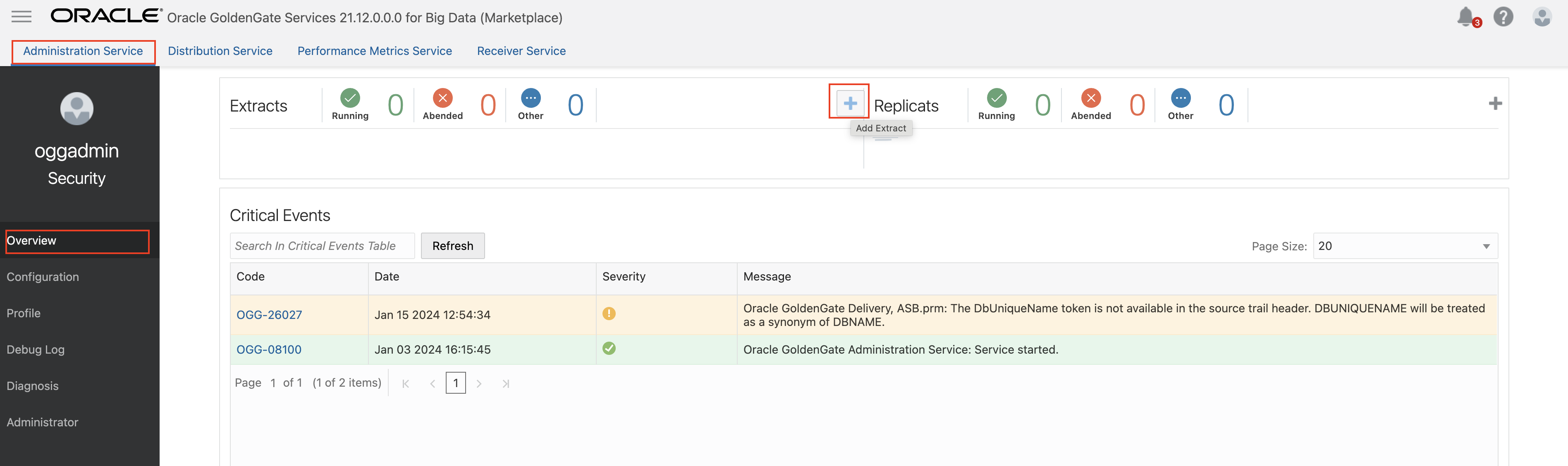

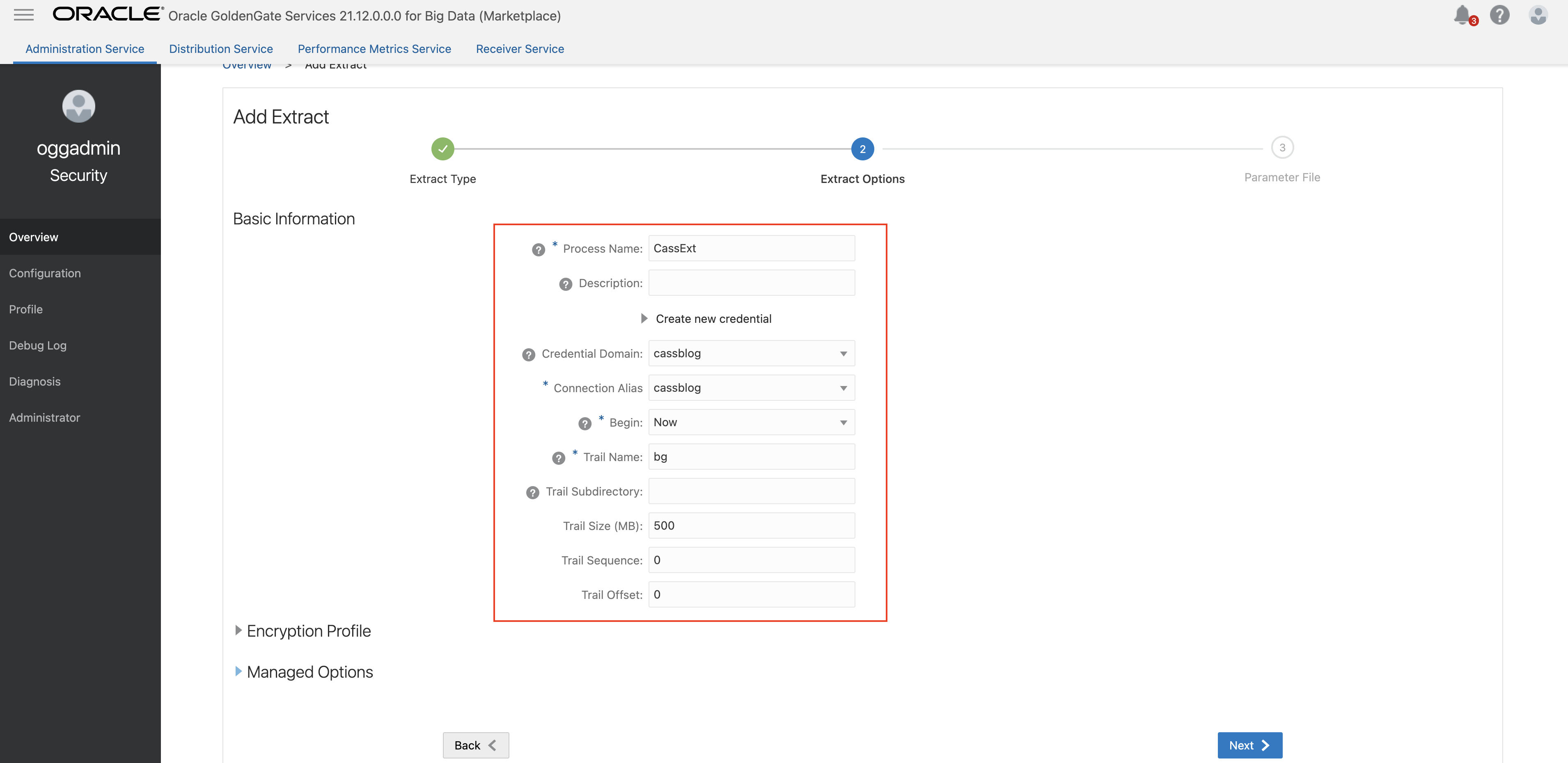

- In GoldenGate for Big Data Administration Service/ Overview, click Add Extract.

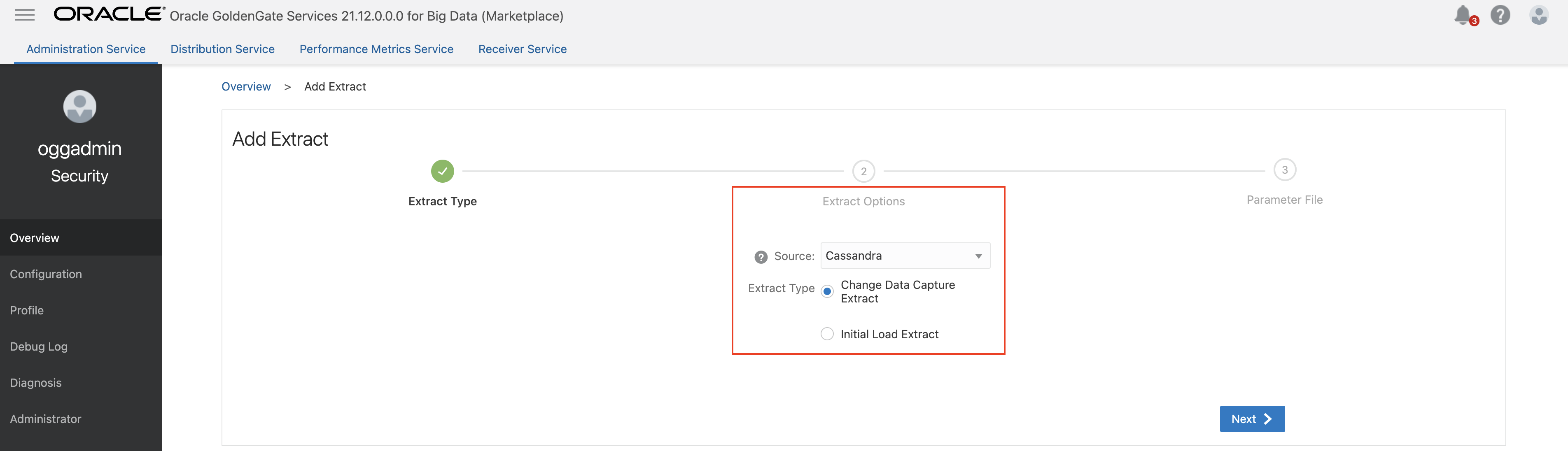

- In Extract Type, select Cassandra as Source and Change Data Capture Extract as Extract Type. Click Next.
- Provide the details in Extract Options. For Credential Domain and Connection Alias, select the domain and alias created in step 1. Click Next.

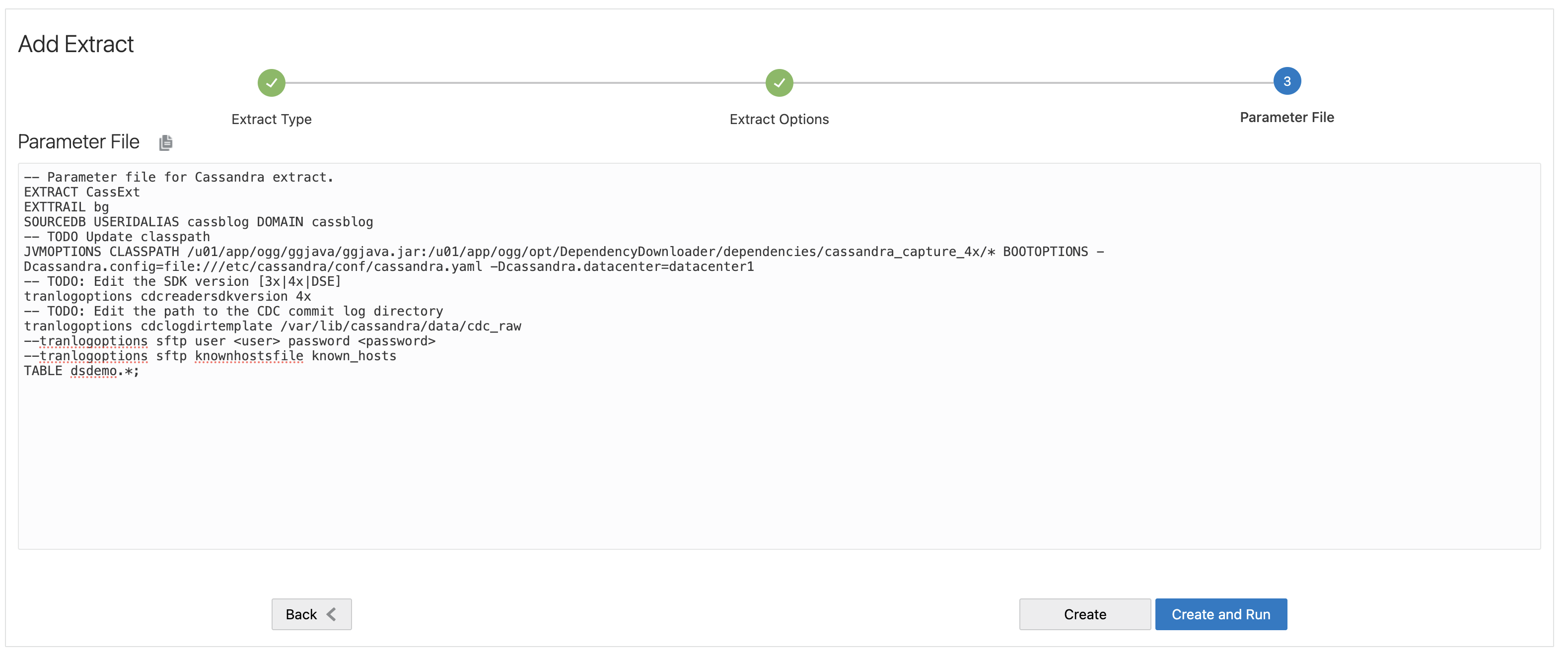

- Update the Parameter File with required parameters. Review the parameters marked as TODO.
- Update JVMOPTIONS CLASSPATH and BOOTOPTIONS:
In CLASSPATH, you should include ggjava.jar and dependencies downloaded in classpath. ggjava.jar is located at $GG_HOME/ggjava/ggjava.jar. You should also provide the full path to depdencies you downloaded earlier. In BOOTOPTIONS, you need to provide path to cassandra.yaml file in Dcassandra.config.
For example: JVMOPTIONS CLASSPATH /u01/app/ogg/ggjava/ggjava.jar:/u01/app/ogg/opt/DependencyDownloader/dependencies/cassandra_capture_4x/* BOOTOPTIONS -Dcassandra.config=file:///etc/cassandra/conf/cassandra.yaml -Dcassandra.datacenter=datacenter1 - Edit SDK Version:
Provide your source Cassandra version in tranlogoptions cdcreadersdkversion as 3x, 4x or DSE.
For example: tranlogoptions cdcreadersdkversion 4x - Edit path to the CDC Commitlog Directory:
Provide the path to Cassandra CDC commitlog directory (for example cdc_raw) in tranlogoptions cdclogdirtemplate. Please make sure that Cassandra commitlog directory is read open.
For example: tranlogoptions cdclogdirtemplate /var/lib/cassandra/data/cdc_raw
!!! If GoldenGate for Big Data and Cassandra runs in different nodes, GoldenGate for Big Data uses SFTP or NFS to access to Cassandra commitlog files. If that’s the case, provide path to known_hosts file in tranlogoptions sftp knownhostsfile. For example: tranlogoptions sftp knownhostsfile /home/opc/known_hosts. If SFTP is configured with user name and password, use tranlogoptions sftp user <user> password <password> to provide username and password. - Define from which Cassandra Keyspace and Table data will be extracted.
Update TABLE source.*; with source keyspace and table name. For example: TABLE dsdemo.*;

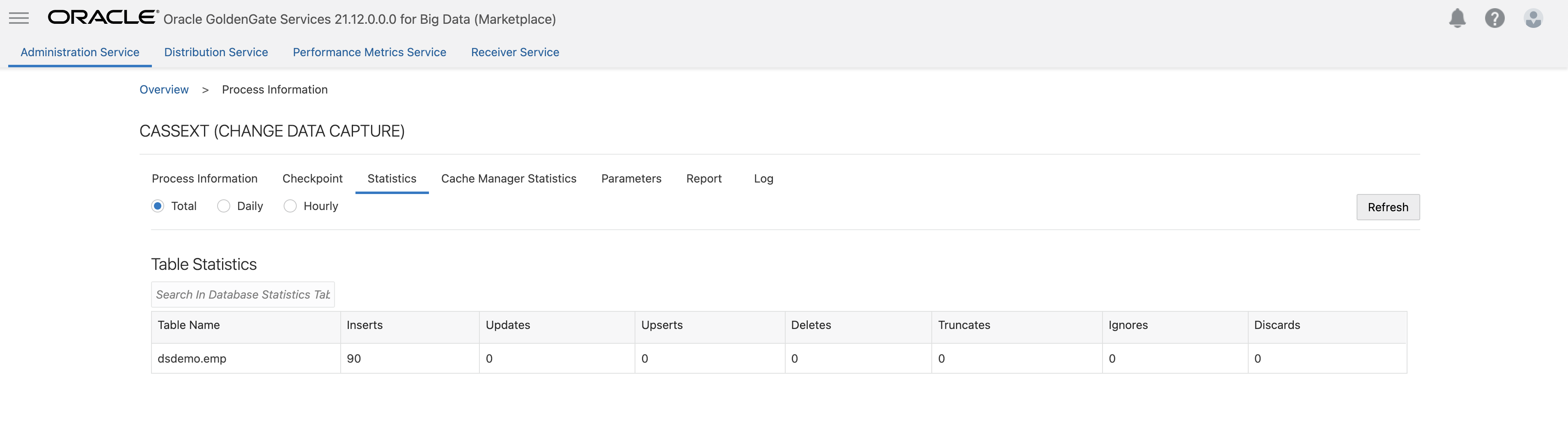

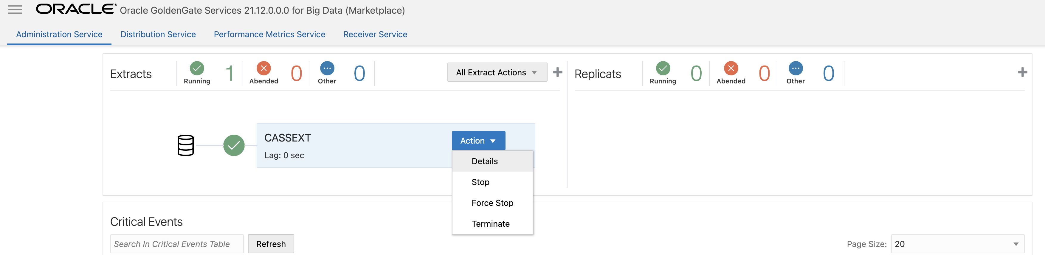

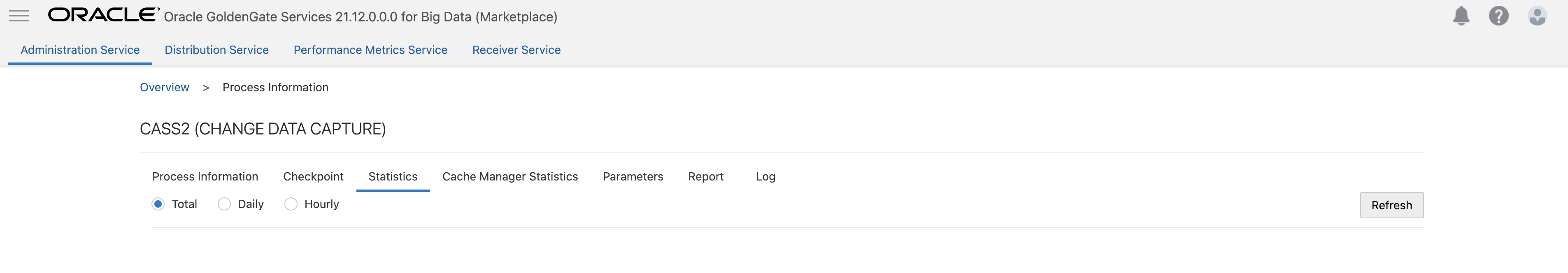

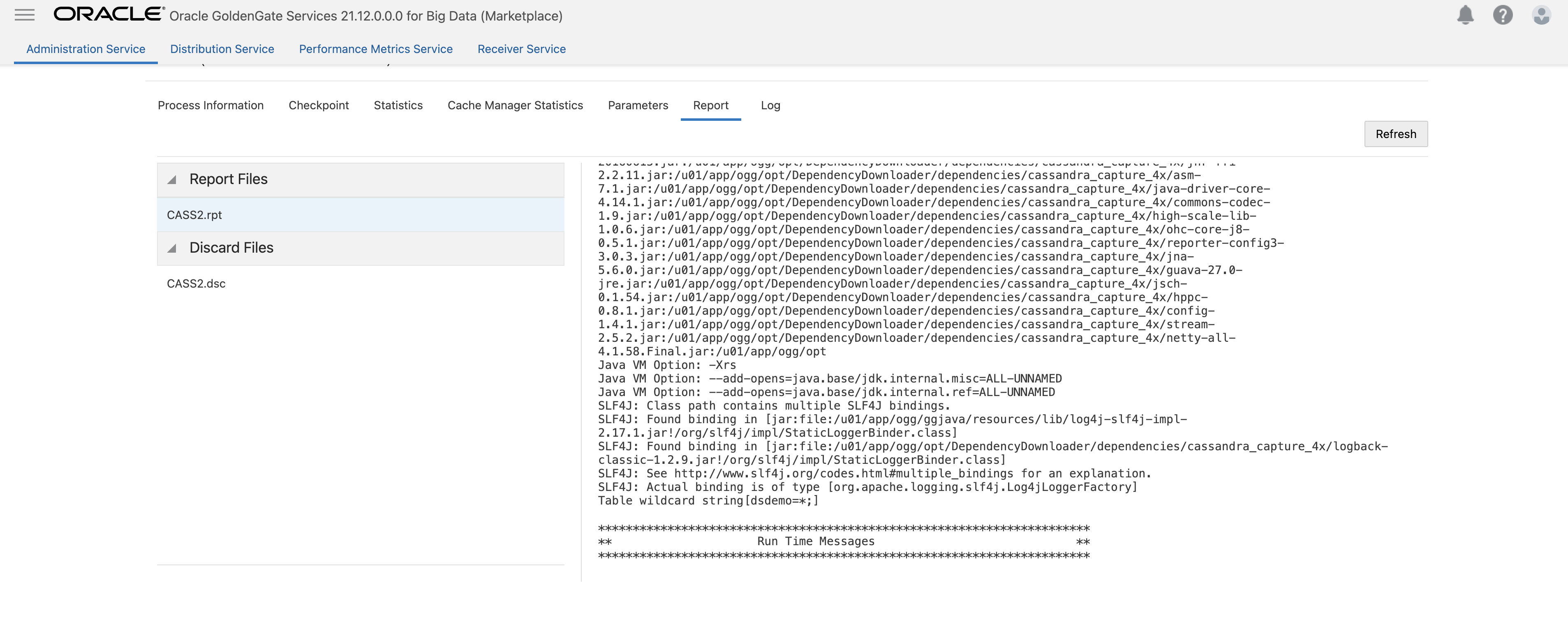

- Click Create and Run. If extract runs successfully, it will be checked with a green check. On the extract, click Action/ Details and click Statistics. If you don’t see any Table Statistics and no messages under Run Time Messages in Report file, it means that Cassandra has not flushed cdc commitlog files. You can restart Cassandra nodes to flush the commitlogs. This case is valid for testing Cassandra extract with few source operations. After Cassandra restart, you will need to restart the extract as well (it will abend as connection is lost during Cassandra restart). After Cassandra and Extract is restarted, check Statistics again. You should see the extract statistic populated.
