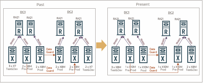

When the time came to refresh again, performance wasn’t the issue, but rising service costs and delays in getting replacement parts on the older systems were raising concerns. Through a nondisruptive migration to X10M, the team focused on resiliency uplift and maintenance simplification. They pursued footprint consolidation while preserving service consistency—delivering steadier uptime and easier operations on a smaller, stronger platform.
Some noticeable results:
  • Moved from four X8M racks to two X10M racks, cutting the footprint and reducing power, space and support overhead via a 2X consolidation
  • Increased resiliency with high redundancy enabled rolling updates that improved uptime and shortened/reduced maintenance windows
  • Minimum disruption thanks to using Oracle Data Guard for the migration to X10M
  • Achieved three times faster backups by adopting an incremental forever strategy on the Recovery Appliance, ensuring a daily virtual full backup is always available for restoration
  • All database backups can be spread throughout the day, with minimal impact to database operations
